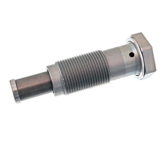

  15. I have also bought a new chain tensioner - and just wanna know if you just unscrewed the old one and then torque'de the new one to 60 nm, without locking the camshaft with the "camshaft locking tool" ? If it is safe to do the operation without locking the cam, that would be the easiest

  21. Hi GamesGoblin Thanks for the update - I'm very pleased that changing the tensioner have a positive effect on the rattle! I will also try to change the tensioner in my car with the F version. Did you lock the camshafts with locking tool, before the replace, or did you just loosen the old one and replaced it, without any prep. ? I think it should be possible to do it, without locking the camshafts - wich I would much prefer, as it is a lot easier then, BR Mikkel
  22. Hi GamesGoblin Im very coriuous about Your experience with changing the chain tensioner - did it do any improvement on rattling on coldstarts, or is is to early to say ? BR Mikkel
  23. Hi No worries - I reallly aapreciate Your input anf find it really helpfull if You will update in a couple of weeks or so, if it really has helped. Cheers
  24. Hi, I wondered - have You installed the tensioner ? Any better on the startup sound ? Best Regards Mikkel
  25. Hi Games Goblin, You still havent changed the tensioner ? BR Mikkel
