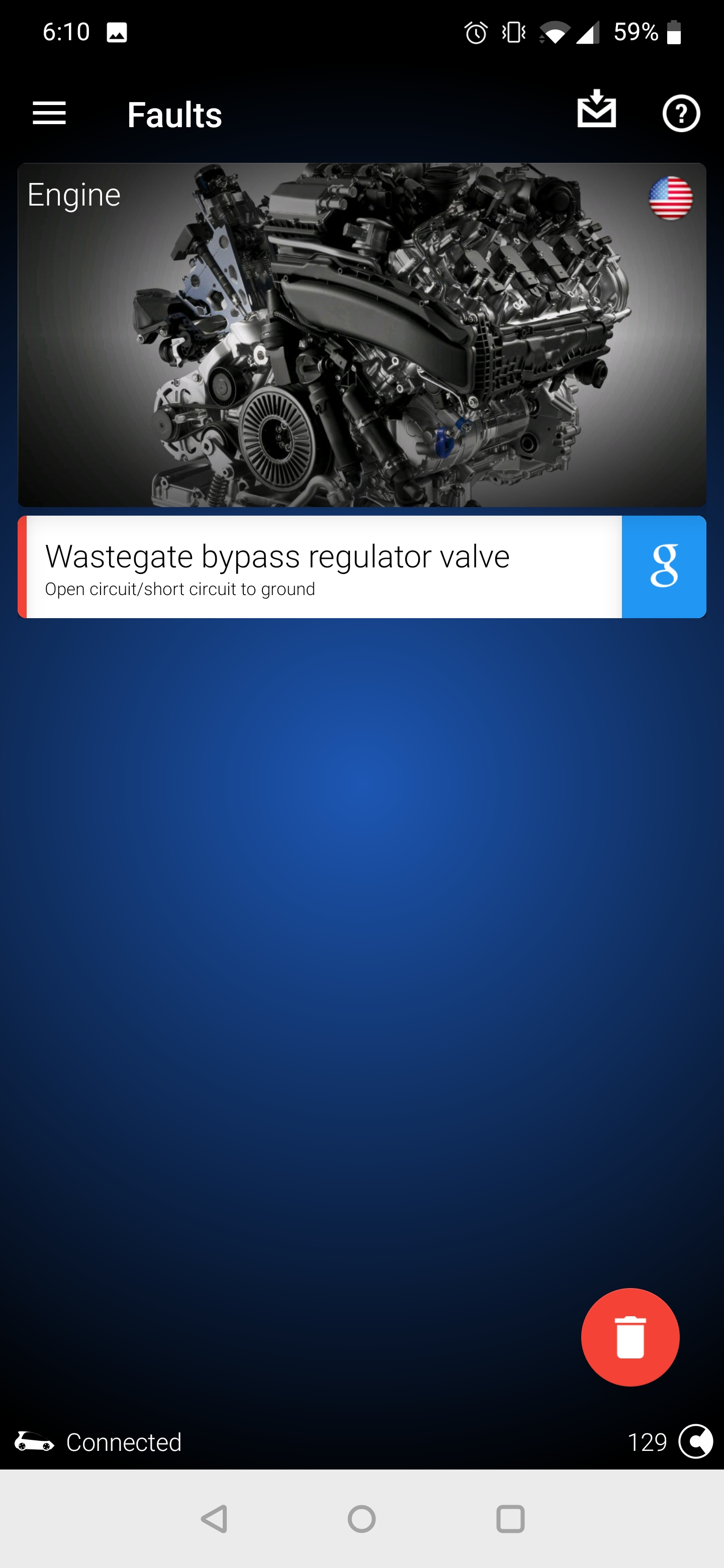

  4. Hi i am still trying to sort this fault out, car wouldn't start today and have since replaced the vacuum solenoid cont unit, once replaced it fired up straight away, been for a 20-30min test drive and all seemed ok, however light has come back on and now getting a wiring fault Has anyone got an engine wiring wiring diagram for an 05 fabia vrs please? Thanks Adrian

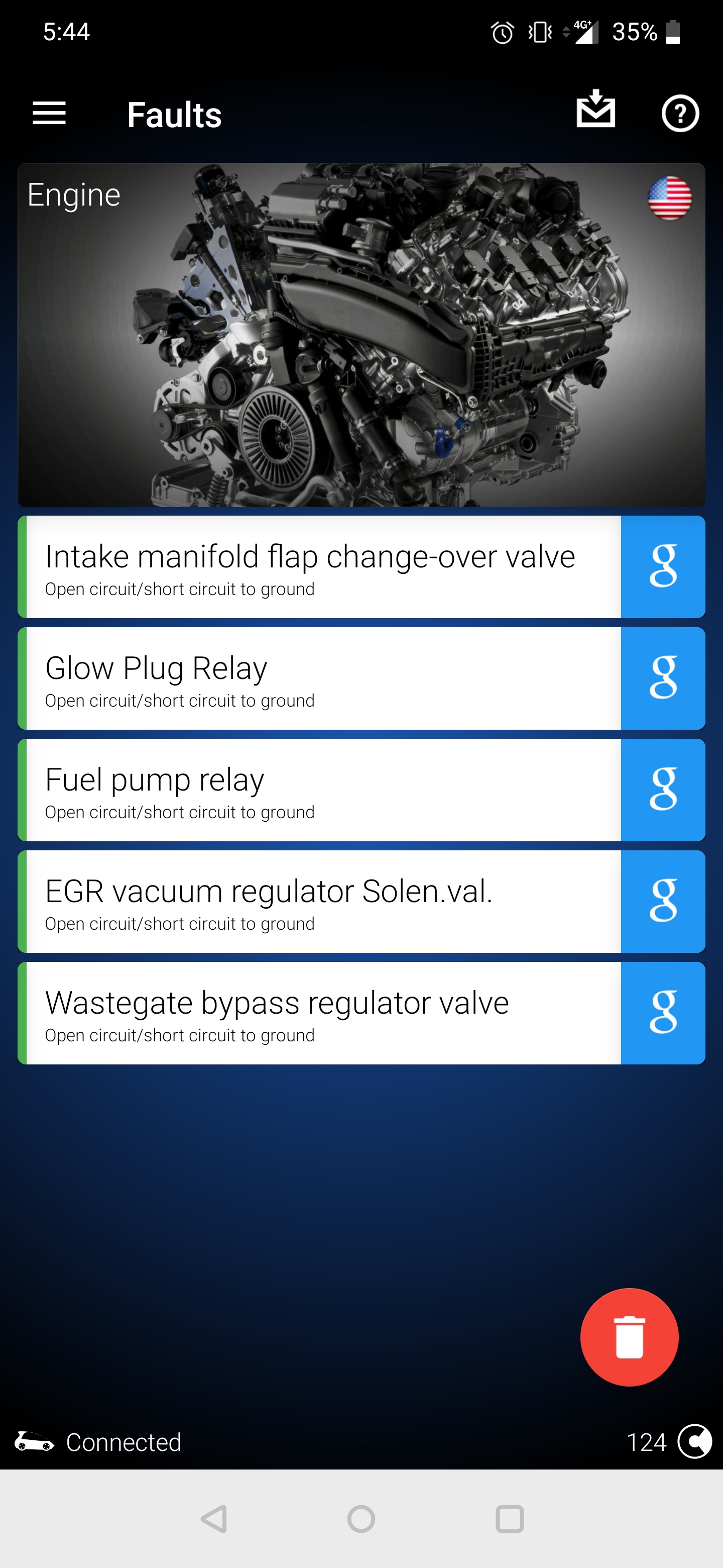

  6. Hi all, ive just bought a fabia vrs 05 plate. Ive not even driven it properly as its not insurance hasnt started till sunday, ive driven it down my road and back maybe 100 meters and eml came on and it cuts out when its idling. It chugs a bit and cuts out. Ive scanned to see what fault codes it has logged. Wondered if anyone else has had anything similar? The faults will clear and light goes off but will come back. Tia Adrian
