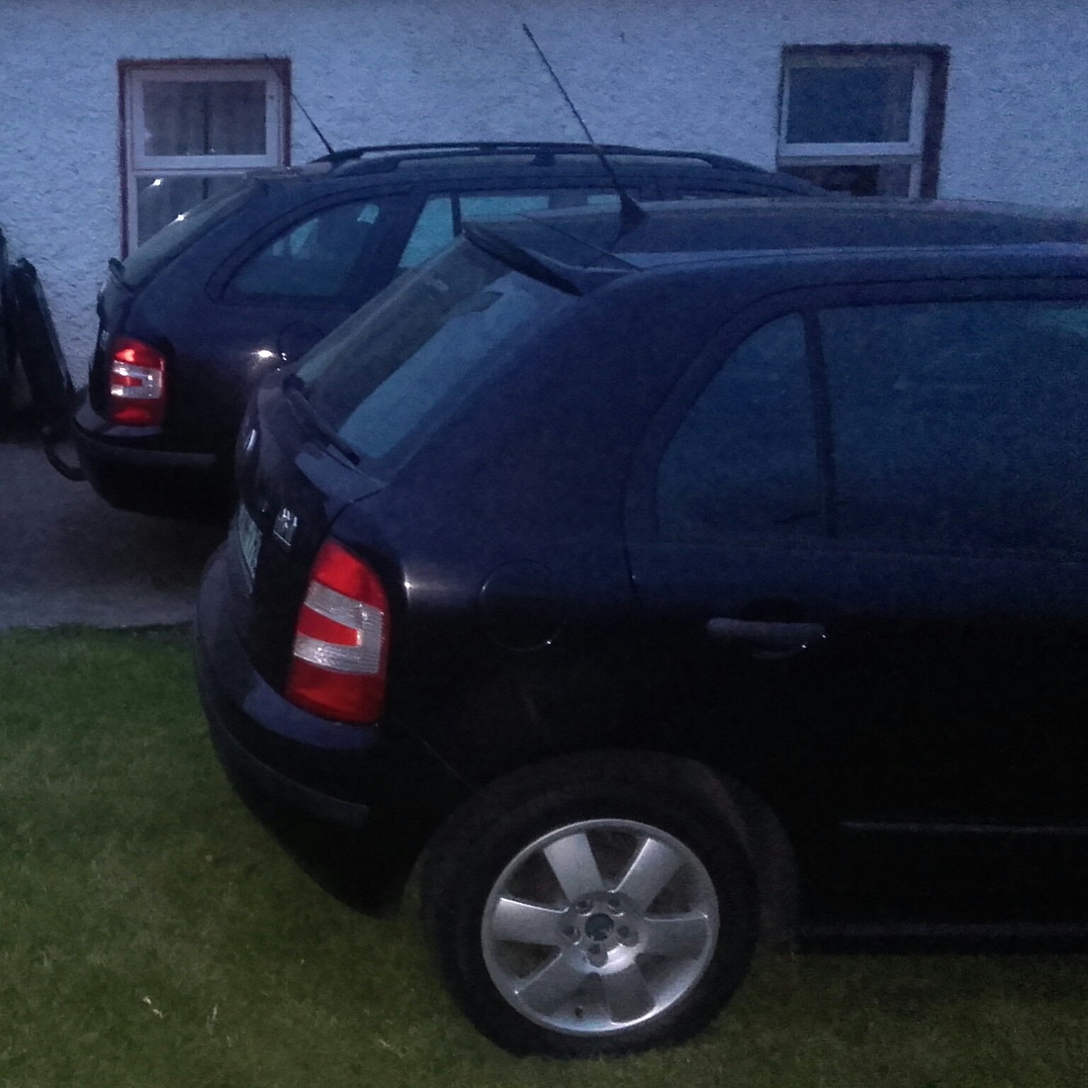

A brush cutter thus angled in the combi you can close the boot lid. In the hatchback it protrudes over the bumper. -

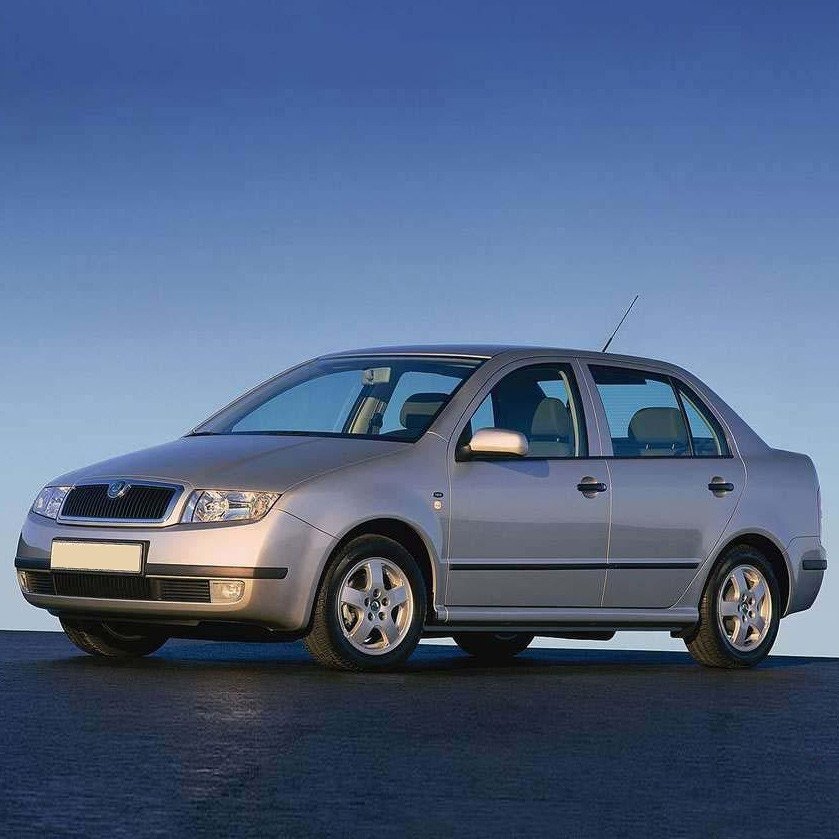

There were 3 models. A bit like the 3 bears. Hatch - baby bear Saloon - mammy bear Combi - daddy bear -

Couple of pointers:: You can get 8 full bags of coal and 4 bales of BNM briquettes in a combi boot with the seats down. A washing machine fits with the back seat in place. It's 5 to 6 inches longer than a hatchback boot. A child's push chair and a week's food shopping for a family of 4 fit nicely in the boot of the combi - not so the hatchback. The saloon is the same length as the estate but you obviously miss out on the extra hight at the hatch. In my experience, the combi is much more practical than the hatch and better looking shape "to boot" ..... If you don't mind the pun. -
