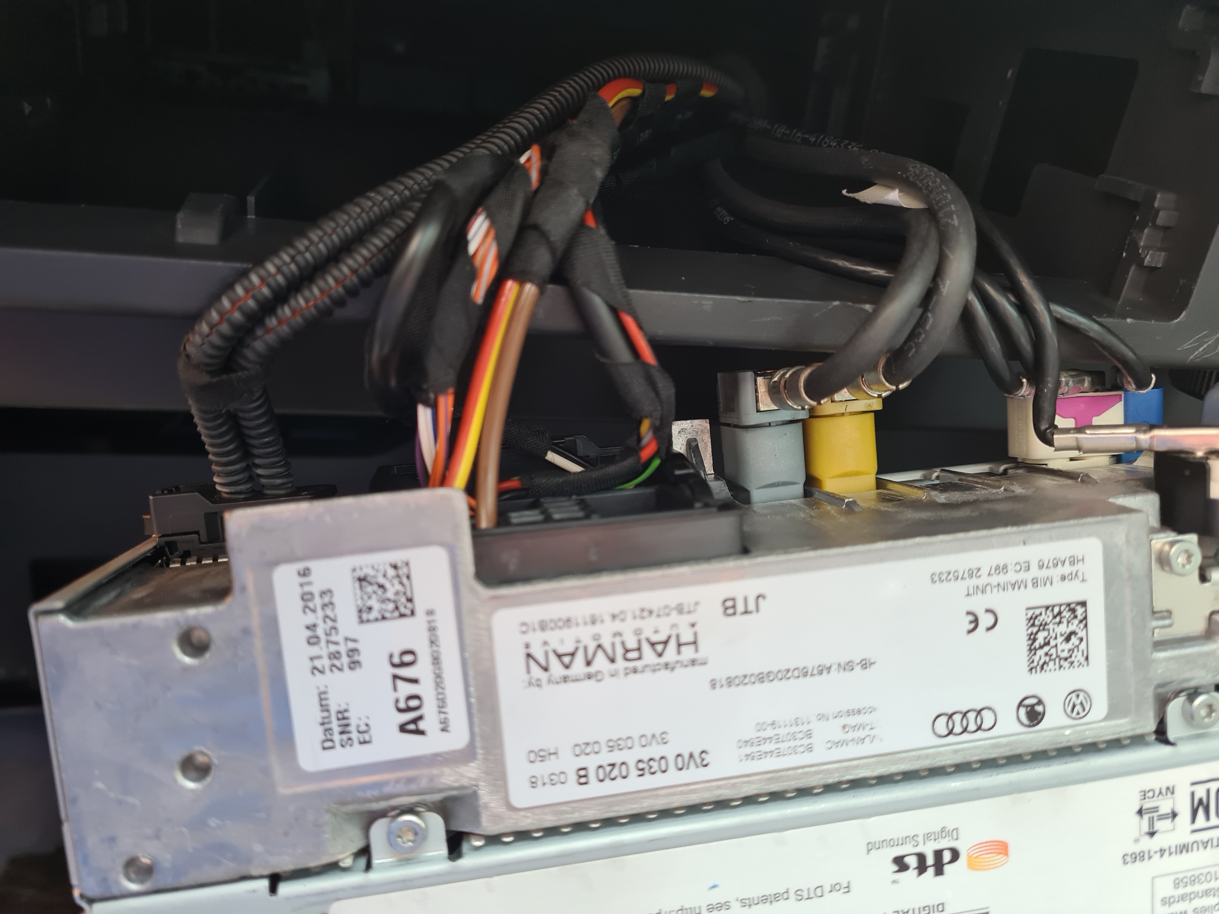

  6. Yeah its going in on Friday morning for them to have a look. As you can see below all cables look connected. Things are also connected at the cigarette socket end as well
  7. My Car is 2016 l&k 4x4 dsg estate , Just the single usb below the climate control unfortunately Do you mean on the back of the media unit in the glove box, Or have I named it incorrectly lol. I removed the unit in the glove box and I didn't see any lose connectors . Has any one got a pic of the fore mentioned connector attached to the media unit?
