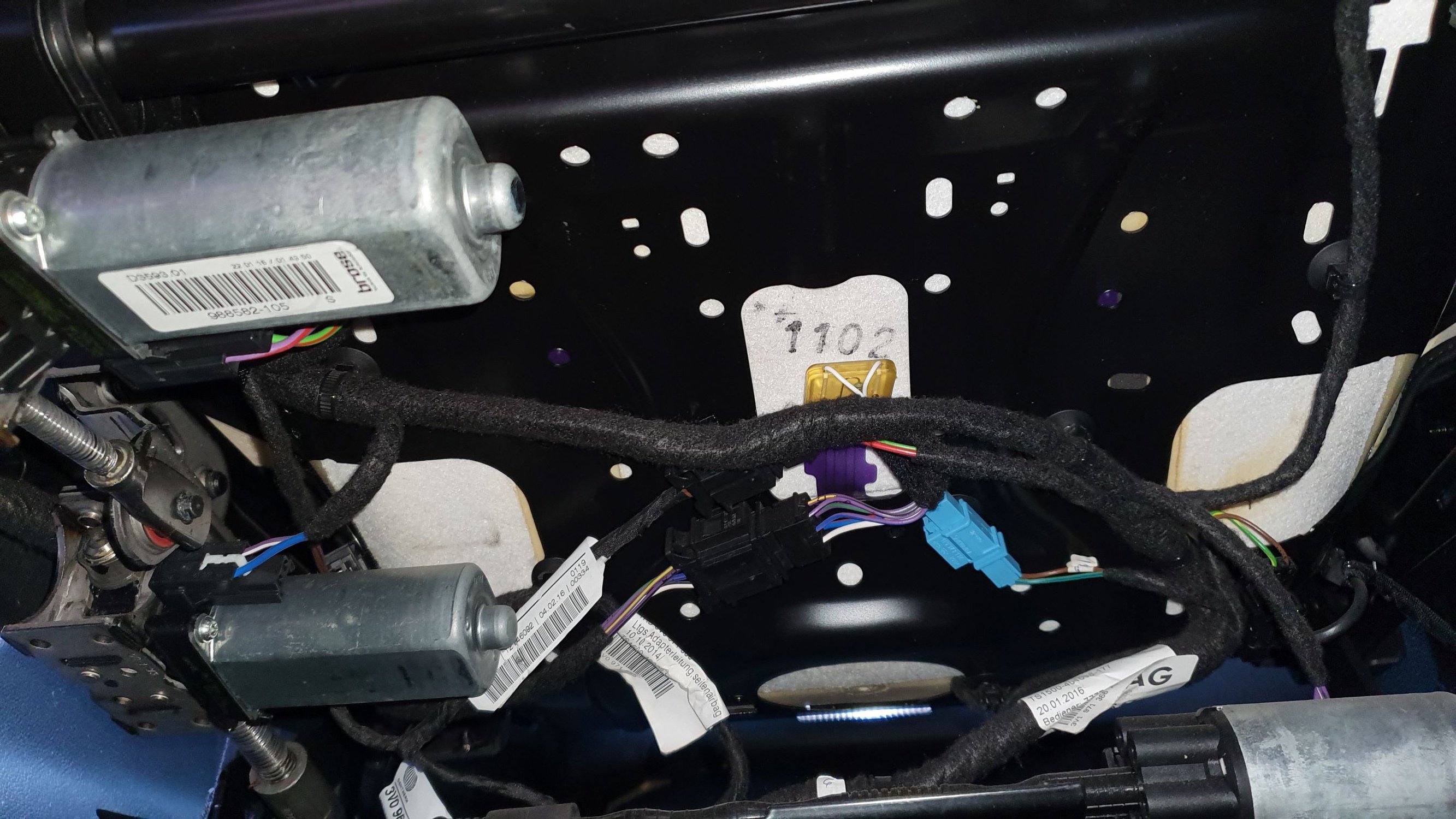

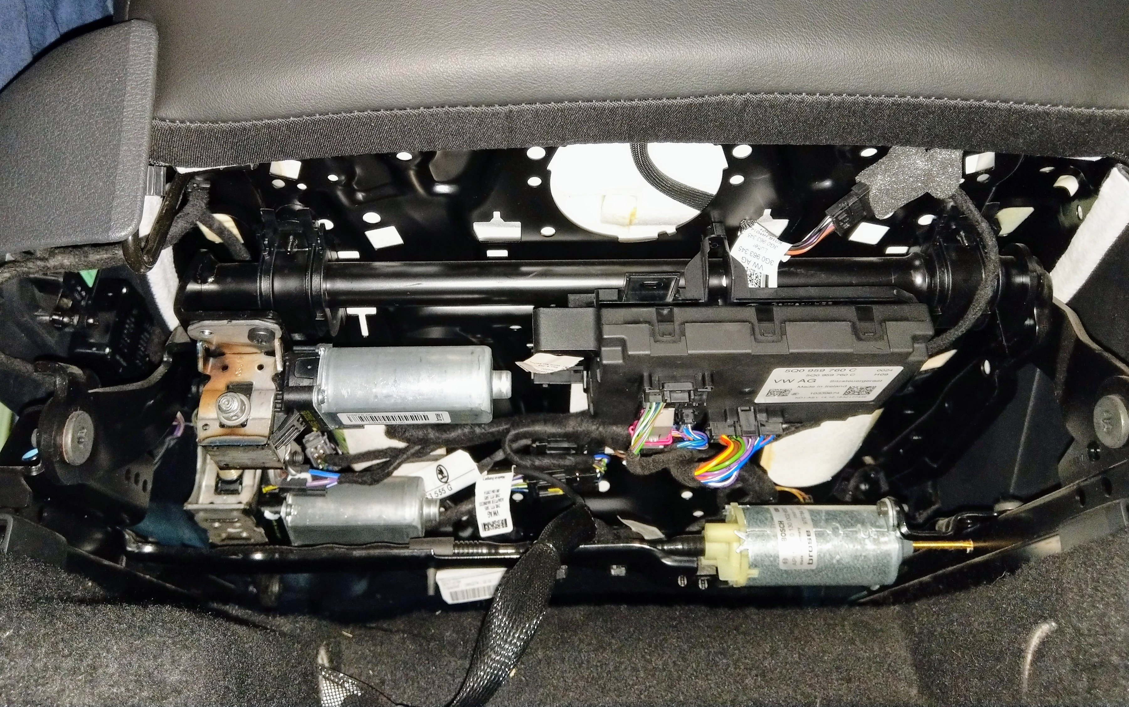

Can You share please some pictures under Right seat?
i'm thinking about install memory for Right(passenger) seat,
crossing fingers there required only controller module 5Q0 959 760 C and buttons ??? ??? ???
part number of one of actuators is D3593.01 988582-105 S
under the Right(passenger) seat without memory:

On 16/01/2020 at 19:45, MartiniB said:
@JR RS
This is mine. I've got the leather seats in mine.
Passenger's side:-
Driver's side:-
THANKS!
mine is leather too :)
+ ventilated
can you try catch the actuator part number, can't read when zoomed
