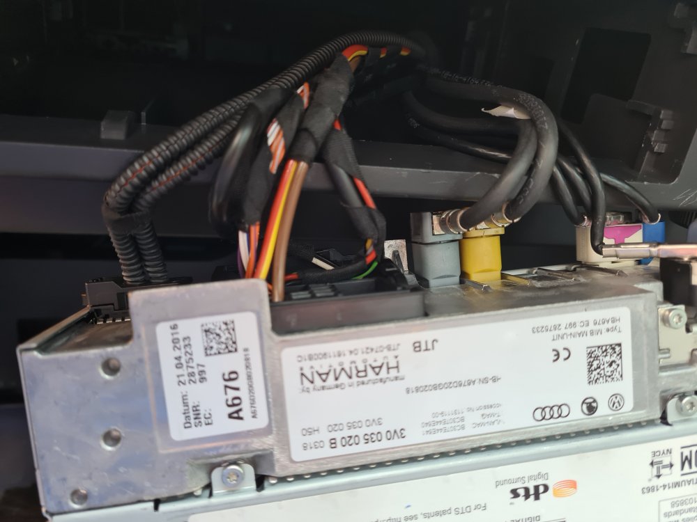

  4. Just an update on this, Skoda dealers couldn't find any issues. So I replaced the usb socket and all is working 100% again

  6. Yeah its going in on Friday morning for them to have a look. As you can see below all cables look connected. Things are also connected at the cigarette socket end as well
  7. My Car is 2016 l&k 4x4 dsg estate , Just the single usb below the climate control unfortunately Do you mean on the back of the media unit in the glove box, Or have I named it incorrectly lol. I removed the unit in the glove box and I didn't see any lose connectors . Has any one got a pic of the fore mentioned connector attached to the media unit?
  8. The strange thing is the socket will still charge my phone but it wont register a usb memory stick or android auto
  9. Hello folks I had a westfallia tow bar installed today and since then my android auto isn't working. I have popped out the media and cigarette units and all connections are ok. Here is the code in question Skoda Superb mkiii estate Monday,11,October,2021,17:32:26:15466 VCDS Version: Release 21.9.0 (x64) Running on Windows 10 x64 www.Ross-Tech.com Address 5F: Information Electr. Labels: 3V0-035-MIB-HGH2.clb Control Module Part Number: 3V0 035 020 B HW: 3V0 035 020 Component and/or Version: MU-H-ND-EU H50 0318 Software Coding: 038402010000000011111202008808002F0003E601208100DE Work Shop Code: WSC 73430 790 00063 ASAM Dataset: EV_MUHig4CGen2HBAS 001001 (SK48) ROD: EV_MUHig4CGen2HBAS_AU37.rod VCID: 2545C97424DD6CA112-8070 1 Fault Found: 1637 - Interface for External Media U11B8 00 [009] - No Communications [New feature! Extended UDS fault detail is only supported by current gen. interfaces] Confirmed - Tested Since Memory Clear Freeze Frame: Fault Status: 00000001 Fault Priority: 4 Fault Frequency: 1 Reset counter: 70 Mileage: 61230 km Date: 2021.10.11 Time: 17:31:31 Voltage terminal 30: 12.2 V Interface for external media: status-Status: Open circuit
