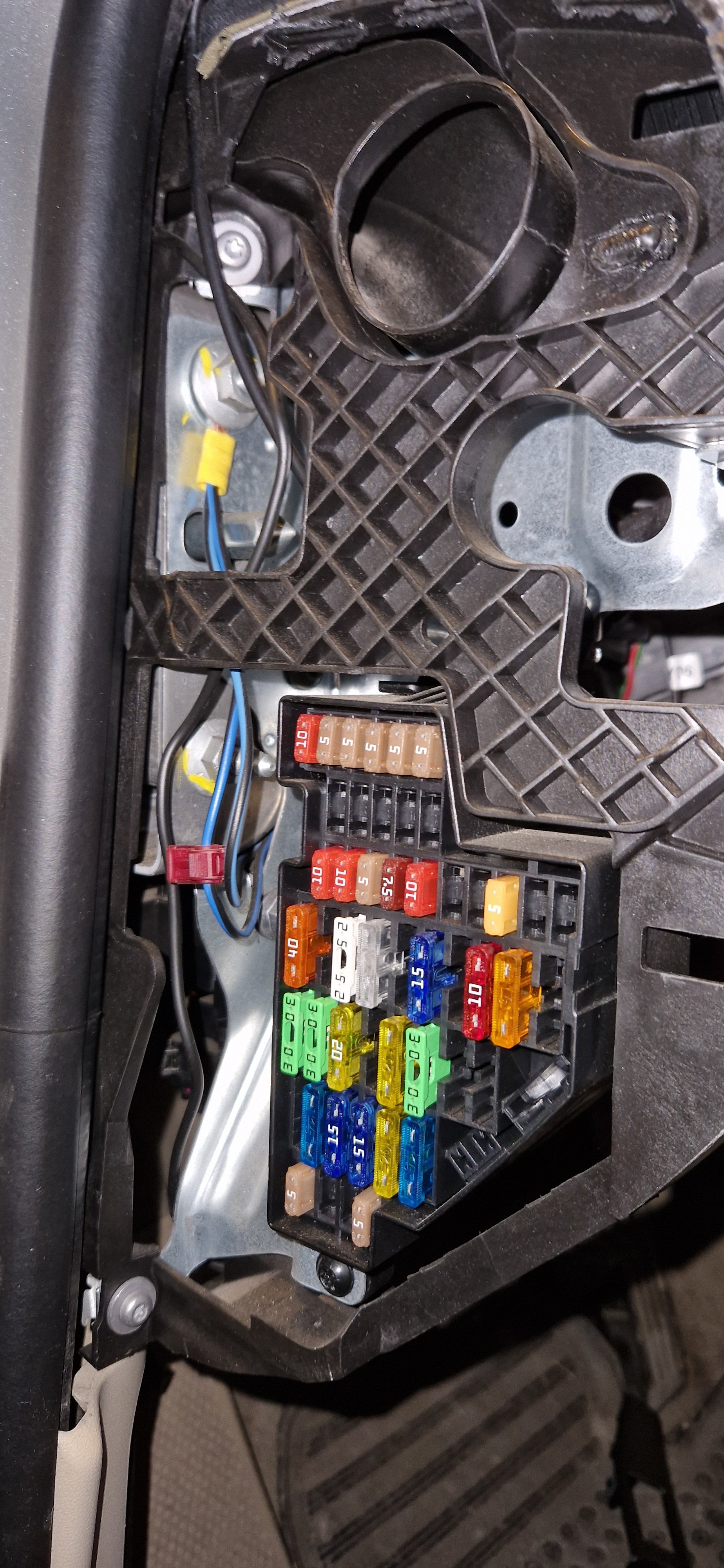

Hello! I've been having issues with parasitic draw since I bought the car. I measured the voltage drop over the fuses and found that the radio and the fuse for the wiper/indicator stalk was using power when car was off. The indicator stalk was very erratic in its draw, often 0 but then it would go pretty high, then 0 again. The radio was drawing ~800-900mA. Is there a normal fault with the radio units to draw power when sleeping?

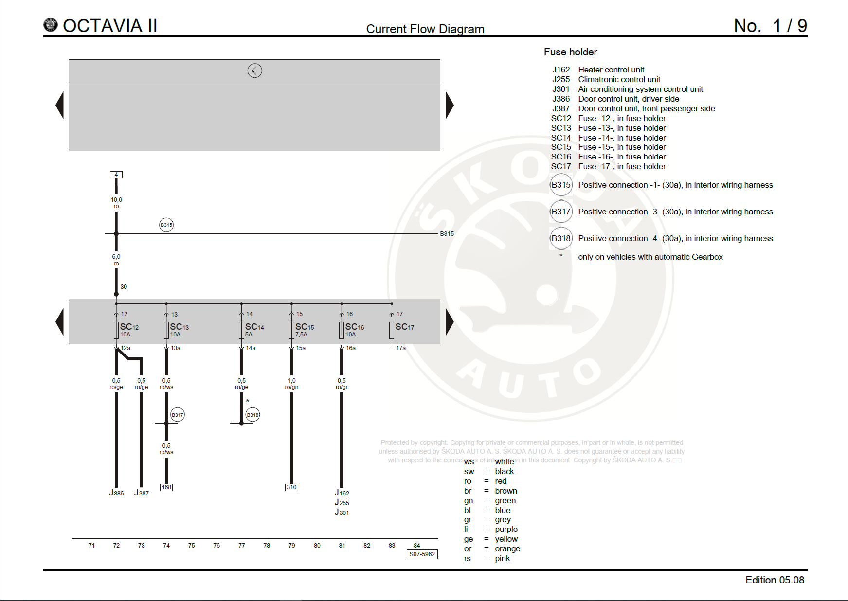

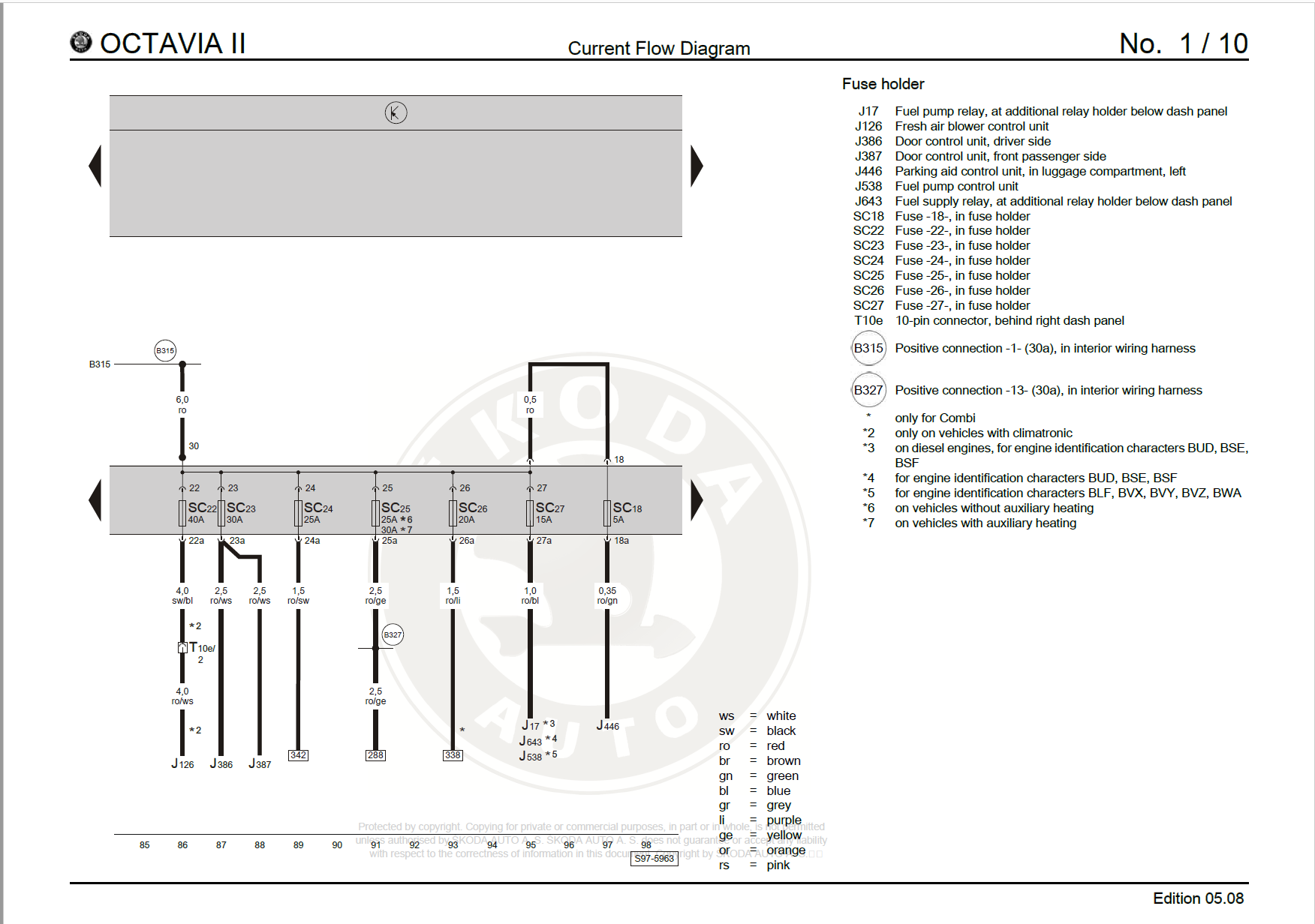

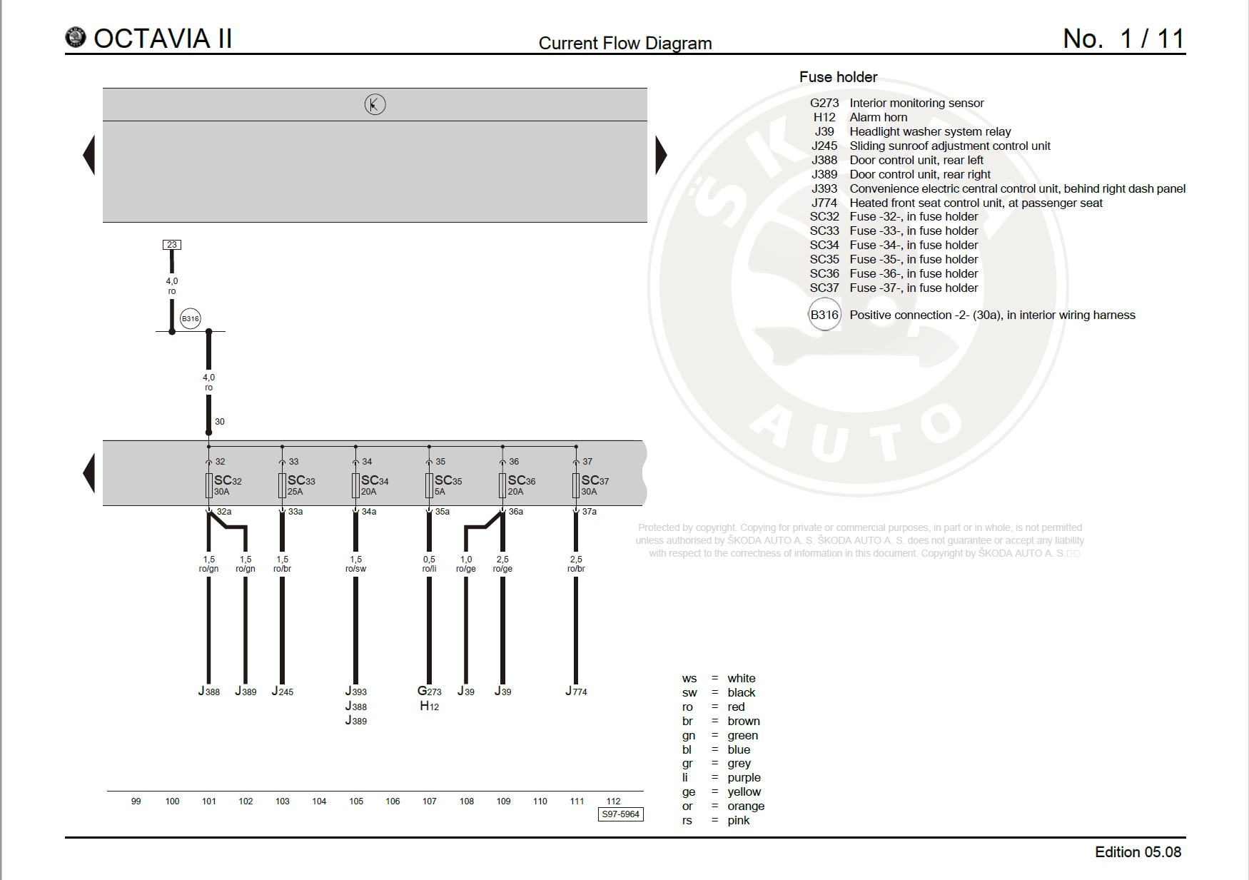

Good News everyone! The driver door and the rear left door is now working. And I found wiring diagram for the whole vehicle for free. I can post that as a PDF if you want. Well, I looked at the diagram and saw that FUSE 23 powers the left and right door control module. I look in the fusebox and what do I see? Theres no Fuse! I dont know If I have pulled this before while I was searching for the fault, but I cant remember if I did. All I can remember is I was focusing on fuse Nr12. Oh well, so I plug in a new fuse and try it out. It works! Dont know if its because I pulled the alarm cables or something else. I took the whole door cover off on the inside, took the cables out that connects through the chassis to the door, inspected them but didnt see any damage. Or, the alarm was installed in such a way that it supplied power to the doors. Oh well, Im happy that I now have everything working on the left side. Right side is still completely dead, and front doors share fuses with each other, same with the rear doors. So Its not a fuse problem at least. Now its time to check if the cables are okay inbetween the chassis and the doors on the right side. But first Ill swap my battery for a better one. Ill cross my fingers the same thing doesnt happen again 😛 Also, The OBDEleven was able to re-add all the door modules. Now I can contact front driver module, and rear left door module. The 4000 pages of wiring diagrams is 40MB Big. Is there any moderator I can send it to? So it can be stickied?

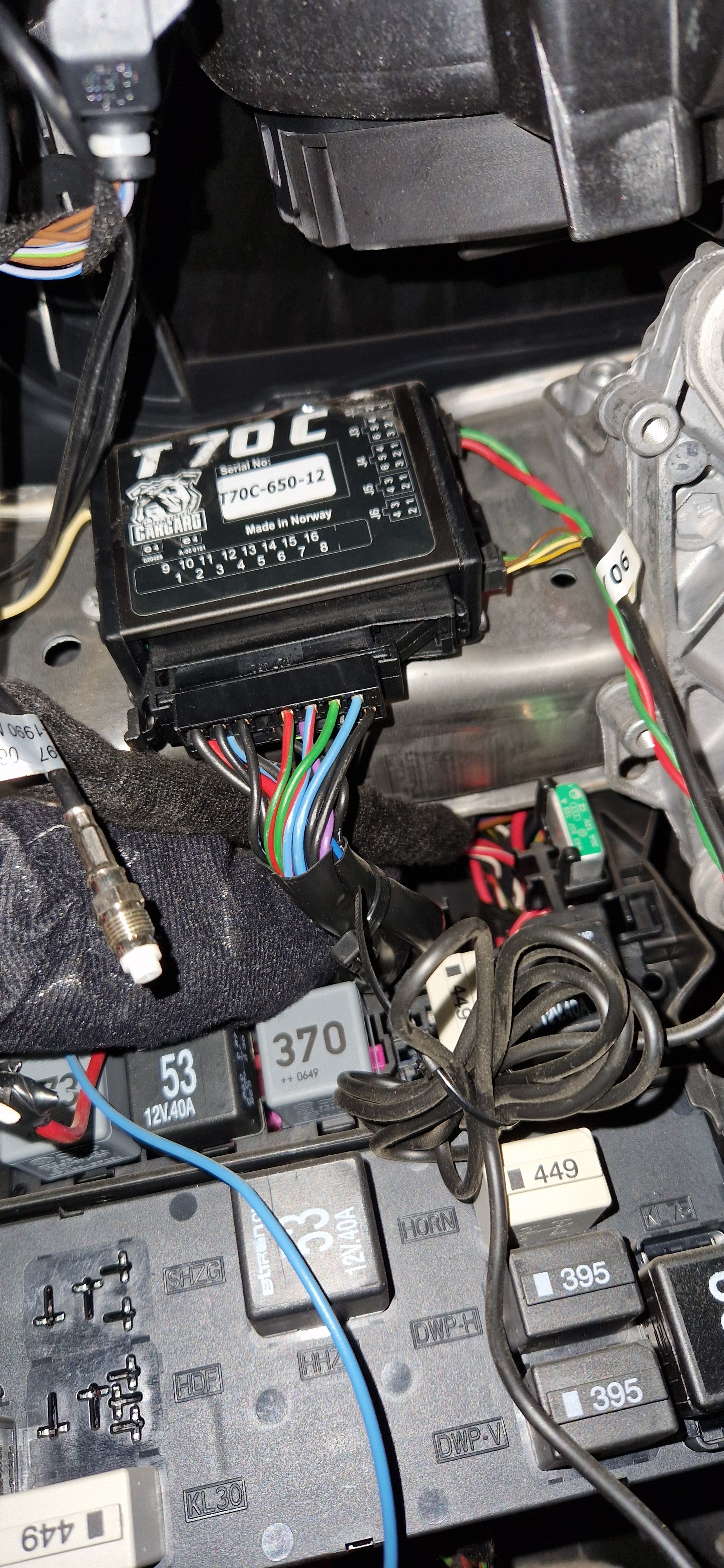

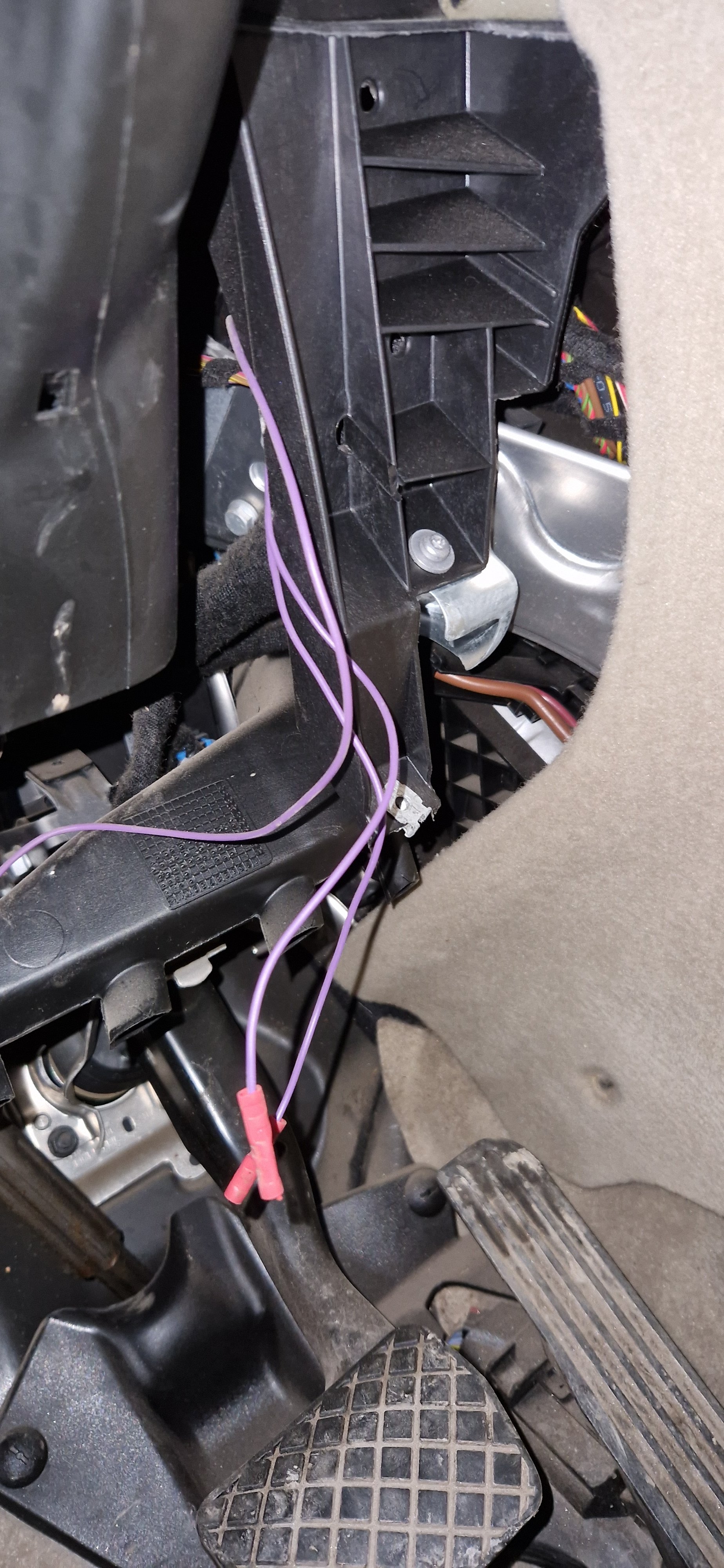

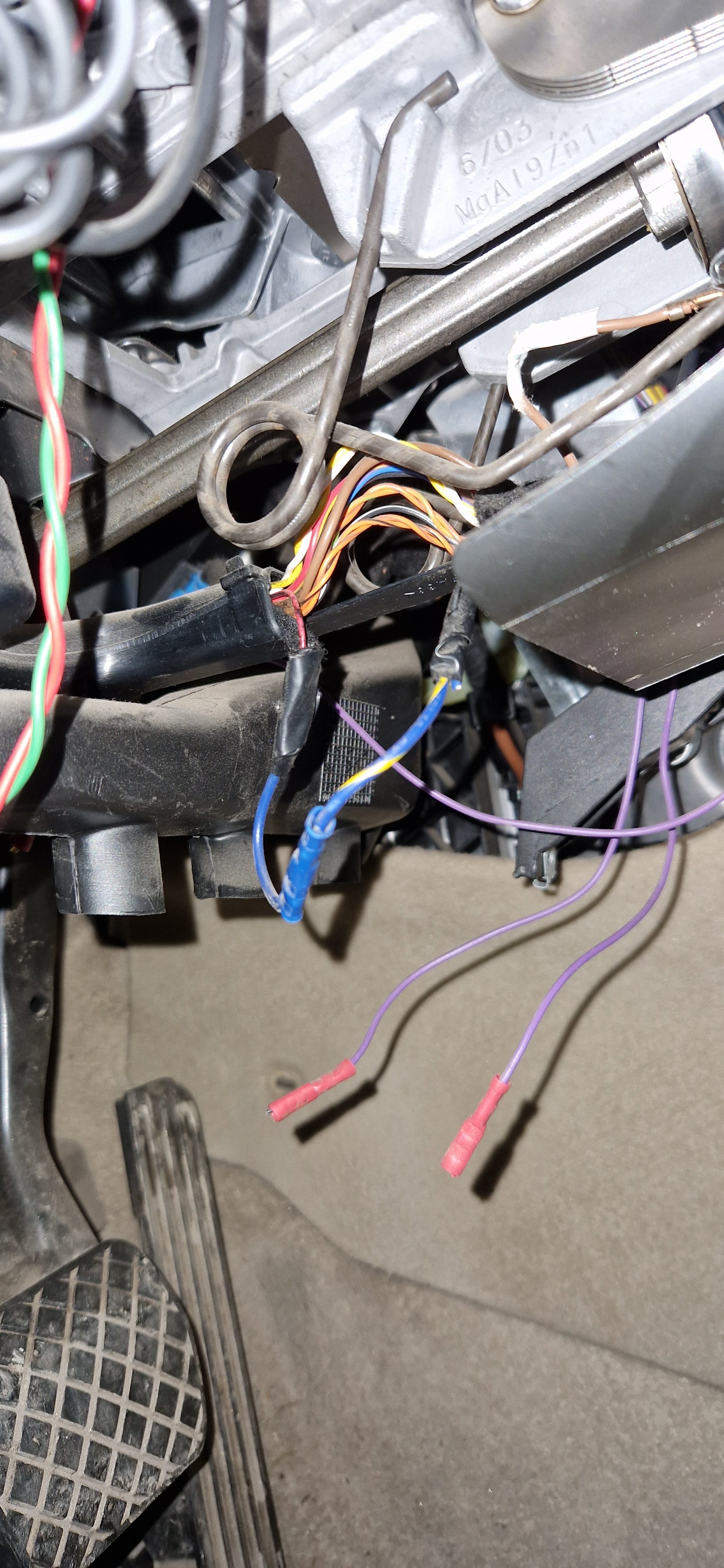

To their defense, they did at least solder all cables. But they've cut wrong cables and had to fix it multiple times. I knew there was something dodgy with this alarm 😅 Buuuut, I don't know if it affects what I'm trying to solve. I've removed the cables from what I think are the can high and low. No difference. It feels like it's a hidden fuse or something I can't find. I'll see if I can find the wire schematics and try to see if I get power to the module.
