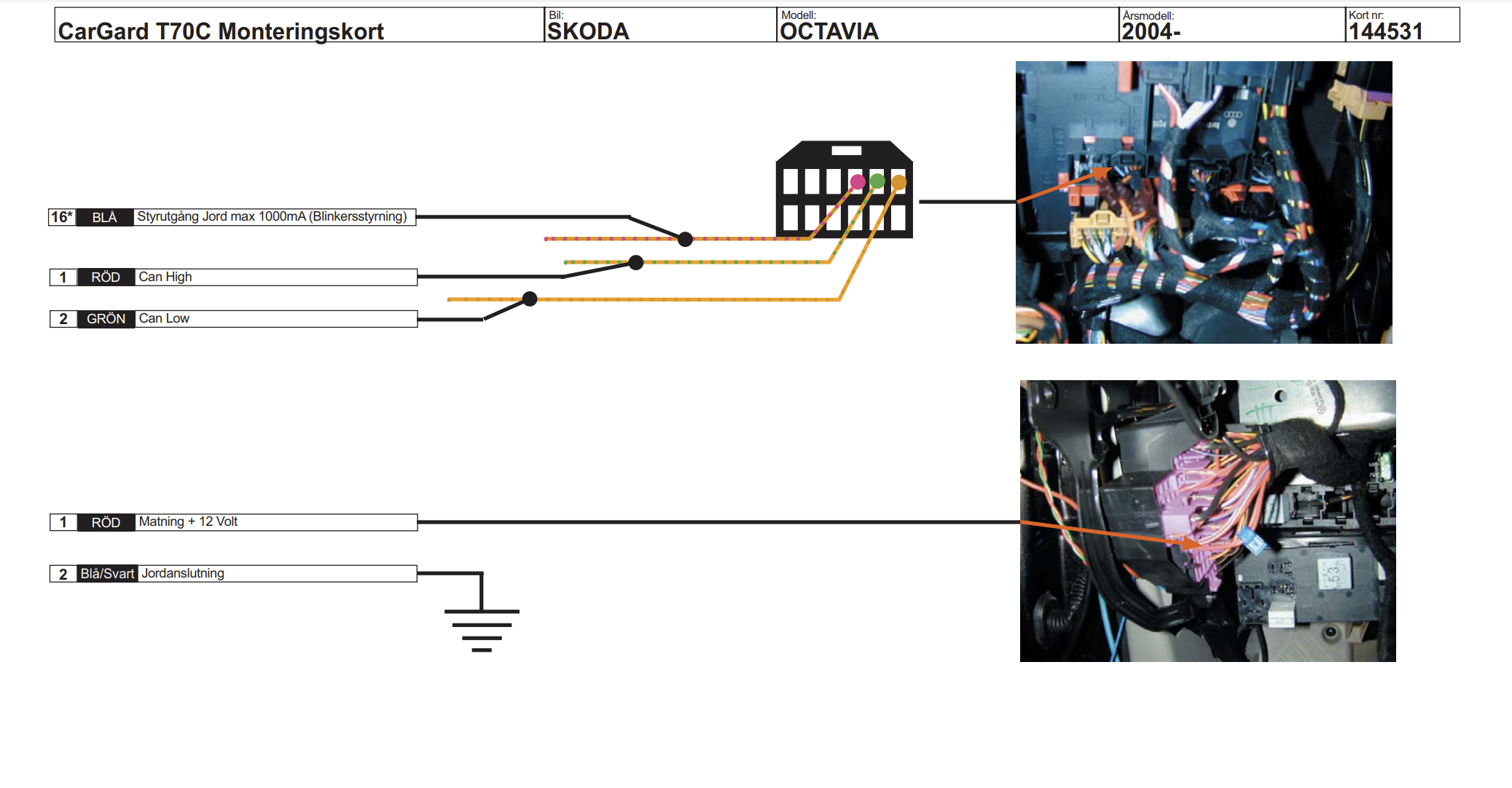

I just thought of something, I also have a 3rd party car alarm installed by some previous owner. I have always hated it, and maybe it makes my problem worse now. Because its connected to central locking etc etc. Edit: Nice, its spliced in on the can-bus 😑

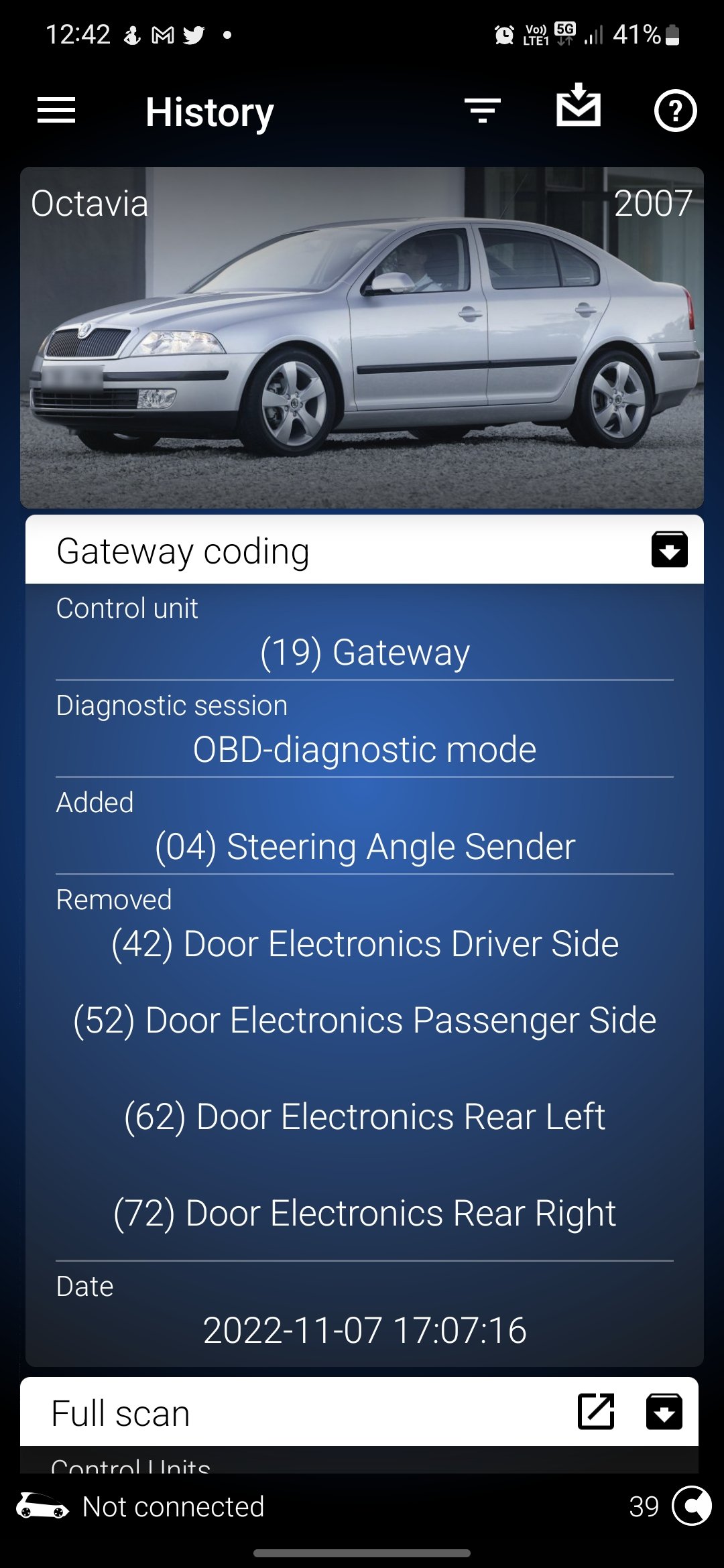

I have the option to add them back. But when I do they're just blacked out because theres no connection to it. And the symptoms was there before I checked it with OBDEleven. It will ask if I want to auto-code the gateway list and it hasnt failed before. I guess it disabled theese modules because there was no connection to them. I tried enabling them again but they stay unresponsive.

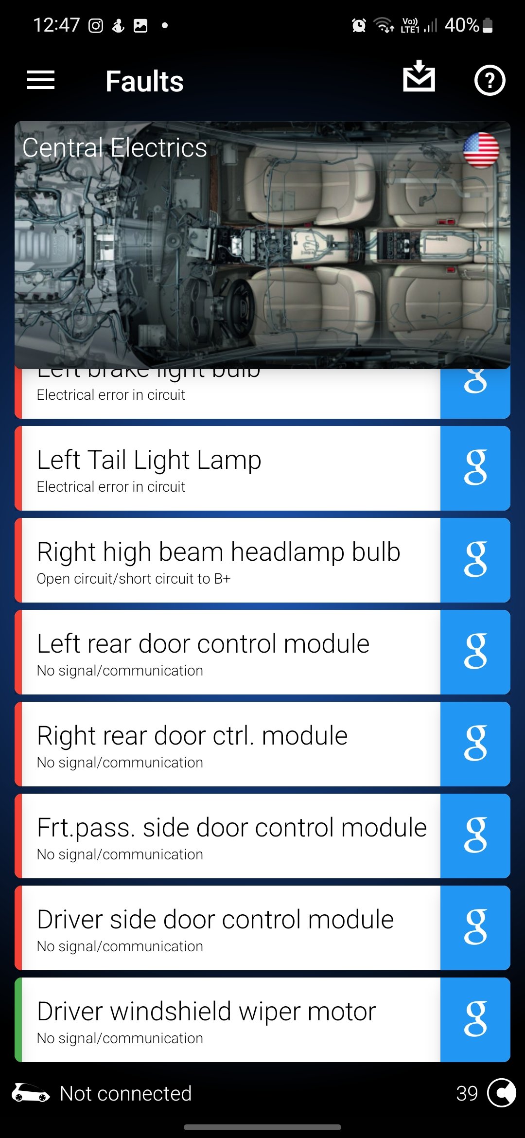

Hello! I have a weird problem. Since yesterday (when i changed battery) I cant lock my car, cant open the boot, cant use any electric windows etc etc. I scanned the car using OBDEleven and it says that it has no connection to either the driver side door control modul nor the passenger side. What could have caused this? I checked the fuse for the central locking system but that wasnt shot. Is there any other fuses I could check? Did I do something withe the cabling while reinstalling the battery? Many thanks! I tried using a "dead" battery in between the battery swap. I didnt know it was dead then, but it quickly showed when turning the starter key. Haha. Could this have "destroyed" the control modules?

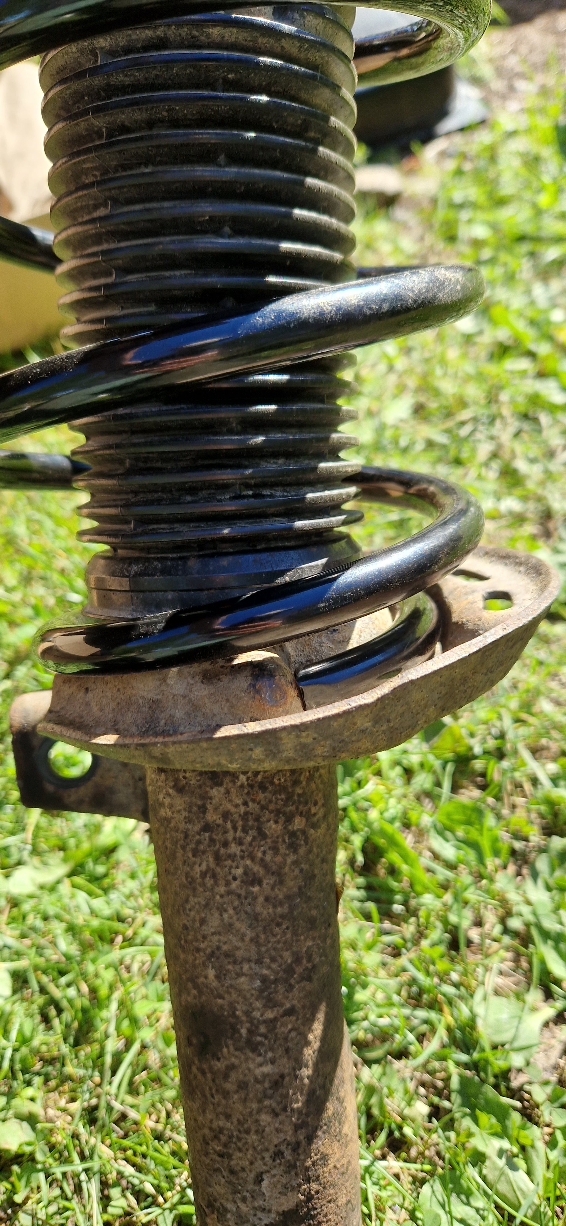

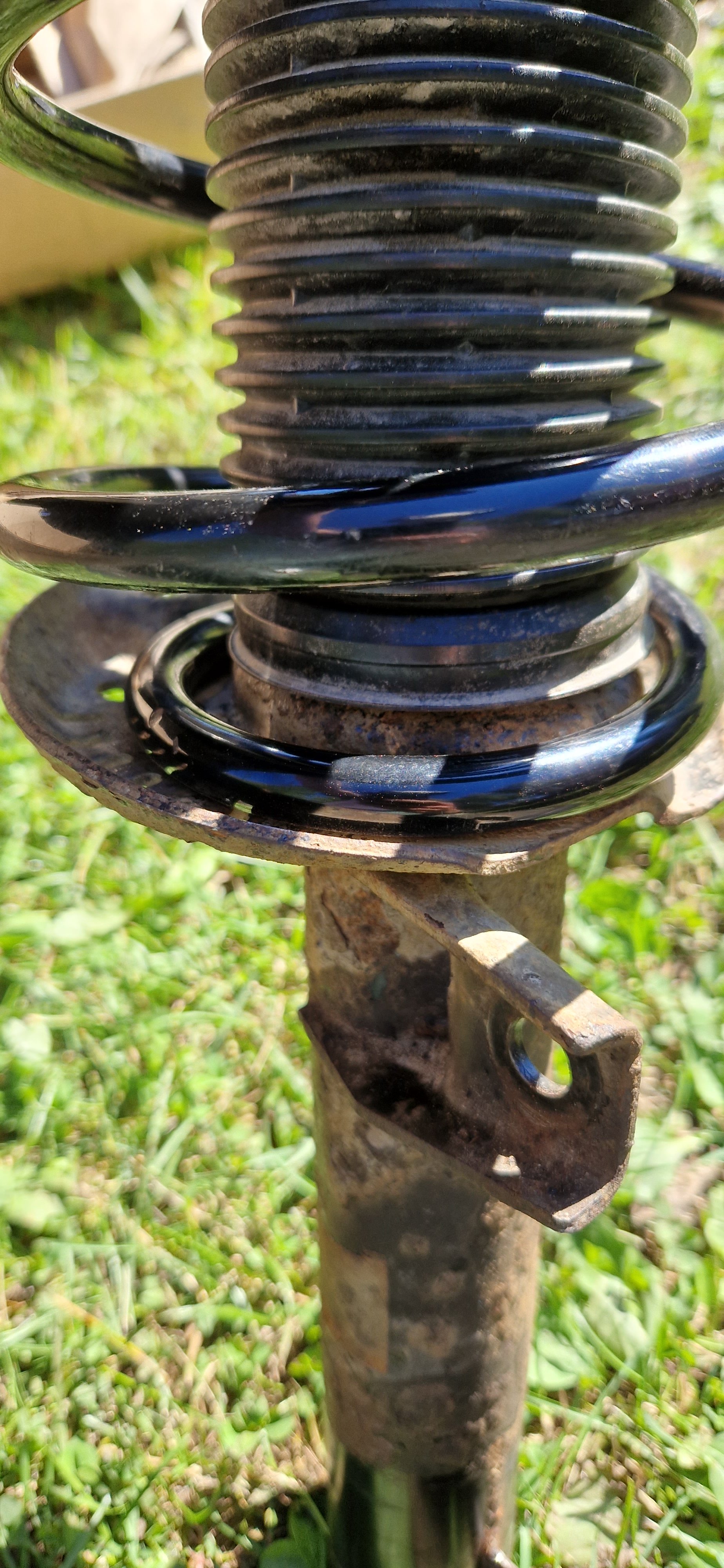

Thanks for the response. I think this looks very strange. Do I have the wrong coils? I never thought about this when I did the other side.

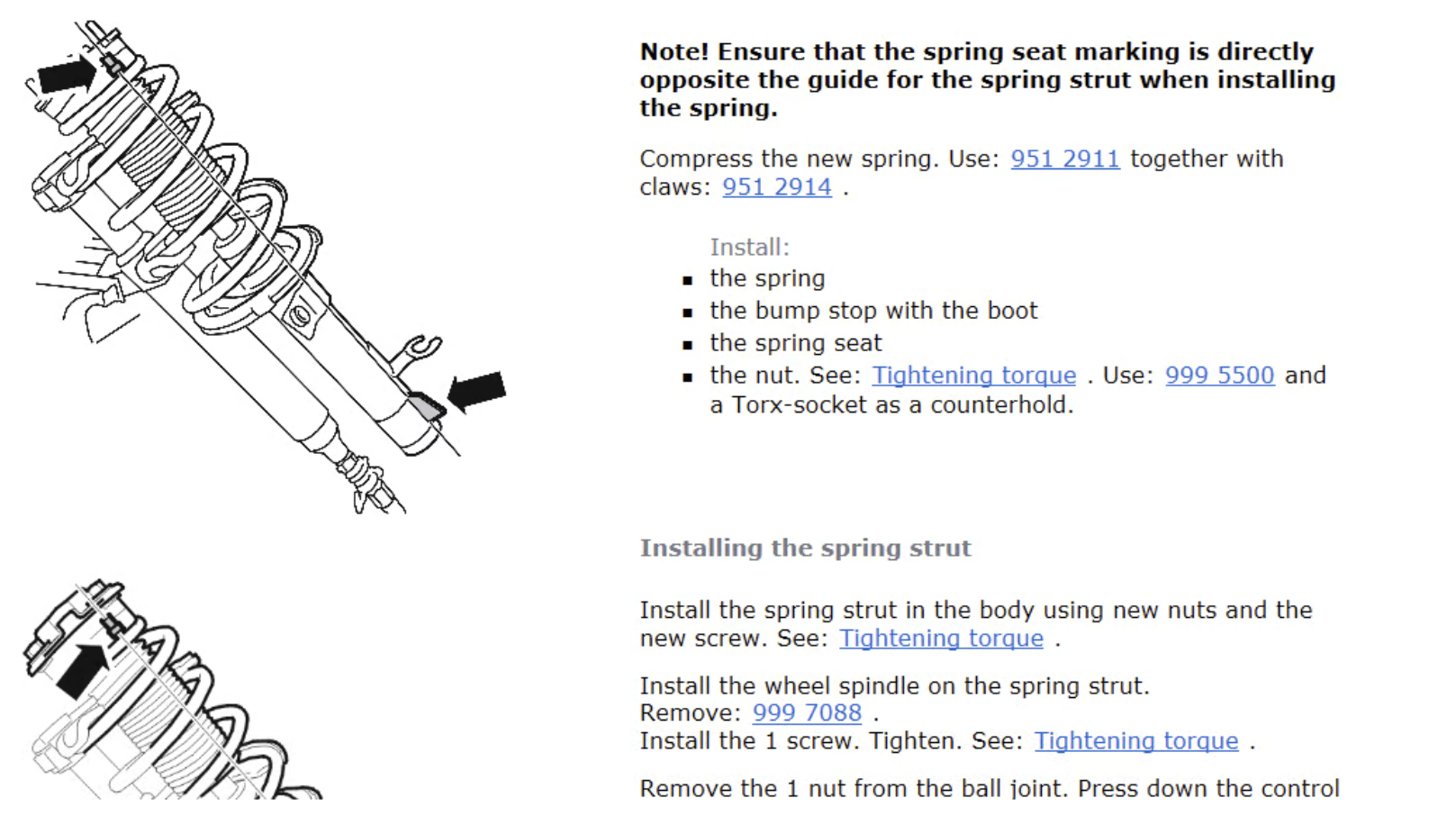

Hello! Im changing the front springs on my Octavia - 07. Theres a tab on the spring seat, should this align with the guide of the spring strut at the bottom? That goes in the wheel hub? Dont know if I got all the words right. I dont even know the correct terms in my main language 😅 I uploaded a picture of this procedure on a Volvo V50. And another thing, how the heck do you know what is up and what is down?
