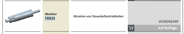

  7. The number for your dealer is, T30122, V03839204P it's about £111 +vat without discount.
