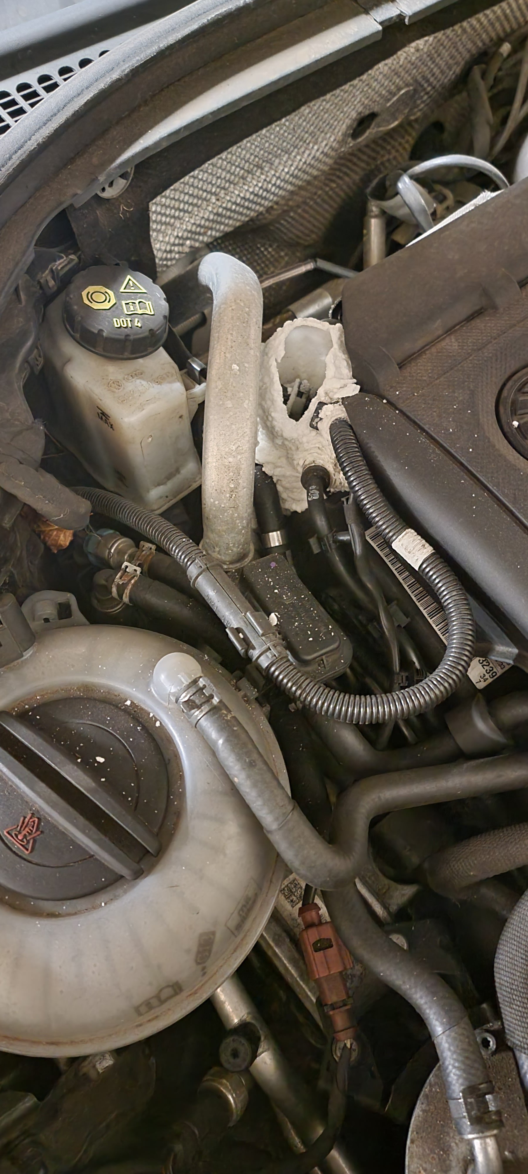

  2. Hi does anyone know what this is? It's the 2.00 litre diesel
