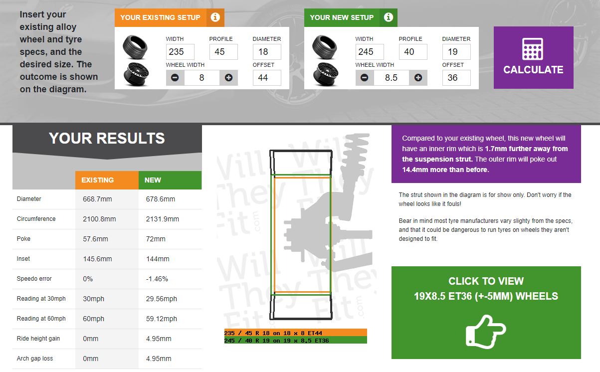

  7. I'll run these tyres for some time but I'll swith to 235/40 R19 or 245/40 R19 which seems a popular choice with 19" wheels. I love how it sits now and they are much more easier to clean!

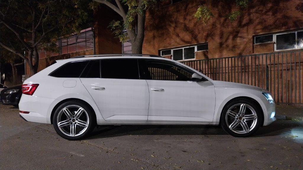

  9. Just fitted some Audi RSQ3 wheels (8,5x19 ET36).
  10. Loving the looks of my car now

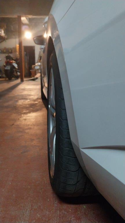

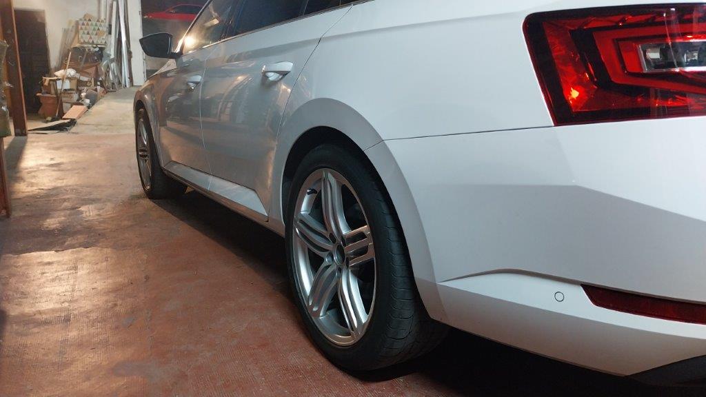

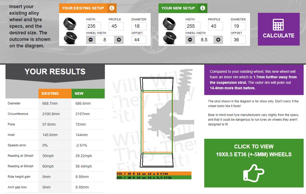

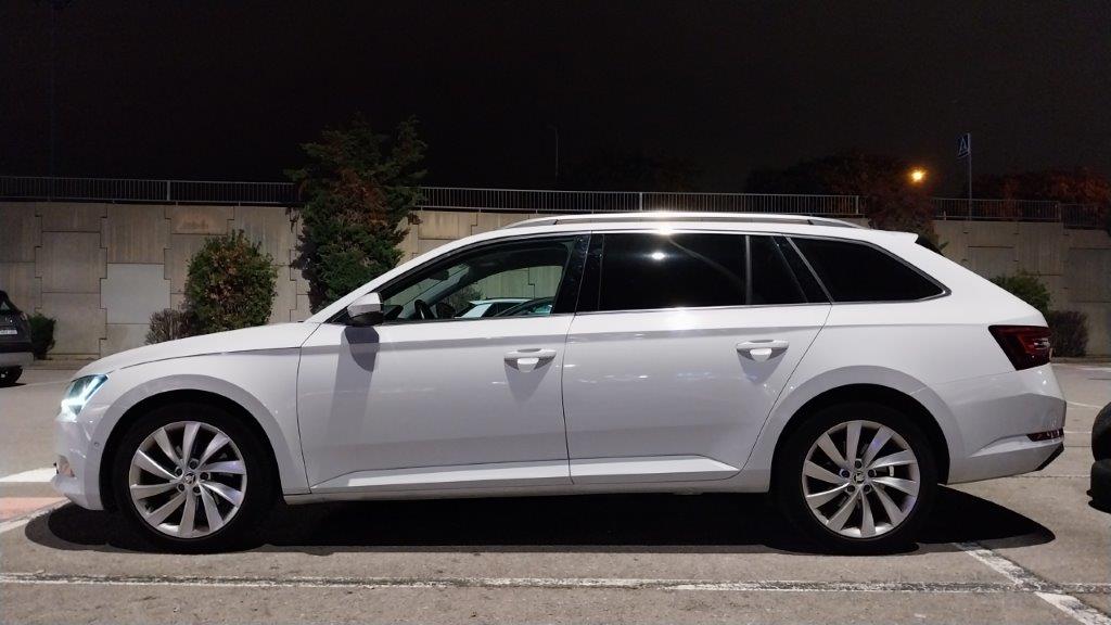

  11. Hi, After a long time looking for some nice VAG 19" alloys, I finally found a good deal on a set of Audi RSQ3 wheels. Specs are 8,5 x 19 ET36 wrapped with 255/40 R19 tyres. My car was originally fitted with Pegasus Alloys, which are 8x18 ET44. I recon tyres are now too big, I'll test them some time and I will finally fit 245/40 R19 once they're over. Car feels now beautifully planted, as it is combined with a set of Bilstein B6 with OEM springs. The car looks awesome now, a bit too high, but I don't want to lower it for daily use reasons. It now sits as if it had 14,4mm spacers all around. Let me share with you some pics of the before vs. after.

  14. DrOcty started following Txmax
