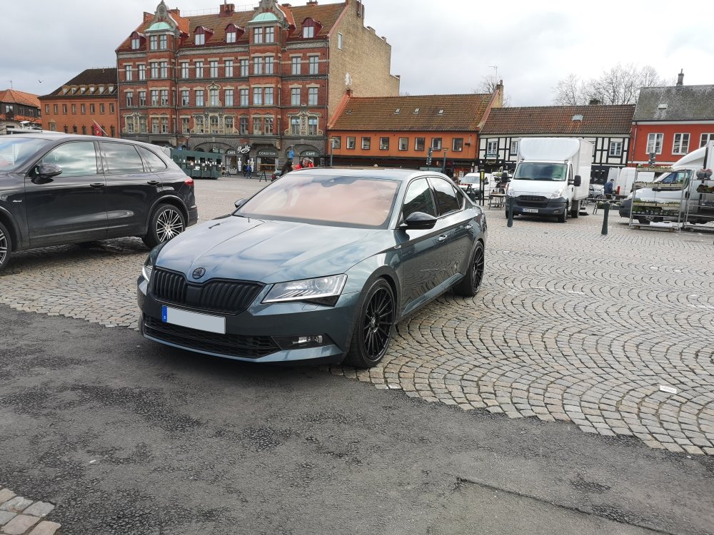

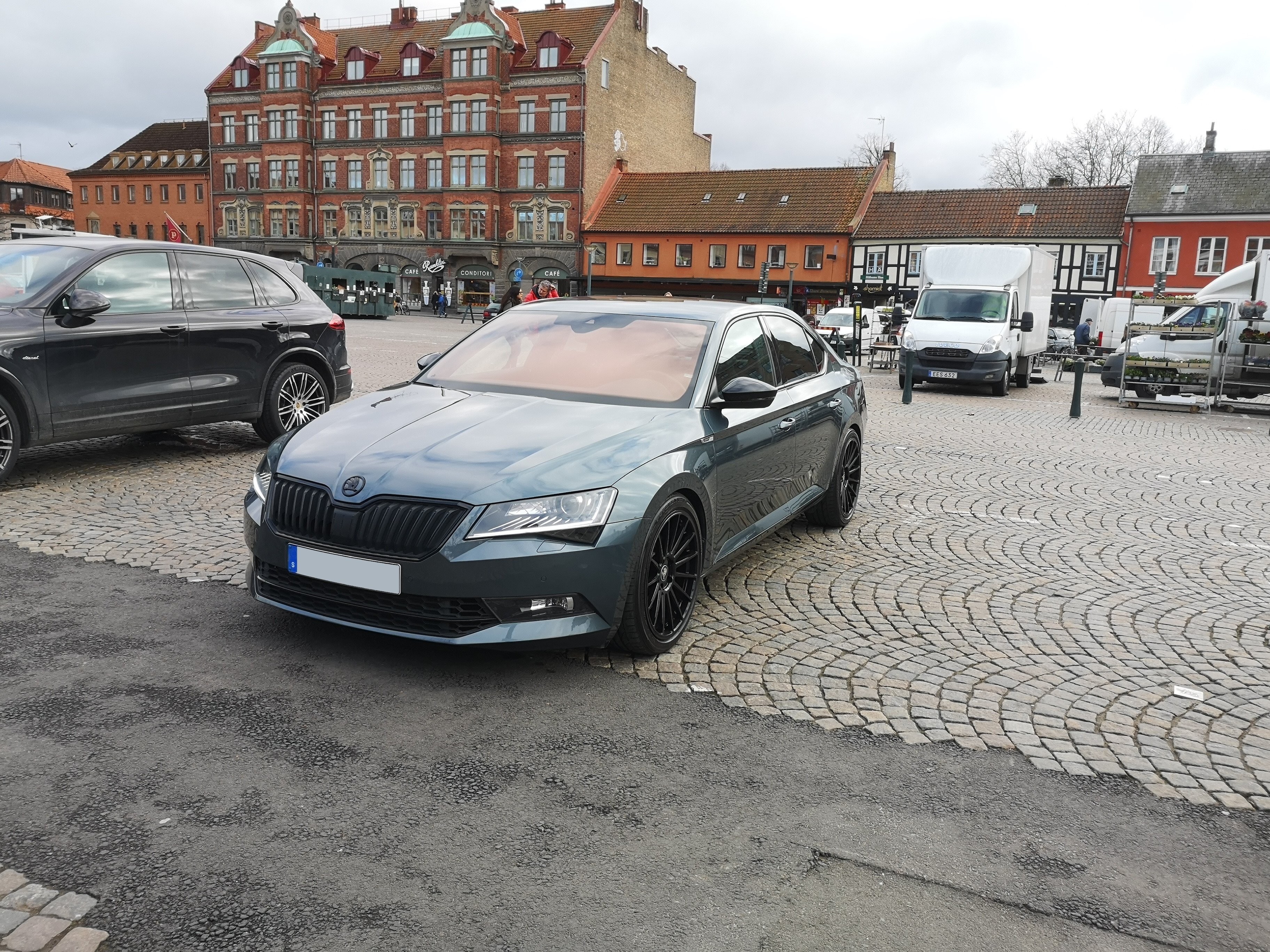

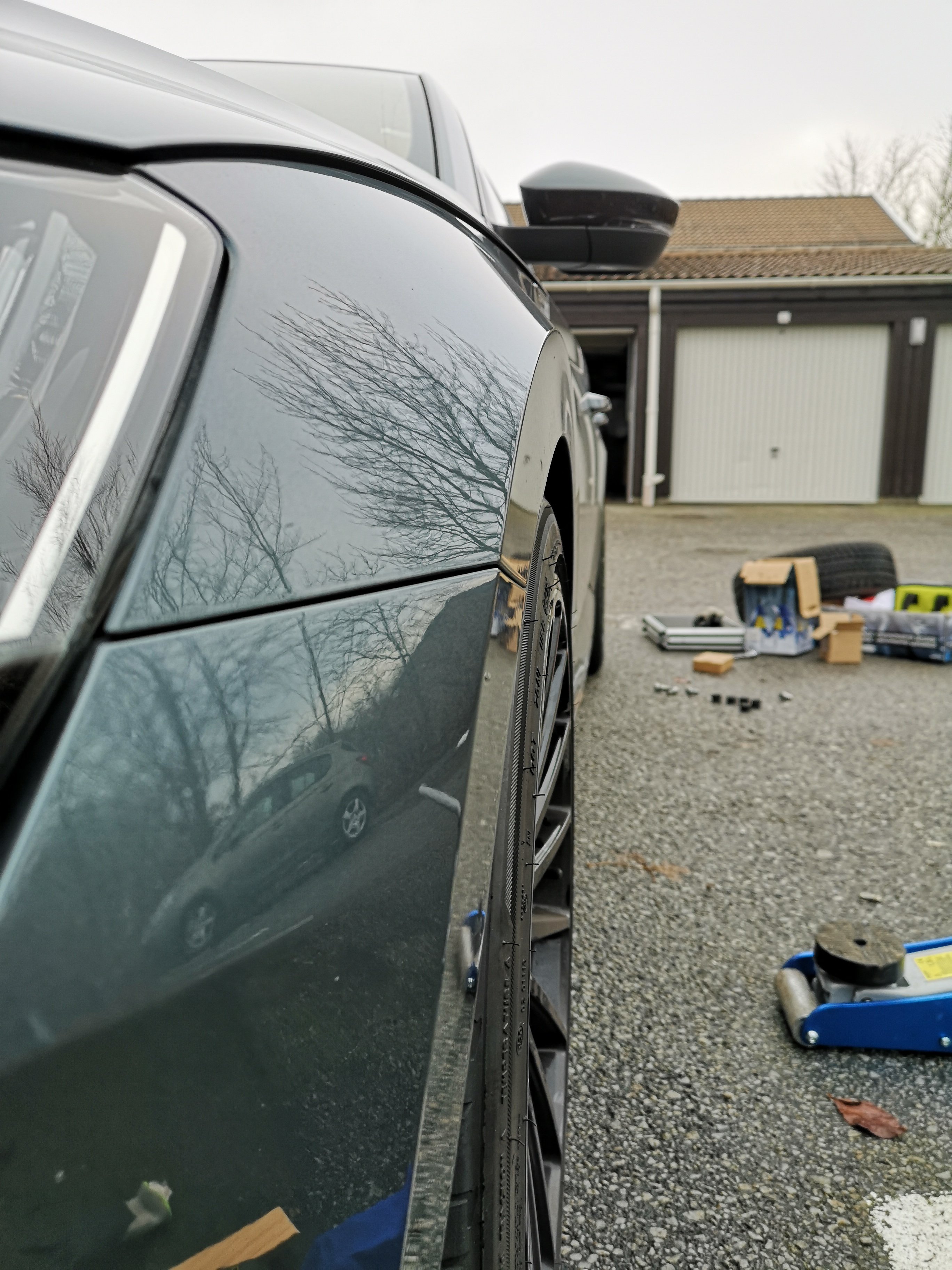

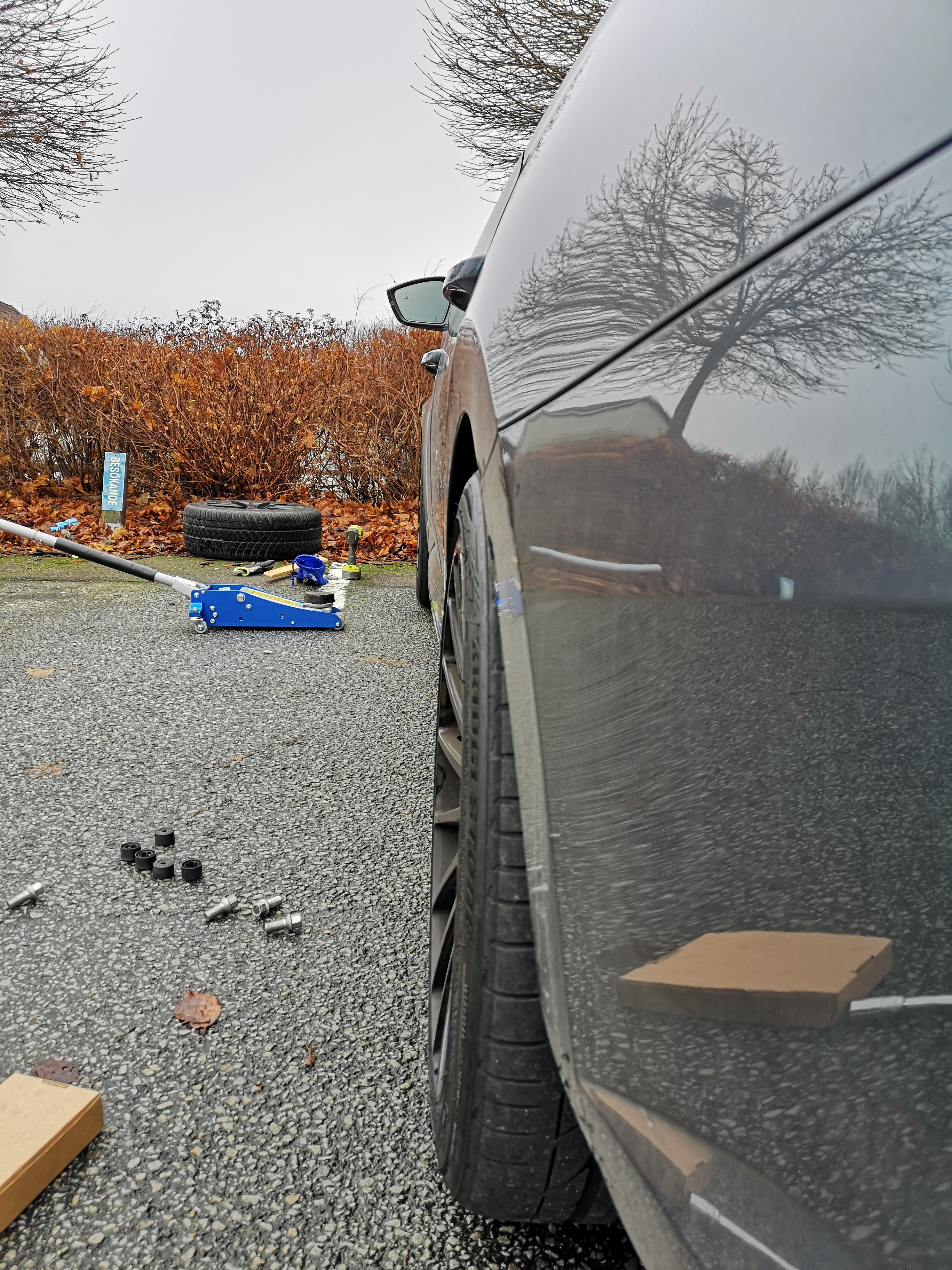

I'm pretty sure on my 272 Sportline the rears were sitting further out than the fronts even as stock and these photos after fitting spacers confirm it: The rears are practically flush whereas the fronts could still spare 2-4mm it seems. Is yours a 272/280 Sportline also? (not that I know for sure that the tracks should be different between the variants, just a guess) No stud & nut kit (hadn't done a conversion) but simply 10mm longer bolts with the correct seat for the alloys. You only need to make sure the longer bolts have the same seat as the alloys you plan on using them on, the Ispiris I had featured a conical seat instead of the spherical R13 the OEM alloys do.
To be precise, the 23.4mm is achieved by both the aftermarket alloys being wider & with different offset (the distance between the mating plane of the alloy to its outer edge ) pushing the width of the wheel out by 13.4mm, plus the spacers which push it further out by an amount equal to their thickness (10mm). So, if the stock tires are pushed out by 23.4mm that means an equal amount of tire could fit yes so 235 > 255 should in theory fit. I can't comment about the 9" alone because you don't specify the offset, and these go together. If you mean 9J ET37 that would mean an increase of 6.4mm both ways comparing to my setup above (equally outside and closer to the strut) so that's not going to be the same. With 9J you would need to drop to ET30 to ensure the 255 tire would not be any closer to the strut than stock (it would be even 1.3mm further away) and then it would poke out by 26.7mm which is 3.3mm more than I had in mine and I imagine it would be really at the limit. Yes it's the rears that were sitting almost flush with the extra 23.4mm (maybe 2mm in). I remember the fronts were sitting a bit further inside but for extra safety I went with the same setup all around and didn't mind it.
At the time of those photos I just had the Eibach springs on and the wheels were Ispiri FFP2 19x8.5 ET37, poking out a further 13.4mm compared to the stock ones. However the tracks are so narrow that even those wheels looked slightly hidden inside so I later added 10mm hubcentric Eibach spacers which brought it closer to a flush look (still 3-4mm from fully flush and definitely no rubbing whatsoever) which finally made it perfect for my like and discreetly more aggressive. Here's a photo of the wider alloys + 10mm spacers on, which together equalled to 23.4mm further poking out compared to stock: PS. Corrected the original poking out value from 18mm to 13.4mm. PS.2 Stock 235/40/19 tires
