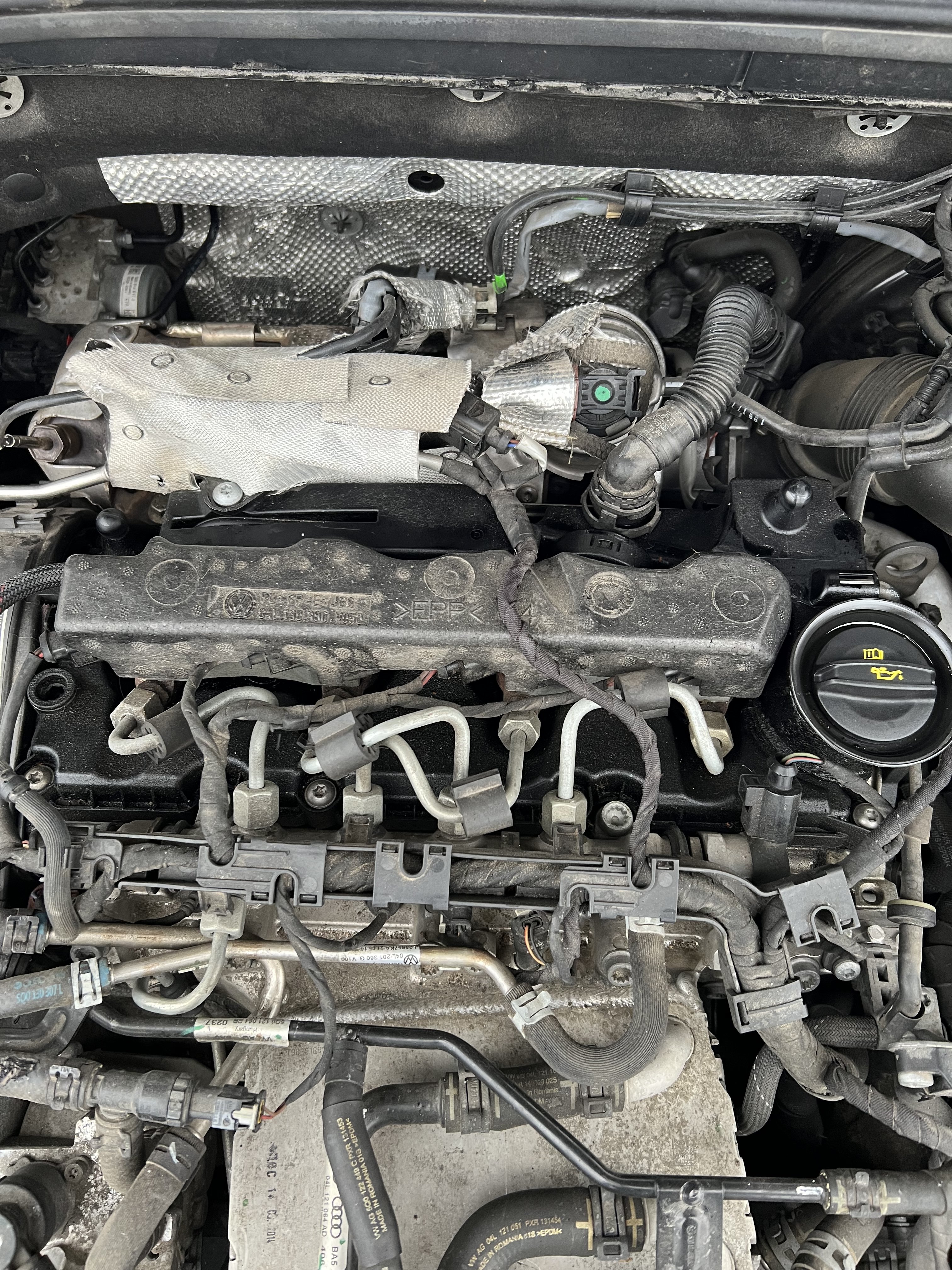

Is this rubber diaphragm a part of the valve cover, or is that purchased seperately? If i go the aftermarket route, a complete valve cover with gasket can be had for around 130 euro, so its not all that bad.

Hi I have an oil leak from the valve/rocker cover. I’m going to replace the gasket, but I’m wondering if there are any other gaskets or o-rings that should be replaced at the same time? Only thing that comes to mind is injector seals, but I don’t know if that is necessary. Also, would it be pointless to replace the whole valve cover as well? Since it’s plastic and might be prone to cracking. Car is a Octavia VRS 2.0 TDI CUPA -2015 with 240k km

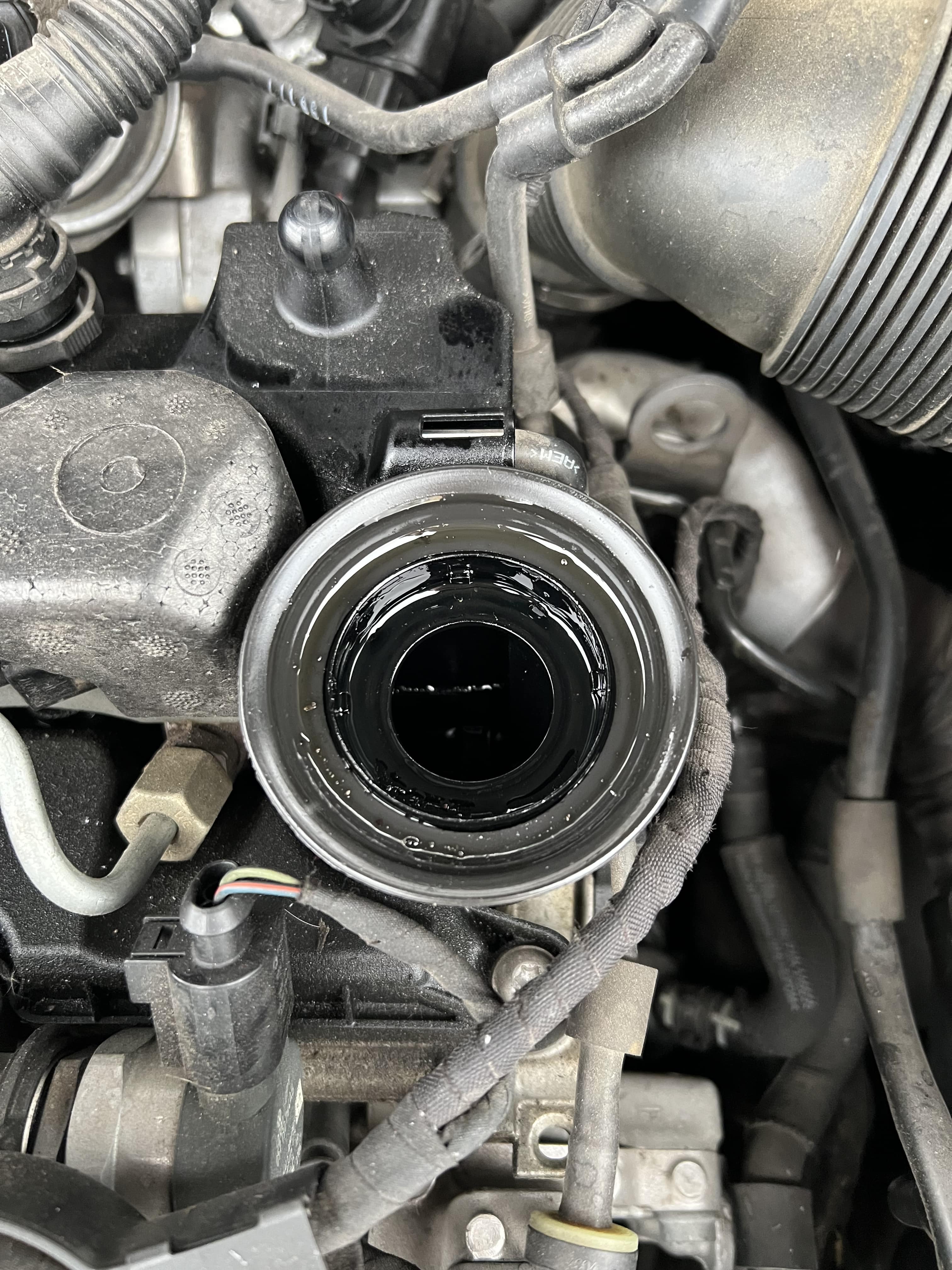

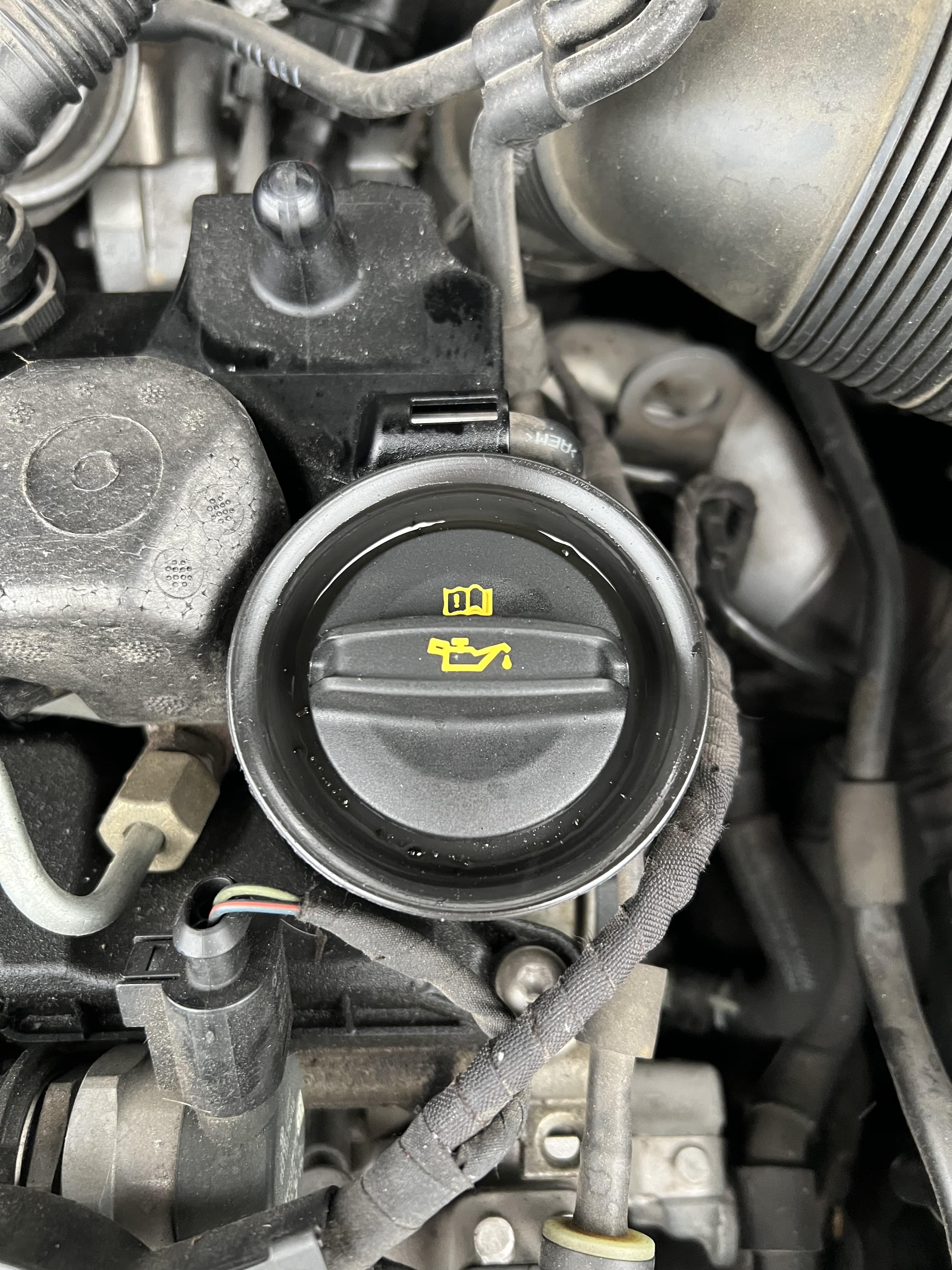

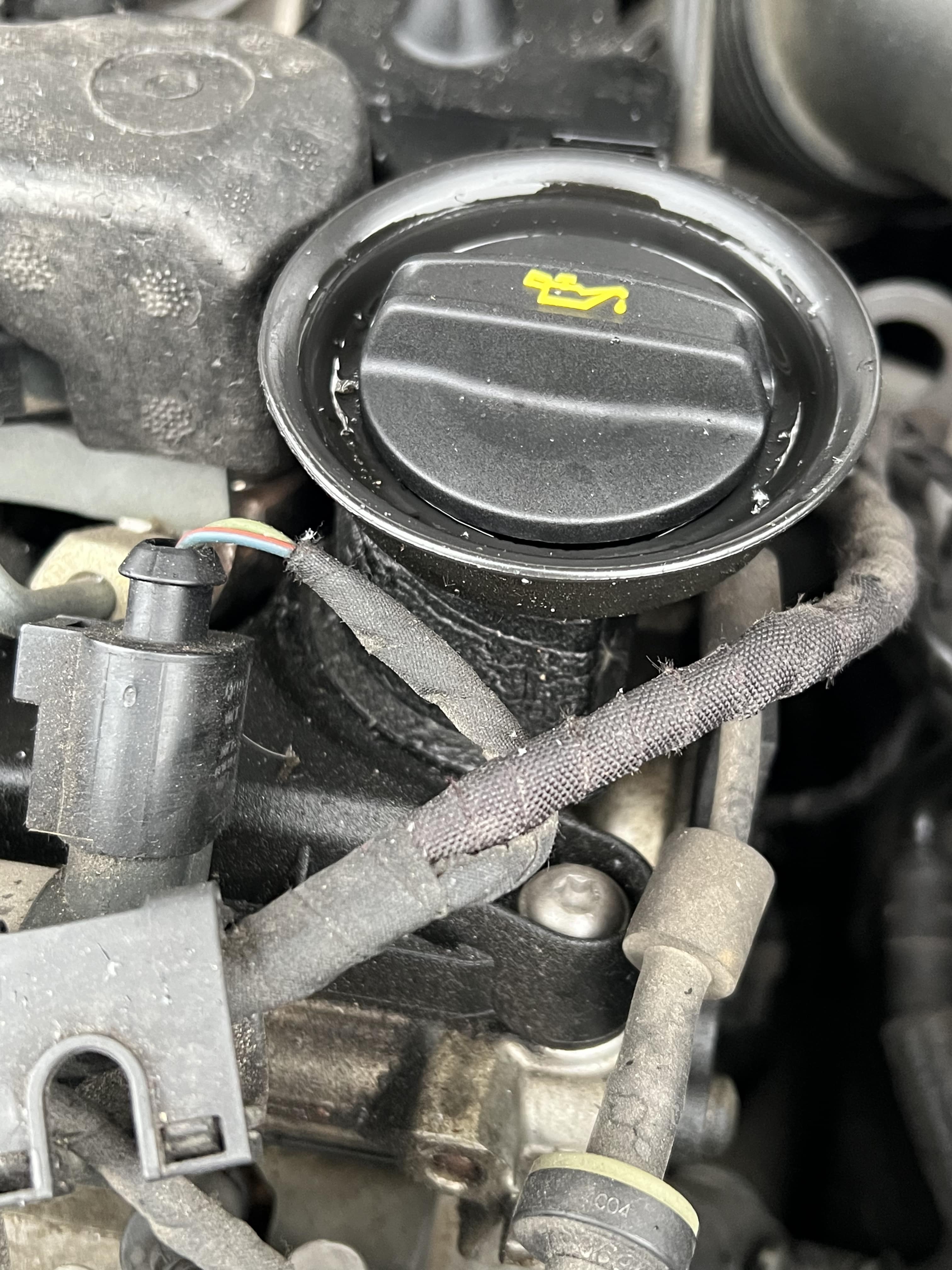

Oil around the filler cap
- Oil around the filler cap
I’ll try running the engine a bit with filler cap off. I did notice fumes coming out when I removed filler cap though, after shutting off the engine, but it was very mild. Could it be PCV valve? - Oil around the filler cap
