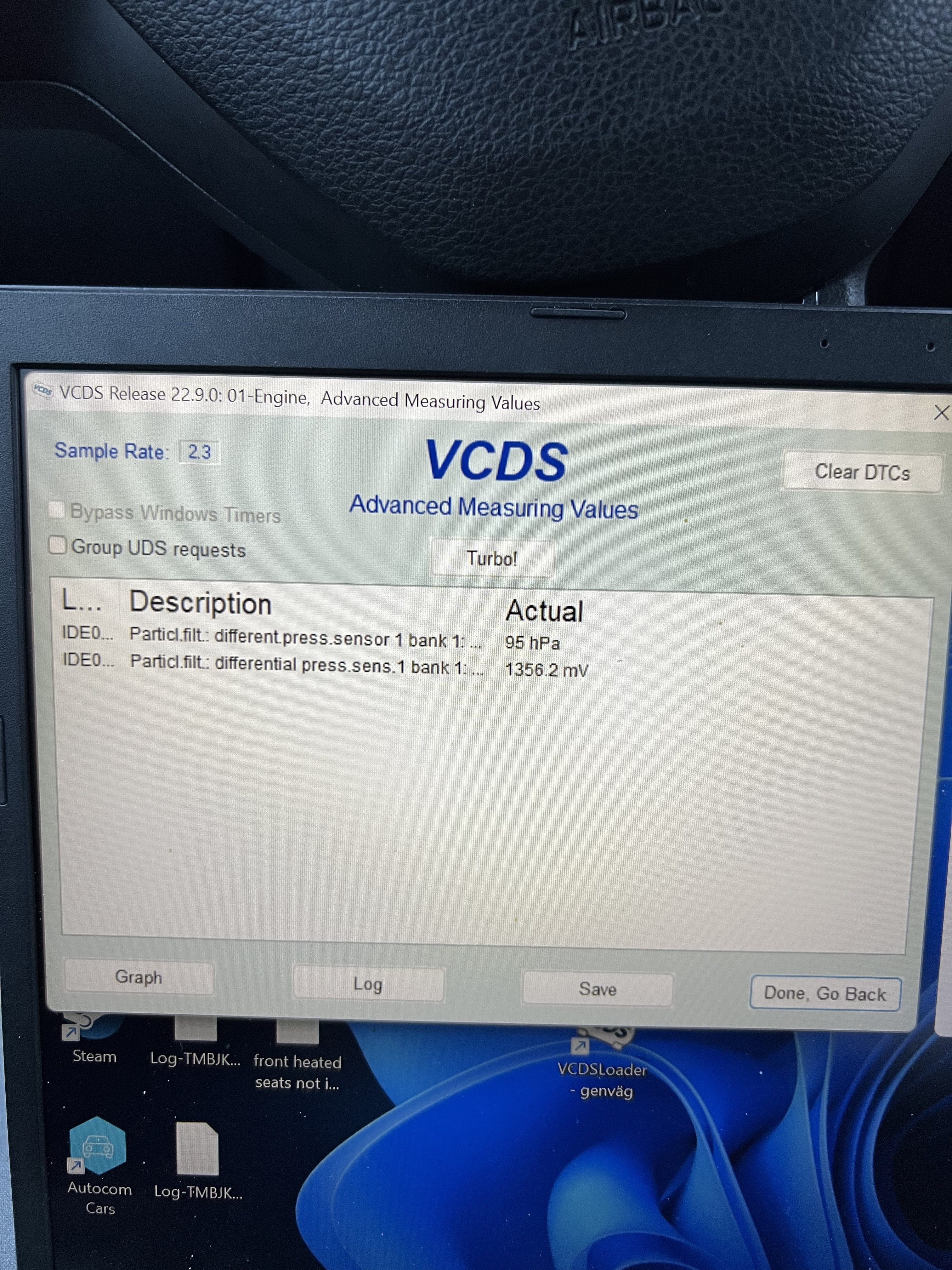

  9. Hm, weird. Today i saw idle at 1000 rpm yet again and the cooling fan running after shutting the car off. Checked with VCDS and it’s showing 15g of calculated soot and 6g measured. Yet VCDS is also saying that last regen was many thousand seconds ago, which should be correct as it shouldn’t even trigger an active regen until it reaches 22.5g of calculated soot. Think i might also replace the pressure sensor just to be safe. FYI, I did reset oil ash mass after the DPF was cleaned, which also resets soot values.

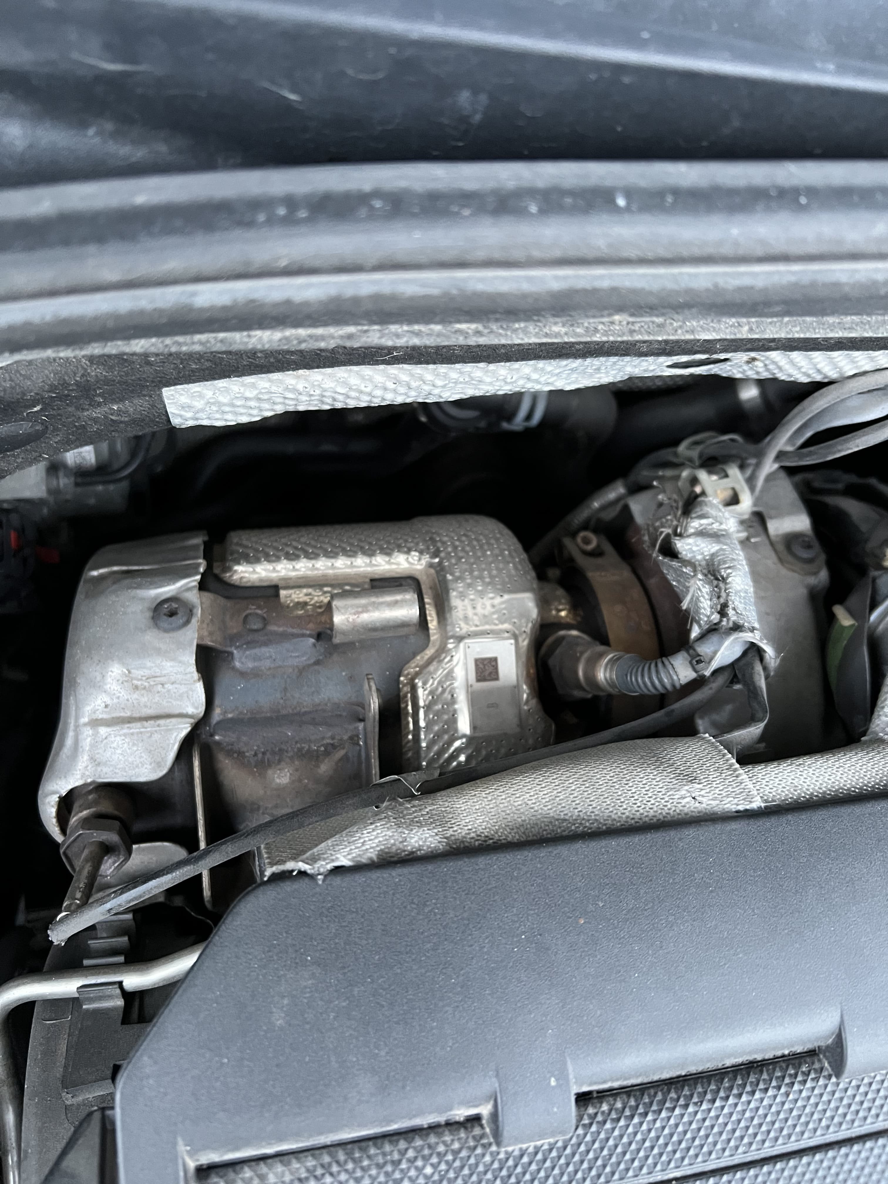

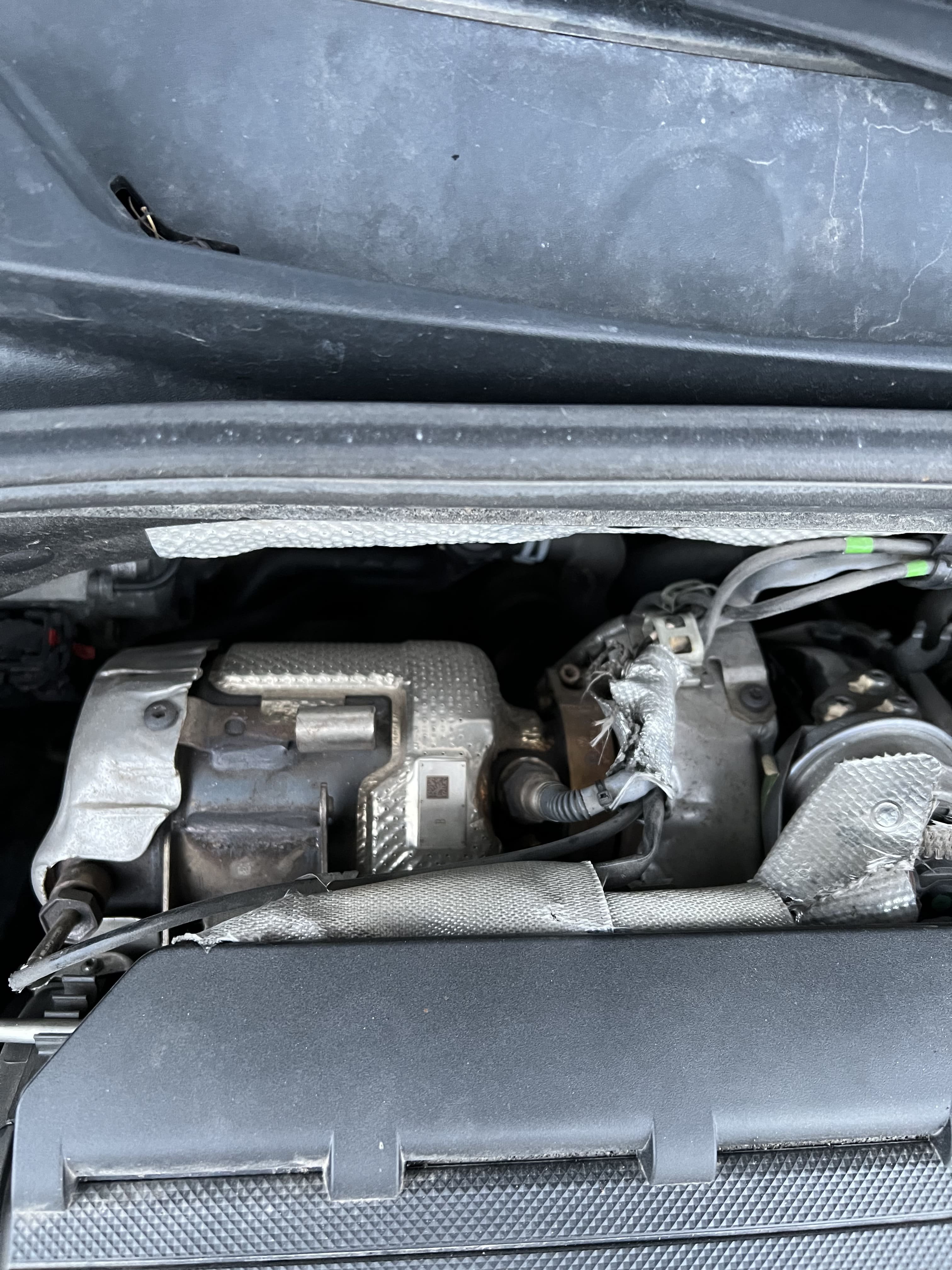

  17. I was tempted to try this as well, but it seems more like a band aid solution if anything, if my DPF is really that heavily clogged. I’m looking for a long term solution so I hopefully won’t have this issue again, since I very rarely drive short journeys unlike the previous owner. Hopefully someone knows, otherwise I will update with the process.
  18. I decided to just remove the DPF and send it off to get it professionally cleaned. Will begin with that in the coming days. I haven’t had the car up on a lift yet since I bought it, and seen how things are located underneath. Do you know if it’s enough to lower the subframe to be able to get the DPF out, or do I have to completely drop the subframe altogether?

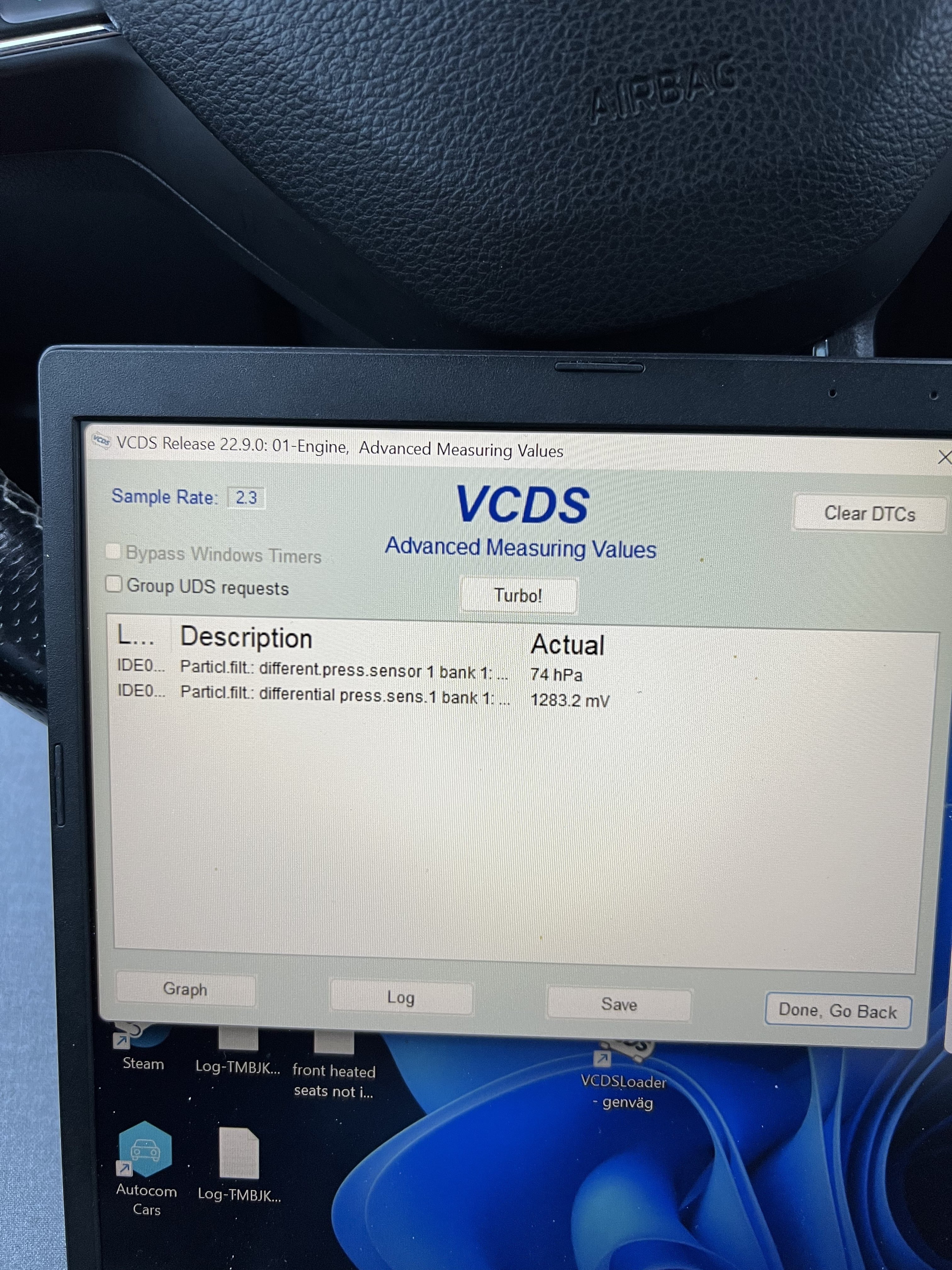

  19. But this time around, sensor was reading 143 hPa compared to 95 hPa just a minute earlier, both at 2500 rpm idle. Might have to undo the DPF and give it a wash instead, I’m not too keen driving it in constant regens while waiting for the aftermarket DPF to be back in stock. Was hoping that resetting the DPF values would be a temporary fix until then, but not even that seems to be working.
  20. @varooom Don’t know if I’m allowed to post links, but this is literally a minute after the pictures I took before with the different sensor readings. I decided to rev it to 2500 rpm again and this is what it looked like a minute after: https://streamable.com/z84a7r

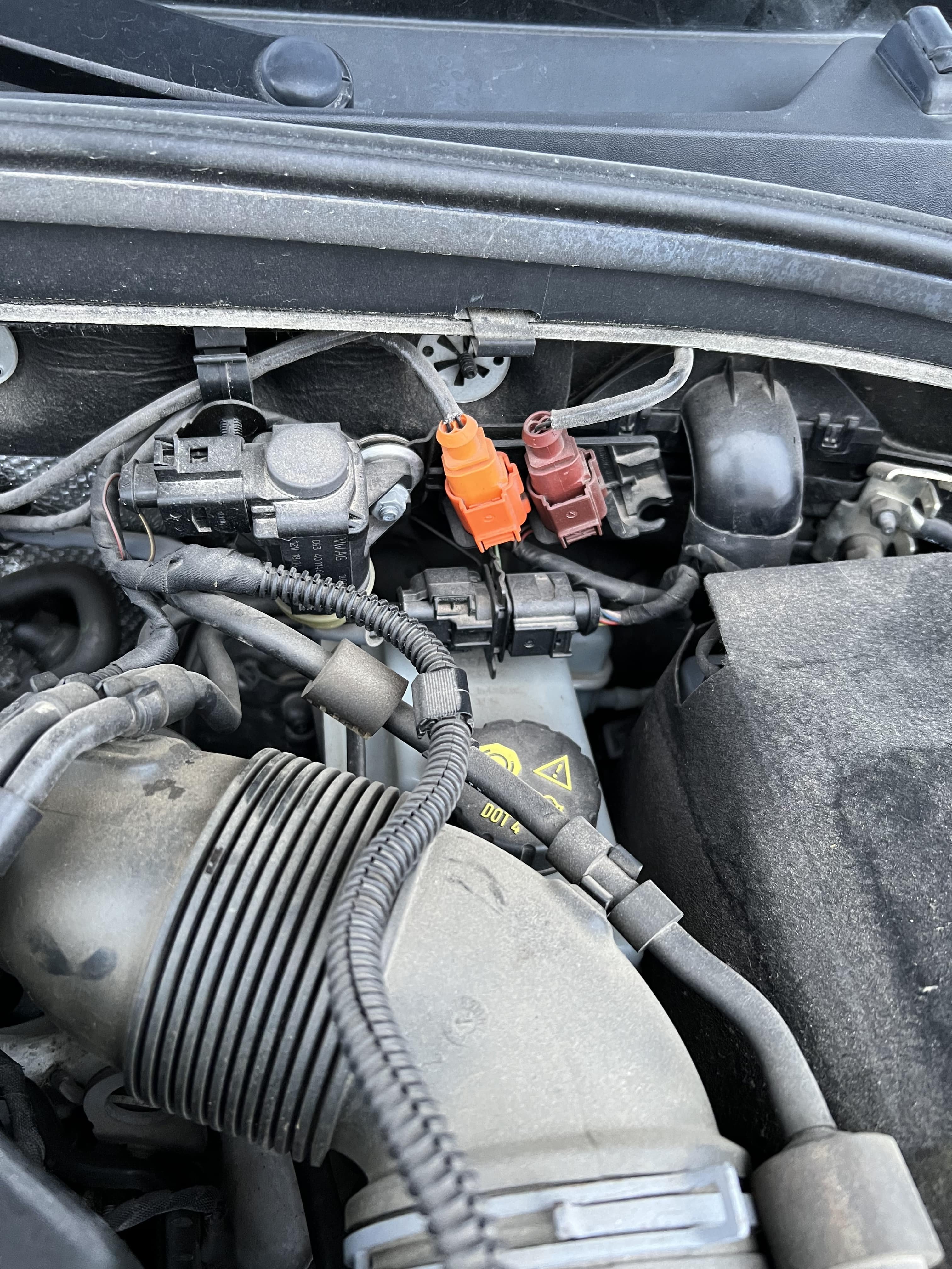

  21. Not sure what I have, I just took some random pictures. But VCDS does not seem to be displaying two sensor values.

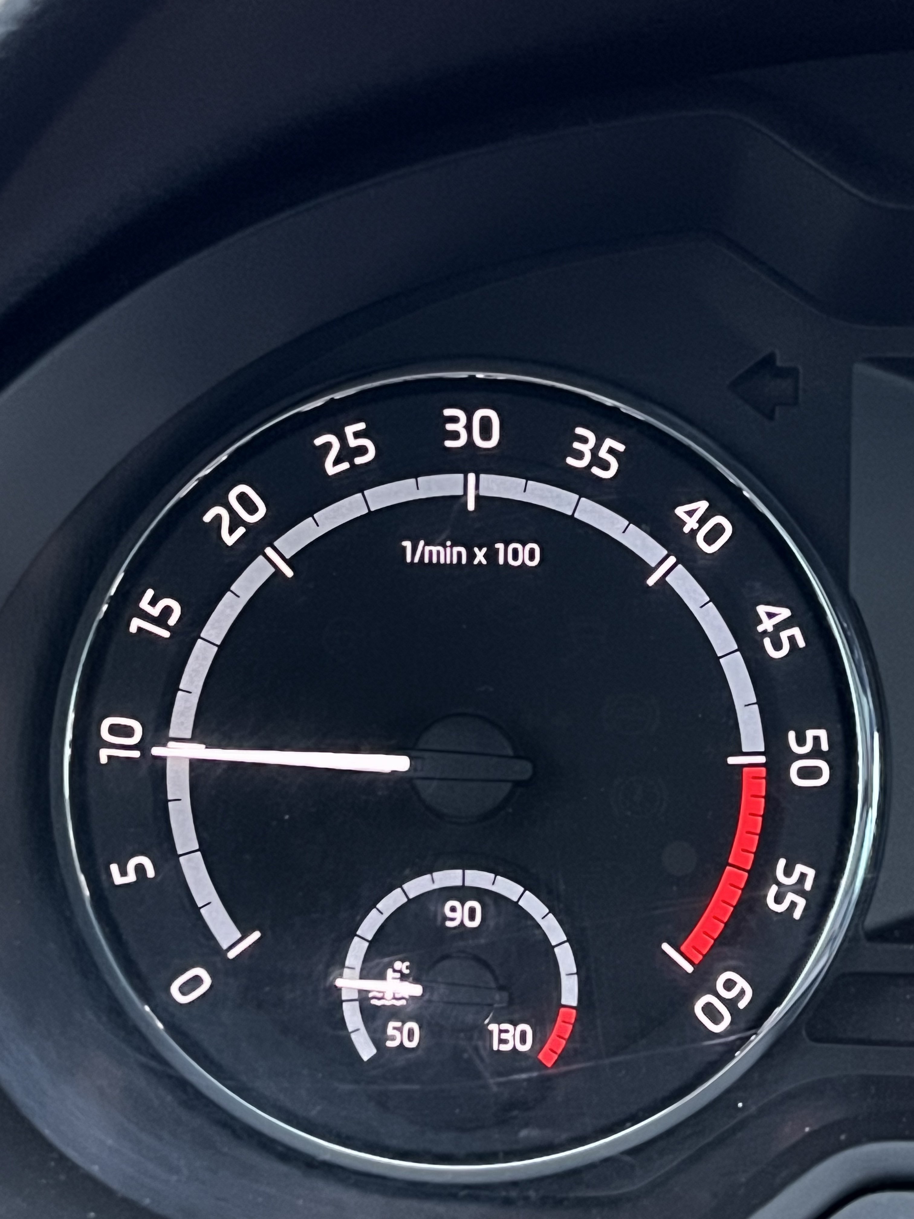

  22. Also, rpm is going up and staying at 1000 5 mins after a cold start, nothing was up to temp yet so it shouldn’t initiate an active regen. Right when starting up it was idling at 600-700 just 5 mins prior.

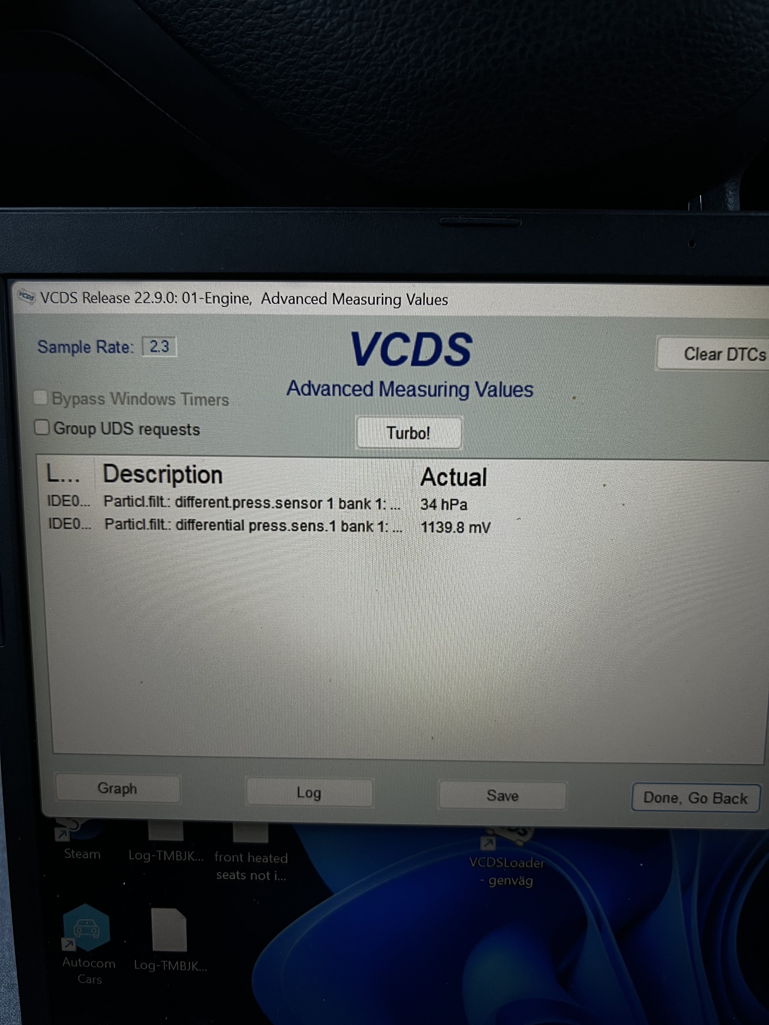

  23. Here is sensor readings for off, idle, 1500 rpm and 2500 rpm Off: 0 hPa Idle: 34 hPa 1500 rpm: 74 hPa 2500 rpm: 95 hPa
  24. Will do that in a bit and report back. Do you know if the pressure sensor is a 2-port one that reads before and after pressure, or a 1-port that compares to atmospheric pressure?
