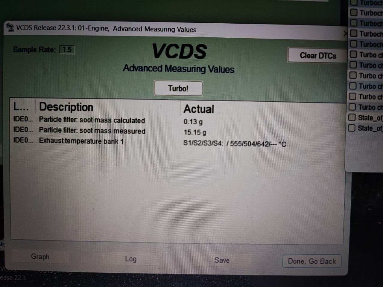

  • Here is some values I pulled from VCDS. This is after 6 hours of almost straight highway driving after a journey I did today.

When you get your VCDS, you should measure the values of the 3 MVB's (Measurement Value Blocks)
If the soot values are near 22g, then perhaps you should do one more static regeneration to get a baseline of what's going on.
I found that my Soot measured didn't go under 15g during regeneration, so had to abort it.

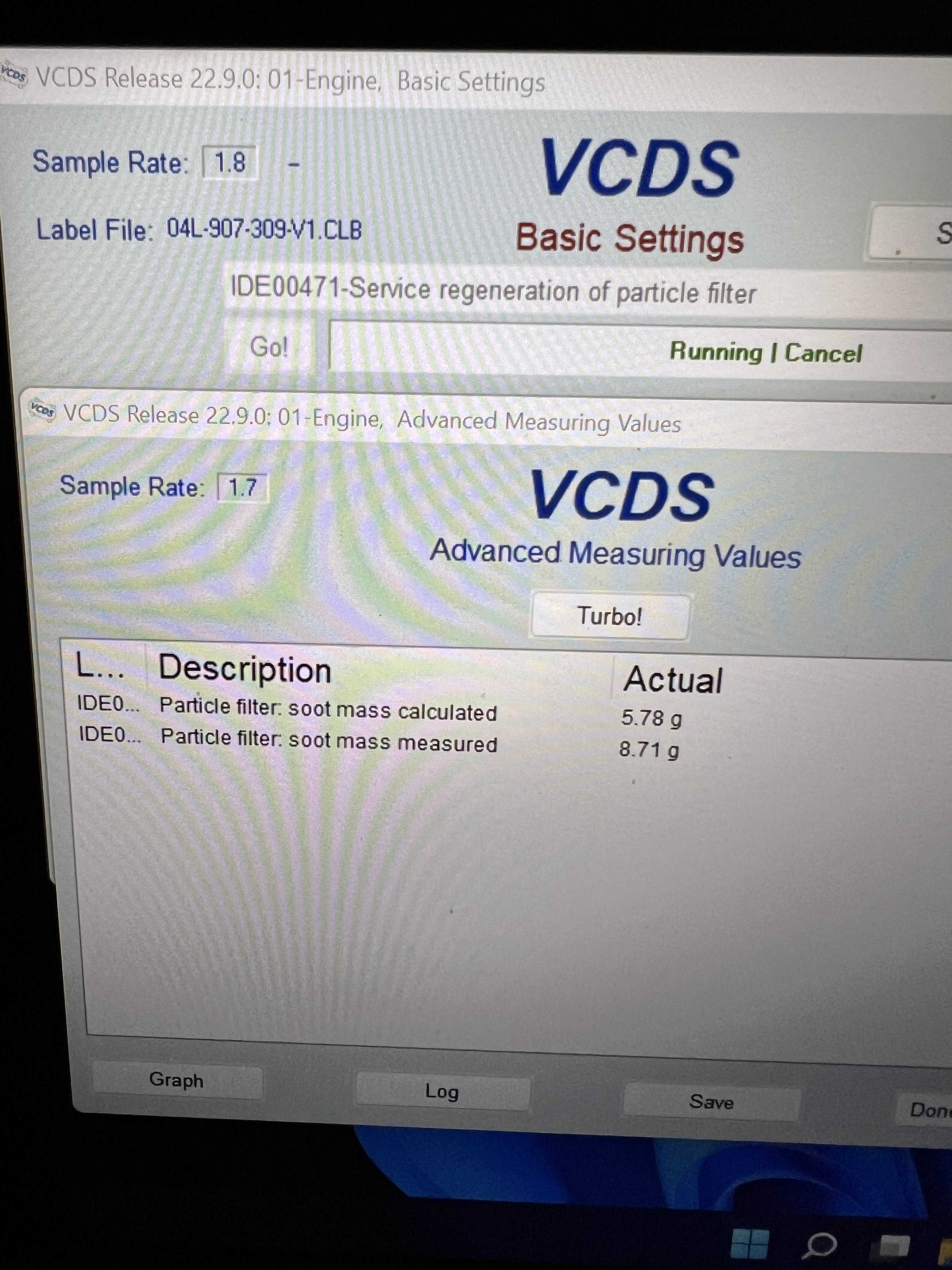

When you do the regen with VCDS, you can open up MVB's during the process, so you can bring up Soot measured, Soot calculated, then you can bring up measuring blocks for exhaust temperatures.
Sorry for the poor screenshot, taken on phone not PC

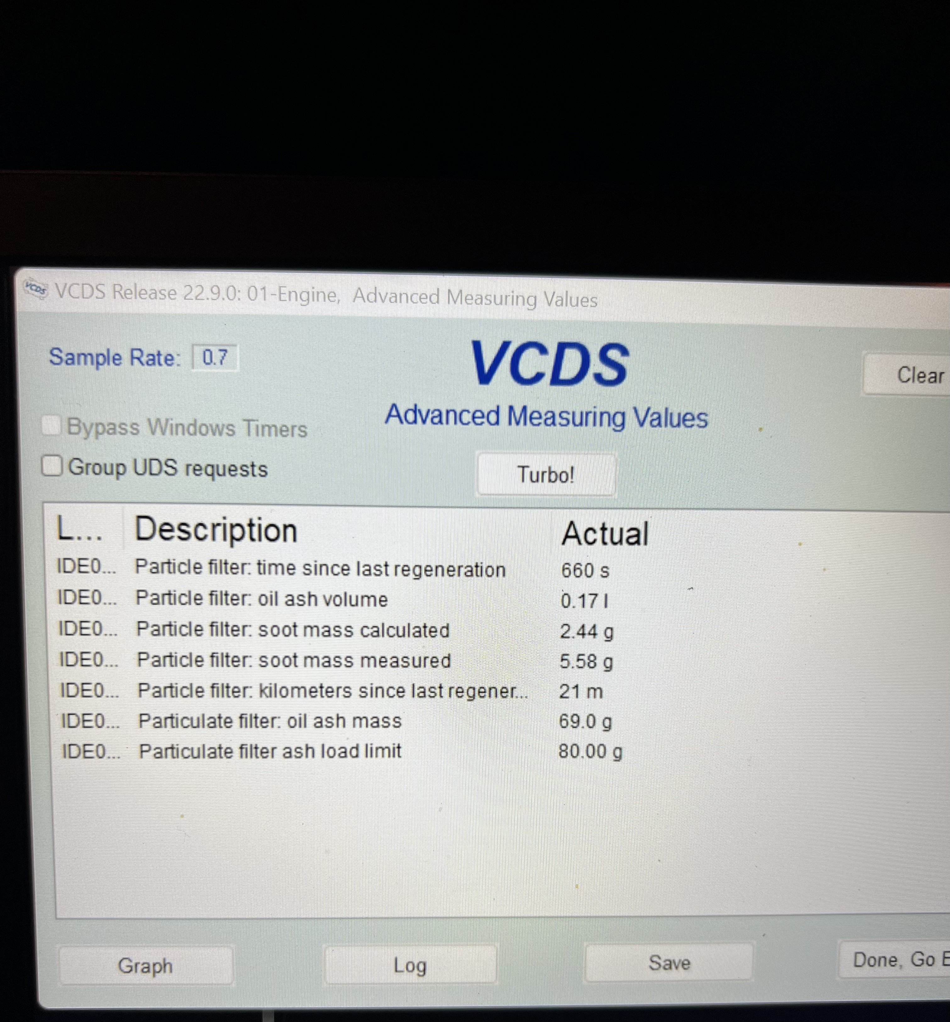

Hi, plugged in VCDS to do a regen and this is the values showing. Seems kind of low, why is it trying to do an active regen all the time then?
See if you can find anything on time/distance since last regen.
Mine even put the exhaust lamp on the other week, but soot values similar to yours.
They have many fail-safe features, soot calculated, and also time/distance since last regen.
Tha fact that your measured value is significantly higher than the calculated (or even higher at all) is a cause for concern, the diff press sensor is indicating that the DPF is obstructed, it may be a sensor failure or one having been replaced and not calibrated but I would not expect the measured value to exceed tha wildly pessimistic calculated one.
I would check how many kms since the last regen, beware it expresses the value in metres! Typical of the rubbish put out by VCDS, I dont know if its them or VAG to blame but you simply cannot trust many of the units or their +ve & -ve values.
I would keep an eye on the readings and see how quickly it rises and also test the diff press sensor reading at idle and the max 2.5k RPM you can do at a standstill, if you have a passenger who wont get carsick looking at the laptop screen then check it while driving.
To answer your question, and this is only speculation on my part, its trying to do a regen all the time because it hasn't been able to complete the previous ones, 8.71 grammes is probably above the regen completed threshold, you will find what it is amongst the millions of VCDS measuring blocks, 3 grammes rings a bell for my engine.
Edited by Orman
Edited picture
Soot is coming down nicely, I guess you will probably need to budget for a new exhaust, or cheat and tell the car it has a new one fitted.
But how come the car starts to actively regen with only 5,58g of measured soot, exactly every time I go out and drive? On longer drives, even on straight highways, it will even pop up with a check DPF warning.
If you are driving down a motorway, but not above 2,000 rpm (or what the car needs) then after 60 minutes it will put on the exhaust lamp due to "failed" regens.
Just today I drove down at least 15 miles of motorway above 2,000 rpm, when I got home it was still trying to regen, they are strange how they act.
Your exhaust is getting very near end of life, so it is going to be doing regular regenerations to try to keep the soot from blocking and then you cannot do any regens at all.
I think this is normal as the exhaust gets near end of life, as in early years the generations are less (this is how it seems to me)
