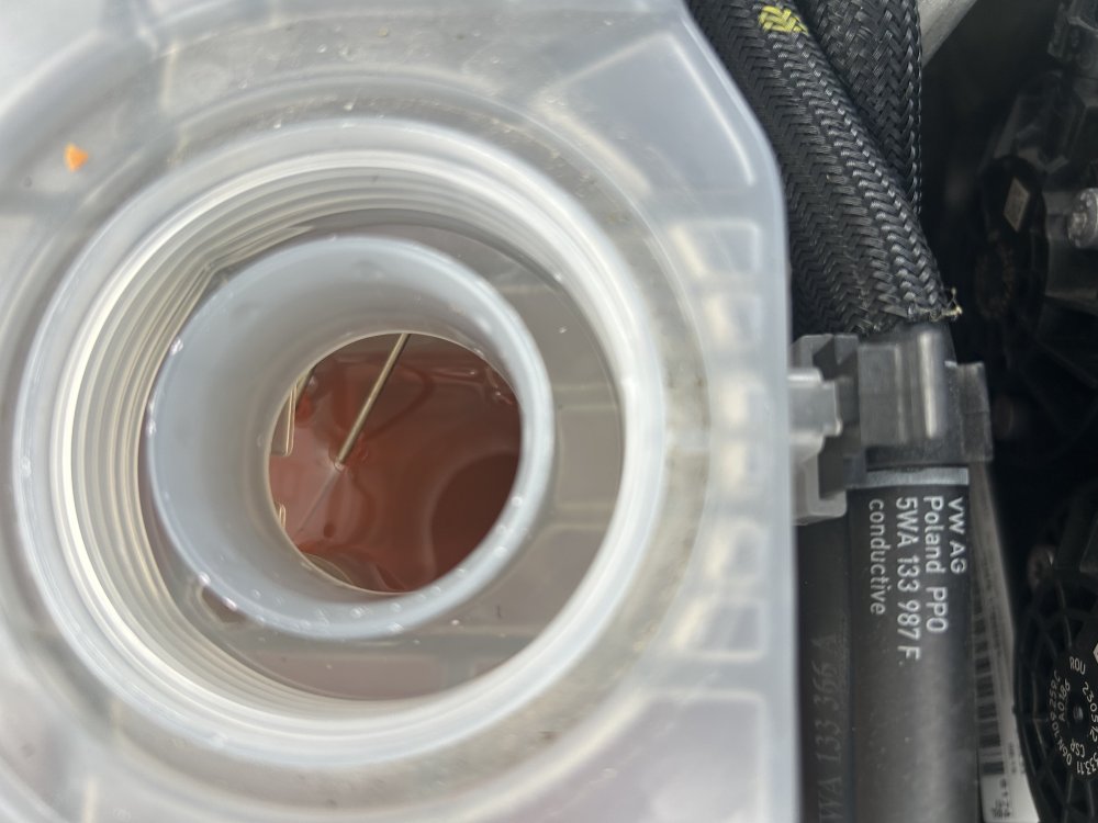

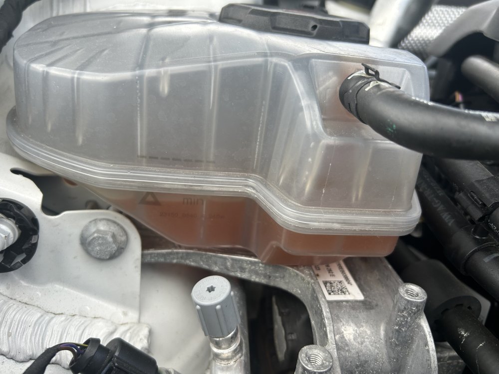

Sorry to hijack this thread but am looking at 2023 Superb from a Skoda dealer and the coolant is a murky brown. They assure me this is correct but it looks wrong and definitely not pink or yellow or purple. Views?
@GreenGeorge 2023 should be with G12Evo coolant which is purple. Unless it has done 100k miles for less than 2 years, it should be with the factory coolant.
I’m not sure are the water pumps still failing on the Facelift S3, but if the car history doesn’t include it, most likely it wasn’t changed.
Of course there is always a chance that someone has topped up the wrong coolant, but there is no easy way to find this out.
Ask the dealer how much does it cost to change the coolant for the peace of mind or negotiate it in the final price. There are 10-12 liters if I recall correctly with many circles and it requires diagnostics.. changing it is a pain in the neck 😆
