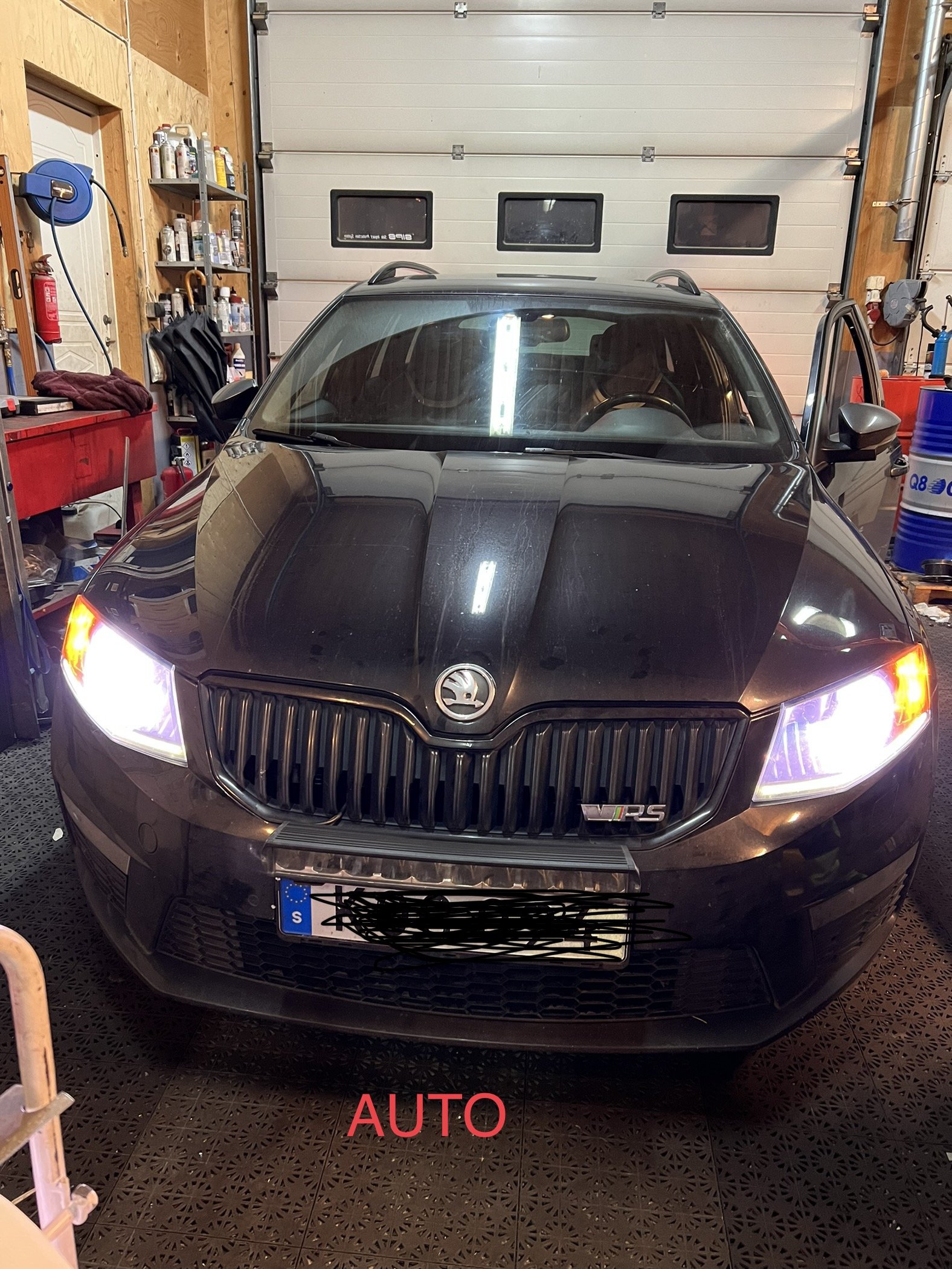

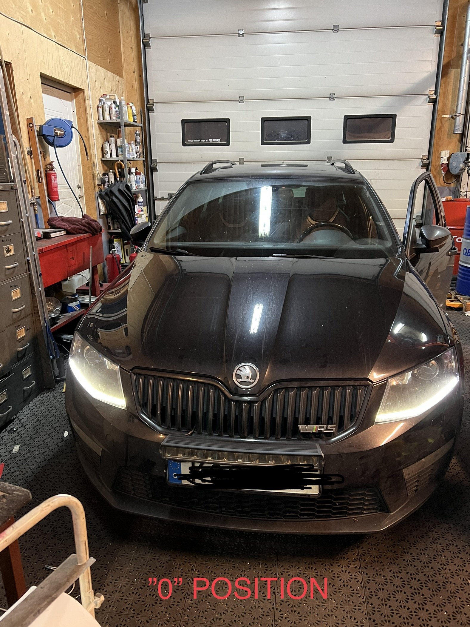

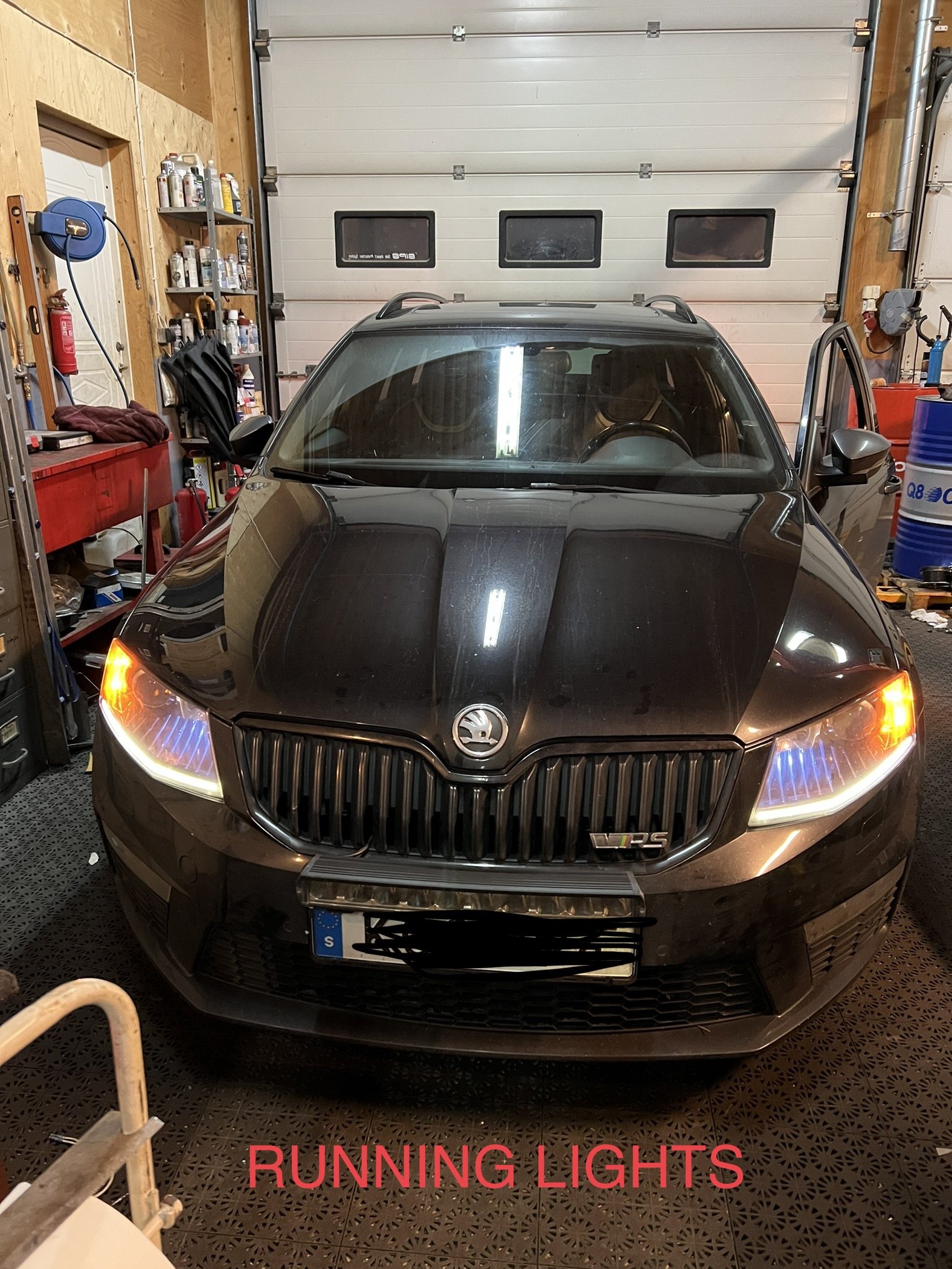

I’m not sure, I’ll have a look tomorrow. However, all lights are working as intended in the rear, including turn signals, which are not always lit up. If it’s cheap LEDs used in the side lights, shouldn’t the car throw a check light warning for both left & right side? It’s only throwing it for the right side. Or is this not always the case? However regarding the front, I did notice two things. 1. When the headlight switch is at the “0” position, as shown in the picture above, they finally stop constantly illuminating. But when the headlights are in this mode, they do not even light up when indicating either. Meaning they are just completely off. In every other position on the headlight switch (running lights, auto, low beam) they do indicate as intended. But when not indicating, they are instead always illuminating. 2. The LED strips, or DRL as you mentioned, also blinks when indicating, but exactly out of phase from the turn signals. Are these even supposed to blink when indicating? If so, are they supposed to blink in, or out of phase compared to the turn signals?

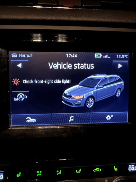

Which lamps are the front side lights? Isn’t that the LED strips along the bottom of the headlight? Cause those are not replaceable, right? The thing is, when I indicate either left & right, the indicators on the dash blinks rapidly. If I’m not mistaken, cars usually do this if there is a fault in the system such as a broken lamp. But I’ll take a look at the coding. Do you know how to find the relevant coding in VCDS?

I have an Octavia vRS -15 that I bought a week ago. I just noticed a couple days ago that the front turn signals are always lit up, except for when the light switch is at “0” position. And they are blinking out of phase with the side and rear turn signals. Also, it’s always giving a warning for front-right side light, even though it works fine. The car had a LED light bar mounted for high beam with built in DRL function, and it was installed by splicing signal directly from high beam and DRL wires with crimp connectors and speaker cable… Today I removed everything and disconnected LED bar completely with the relay and all wires, thinking the problem was related to that by messing with the canbus or something. But the issue still persists. The only thing that is now fixed is that the front turn signals are now blinking in phase with the rest. Any idea to what is going on? I have VCDS but it’s not showing any fault codes, unless I don’t know what to look at.

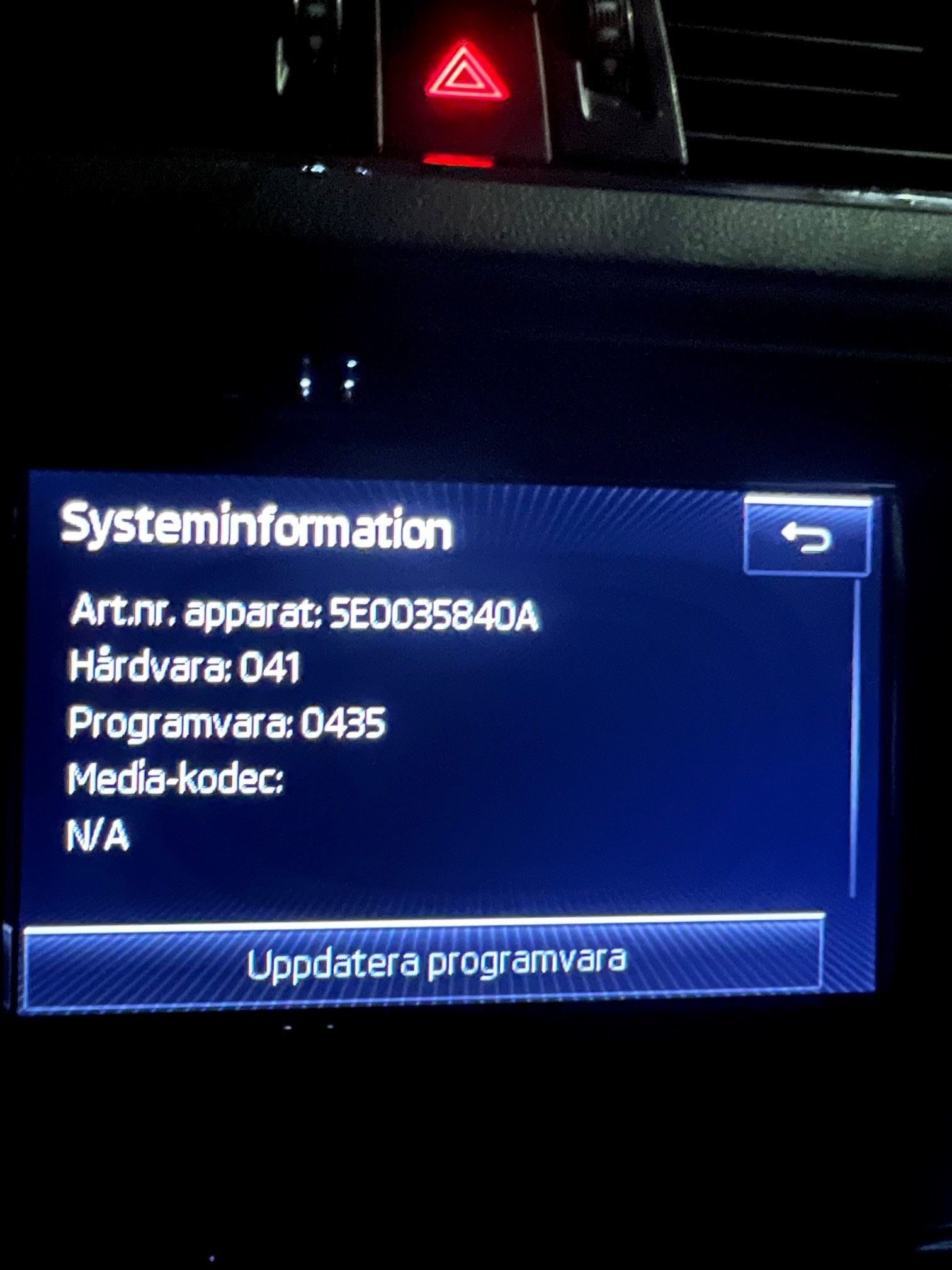

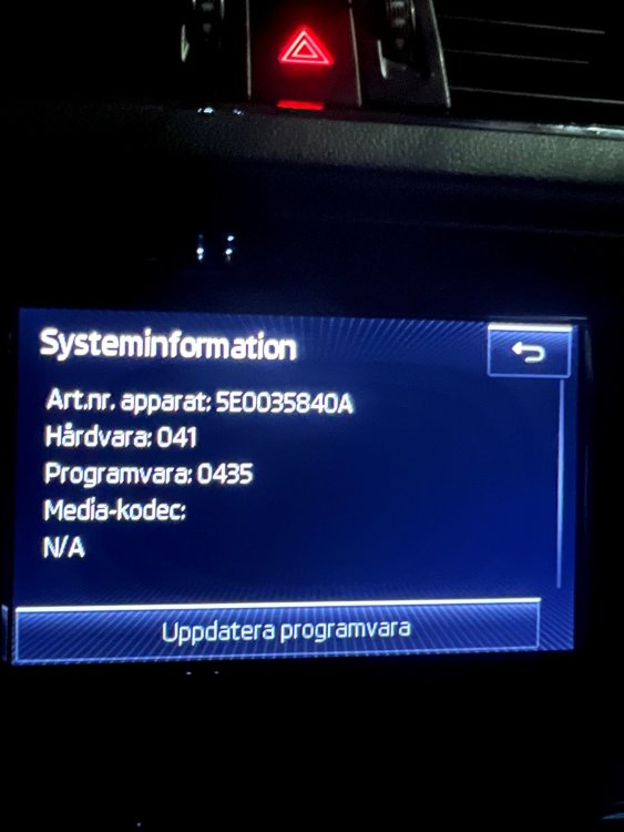

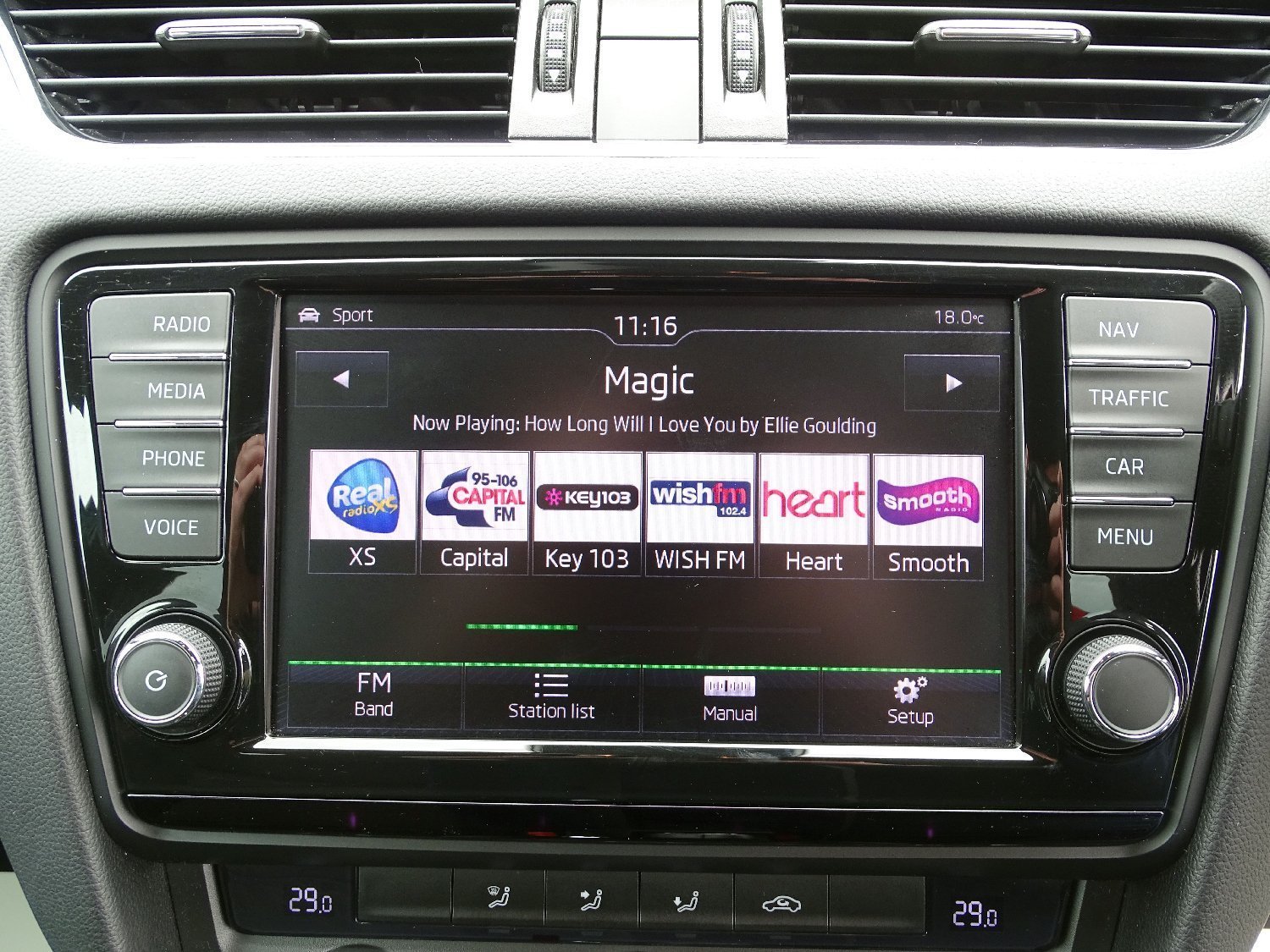

Hi, my Octavia RS -15 has the headunit with the smallest screen, it doesn't even have navigation. I've attached a picture with the model number. The second picture with the larger (8 inch) screen is what i would like to retrofit, preferable with apple carplay. I dont really care for maps/navigation, but it would be a plus. Im guessing i have MIB1 and what i want is MIB2? What model number should i look for? Also, after swapping the head unit in the glove box and the screen, is it just a matter of letting a Skoda dealer do a CP removal and some coding? Also, I have Canton sound if that is worth mentioning.
