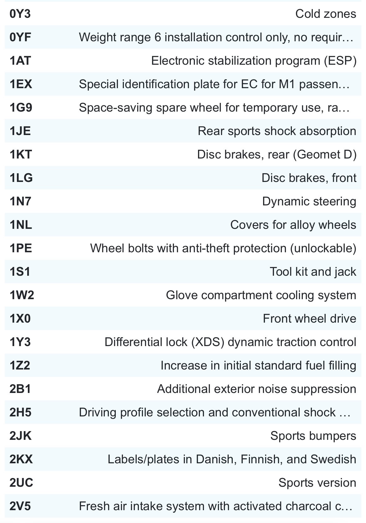

What size brake rotors?
Yes, it says they’re H16, and Philips lamp finder says H7
Thank you so much. Sorry.. but I thought I’d might ask this also: I have bi-xenon with cornering fog lamps that light up when I turn the steering wheel. Do you know what lamp type is in the cornering fog lights? I searched on various lamp guide websites and they’re showing results from H7 to H11 and H18
Thank you sir. Could you also please give me the part number for brake pads front & rear?
Trying to order new rotors and pads for front and rear for my Octavia RS 2.0 TDI -15, and it's showing me listings with sizes anywhere between 270 - 350 mm on brake rotors. Does anyone know which size is correct for front & rear?
