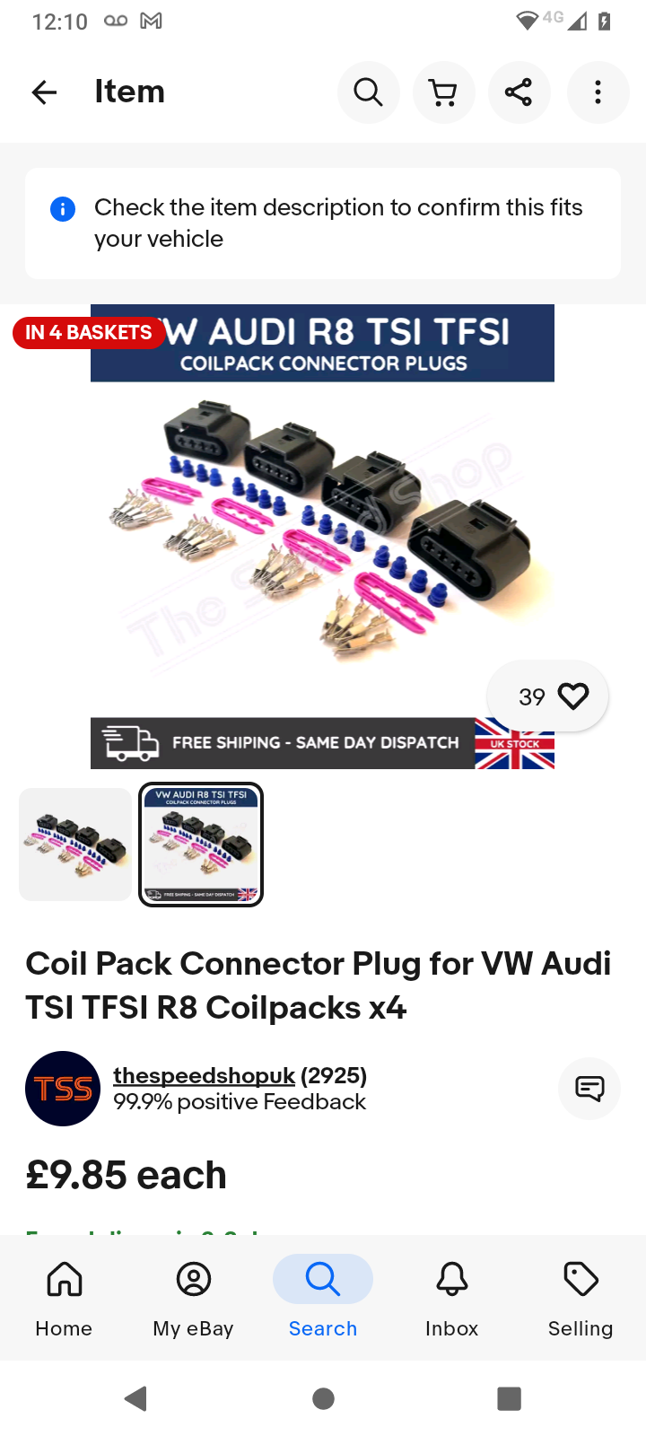

  1. Good afternoon everyone. After doing several ignition coil changes ( I now am using Bosch ones instead of the cheapest available) I have noticed that the plugs are not securely attaching to the coils themselves. I have seen replacement plugs on eBay as pictured and am wondering if it would be possible to remove the connectors with wires from the old plugs and simply refit them into the new casings. I do have a set of connectors removal tools so hopefully this can be done without damaging the wiring. Thank you in advance.
