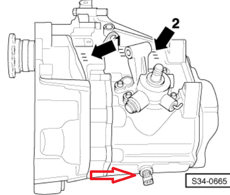

I would suggest looking at the following link showing item 17 which is probably the reverse switch in 2 possible positions. Depending on the actual issue, if it is only the reverse lights do not work, on mine I pulled the plug and used a paper clip in the wiring loom plug which operated the reversing lights with the ignition on. Leaving the plug disconnected temporarily while driving would test if other issues present.
Switches and senders on engine and gearbox Roomster (RO) 2008 year Skoda EUROPA 919040 (7zap.com)

Unplug and then us a paperclip in the socket attached to the car wiring to bridge the 2 terminals, turn the ignition on and look if the reverse light is on. If you have the use of a multimeter it is possible to check for continuity across the wiring tabs in the switch when reverse is selected.
Hi everyone, does the pic above apply to a Roomster 1.9 tdi manual gearbox by any chance? Still have on-going electrical gremlins, but getting there.

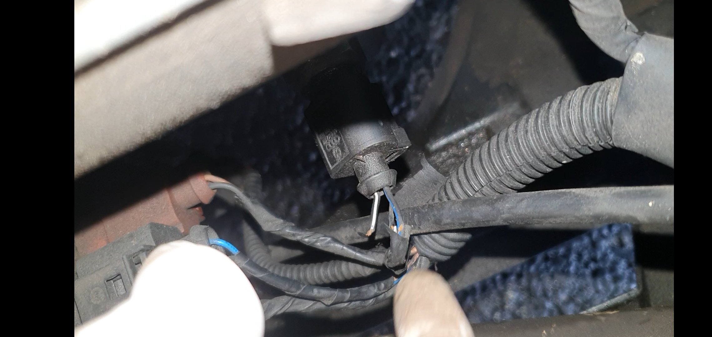

I've finally managed to find the gearbox reversing light switch and the problem, as you can see, there's a broken wire. (Great bit of design, Skoda, putting a thin piece of wire like that in a place where there's going to be a lot of stress and vibration... 🙄 )
Now the idea of trying to get a soldering iron down into there to fix it does not appeal but I'm not sure what else is feasible.
I could (possibly) get the connector off the switch, I think there's a catch I'd have to push down which is, of course, out of sight on the underside (another great bit of design!), however there's not much wire to strip back if I were to try to crimp a connector on to it.
Also I'd probably have to unwrap some of the covering to get to the rest of the wire on the loom side for the other half of the connector which is going to be fiddly.
If anyone else has had a problem like this, I'd welcome suggestions on the best way to proceed from here.

Hiya, have you seen this;
https://www.ebay.co.uk/itm/323974769047?mkcid=16&mkevt=1&mkrid=711-127632-2357-0&ssspo=4AXrxQfvTFi&sssrc=4429486&ssuid=akn2d3NASFC&var=&widget_ver=artemis&media=COPY.
There are loads of those  wired plugs available online, just check the numbers before ordering. If you can get the existing plug off the switch, yes it's fiddly, you're better able to strip back the loom enough to give you enough of the existing wiring to work with. Splicing your new wire on shoul prove easier. Soldering, crimp connections etc will be easier now. Don't worry about the colours on the new plug and tails, so long as the plug fits and there's two wires, you're good to go. If I remember correctly the wires going to the switch are coloured black/white and black/blue.
Looking at your pic above, this would indeed be the case.
Not too much loom chopping required at all.
Ah, now that looks perfect for the job!
I certainly didn't fancy trying to crimp a connector onto about half an inch of wire, but there appears to be plenty of spare lead going to the red plug on the left.
I'll have to try to get the connector off tomorrow to find the serial number and then pick one up off eBay.
Thanks very much for the help 🙂
You're welcome, no worries, let us know how you get on. I don't see why you'd need to do anything to the red plug on the left you mentioned, but that's only my guess. Once you start peeling off the loom insulation you'll get a clearer idea. If you do, could you please post a picture? Just for curiosity's sake and future reference. This seems to be a common fault.😀

Even easier perhaps is to buy an assortment of wired male and female connector pins and a set of depinning tools and then you will also be set up for any future requirements.
If only one wire is broken why replace the plug and both terminals? OK I can answer my own question, if one wire is broken the other may be on its way.
Yes, that was my thought.
Far better to replace the connector with a new unit and crimp on a couple of spade terminals than risk fixing just one side, only to find the other side or the OEM connector fails a little further down the line...
