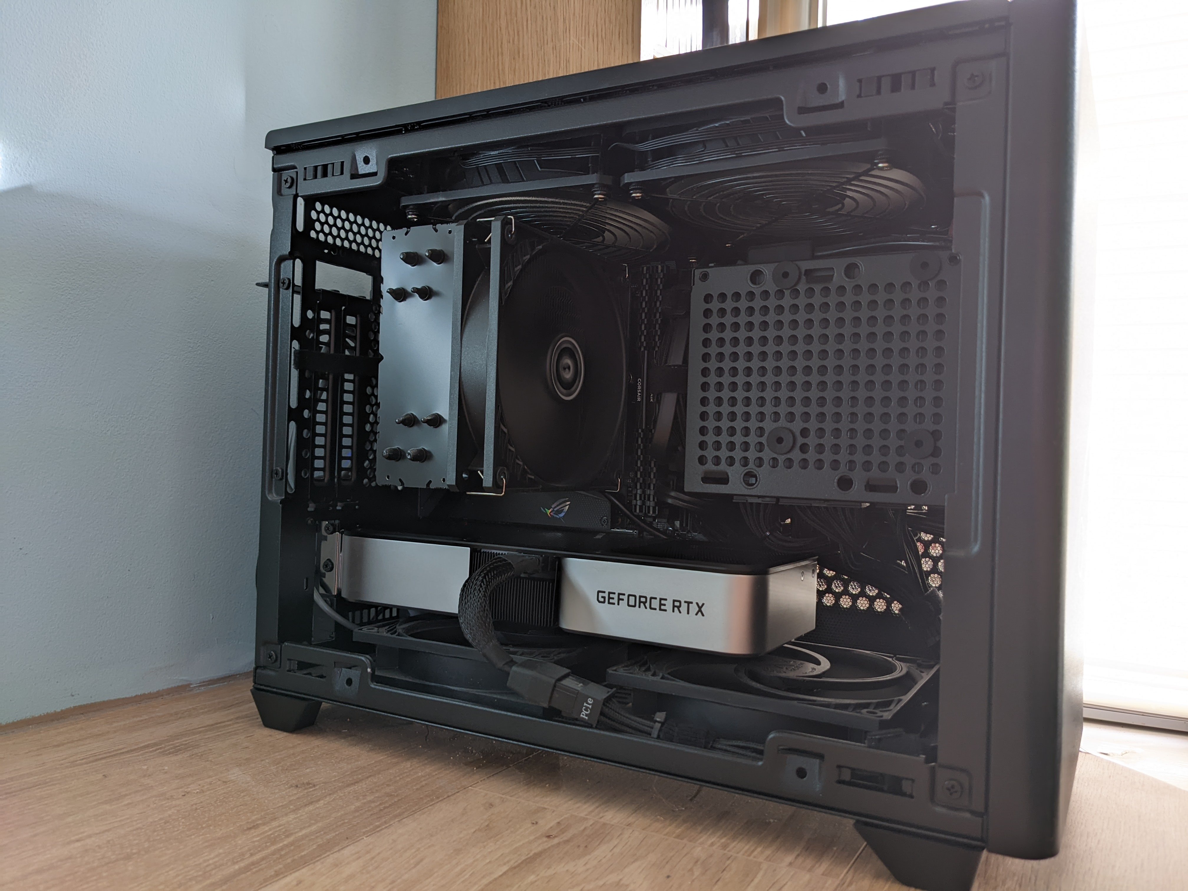

  1. No, the AM4 holes have a rectangular pattern and the cooler fixes across two arms so you can't rotate 90. You can eliminate the GPU heat by switching to rear intake and lower temps however there's no rear dust filter by default so that setup will increase dust build up over time and I don't really want to be forever cleaning it. Given that the temps are more than fine I've not worried about it though. They're relatively low power components (65w CPU and 200w GPU) so shouldn't really be an issue. The GPU is half blower style too so 50% of the heat gets thrown out the Io shield.
  2. Update: Finally got myself a 3060ti FE at RRP. Replaced the HDD with another SSD for silent running. It's a pretty decent spec now and so quiet too.

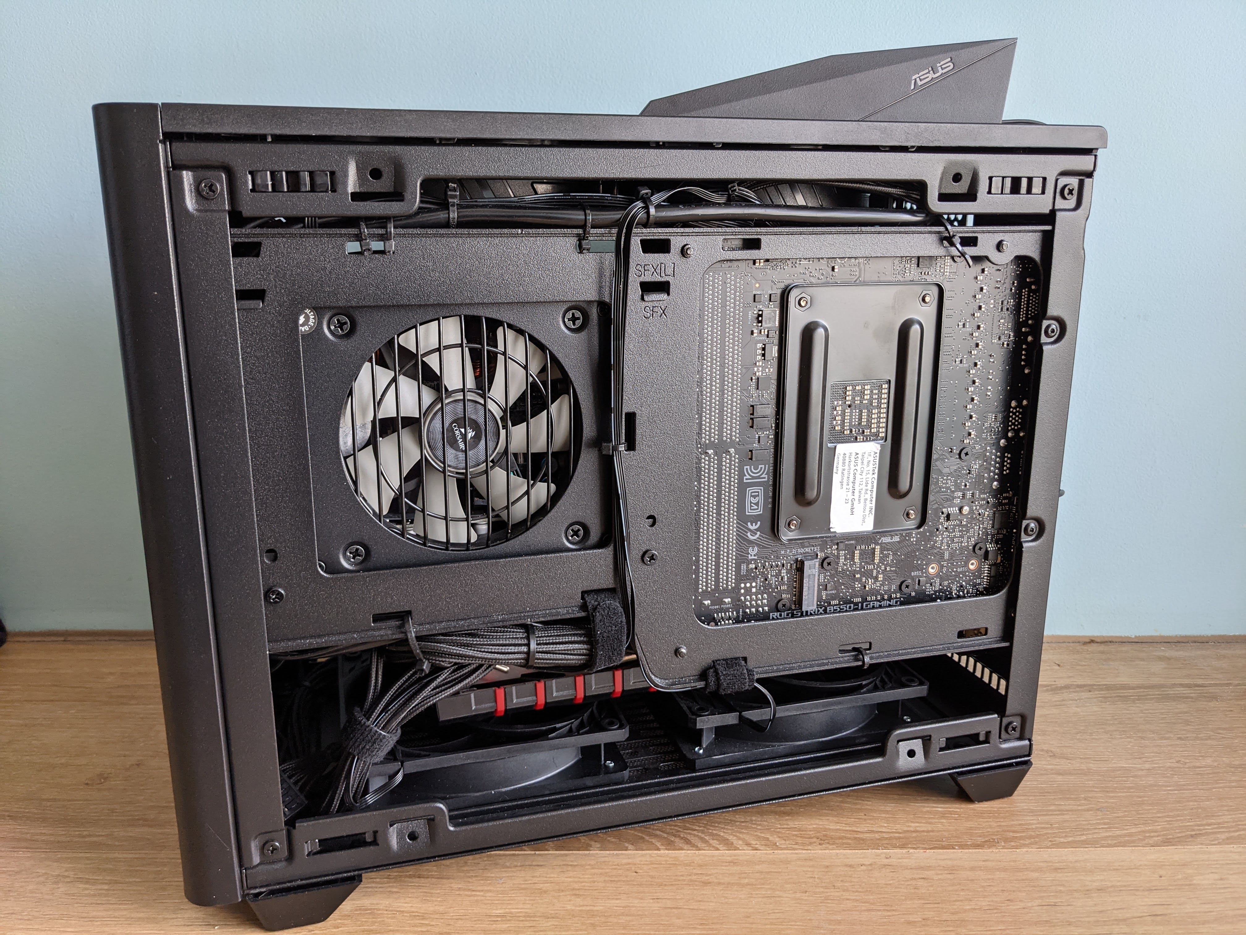

  4. Yeah, it's not there for aesthetics, there's not really anywhere else to mount it, it's magnetic but doesn't stick to the back as well and the case will then reduce signal anyway so that's just the best location. I could run it elsewhere but I move the PC around and use it downstairs regularly so it's nice to have it all contained, so it just works.

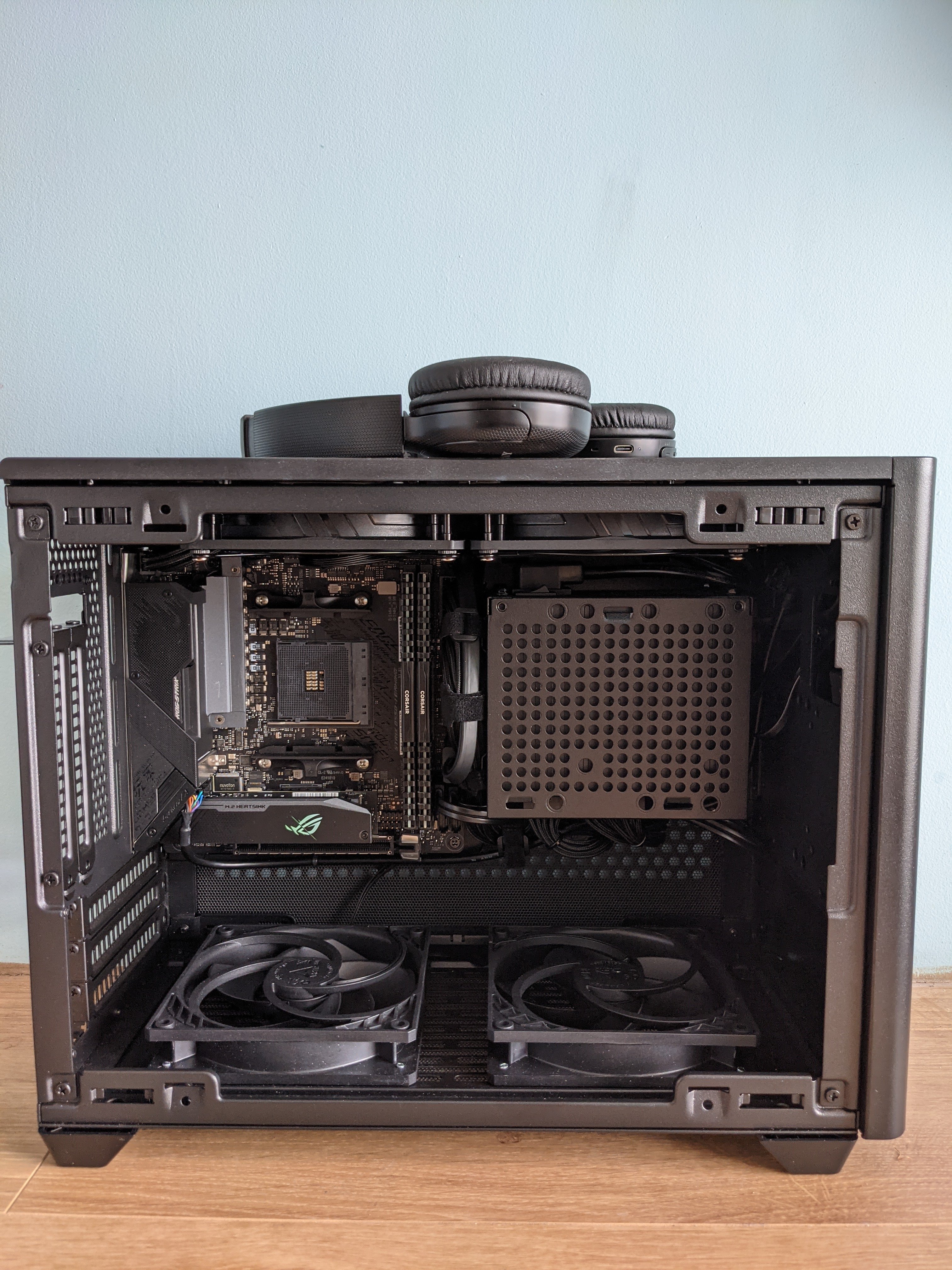

  5. This photo better shows the fans pre gpu/CPU/cooler

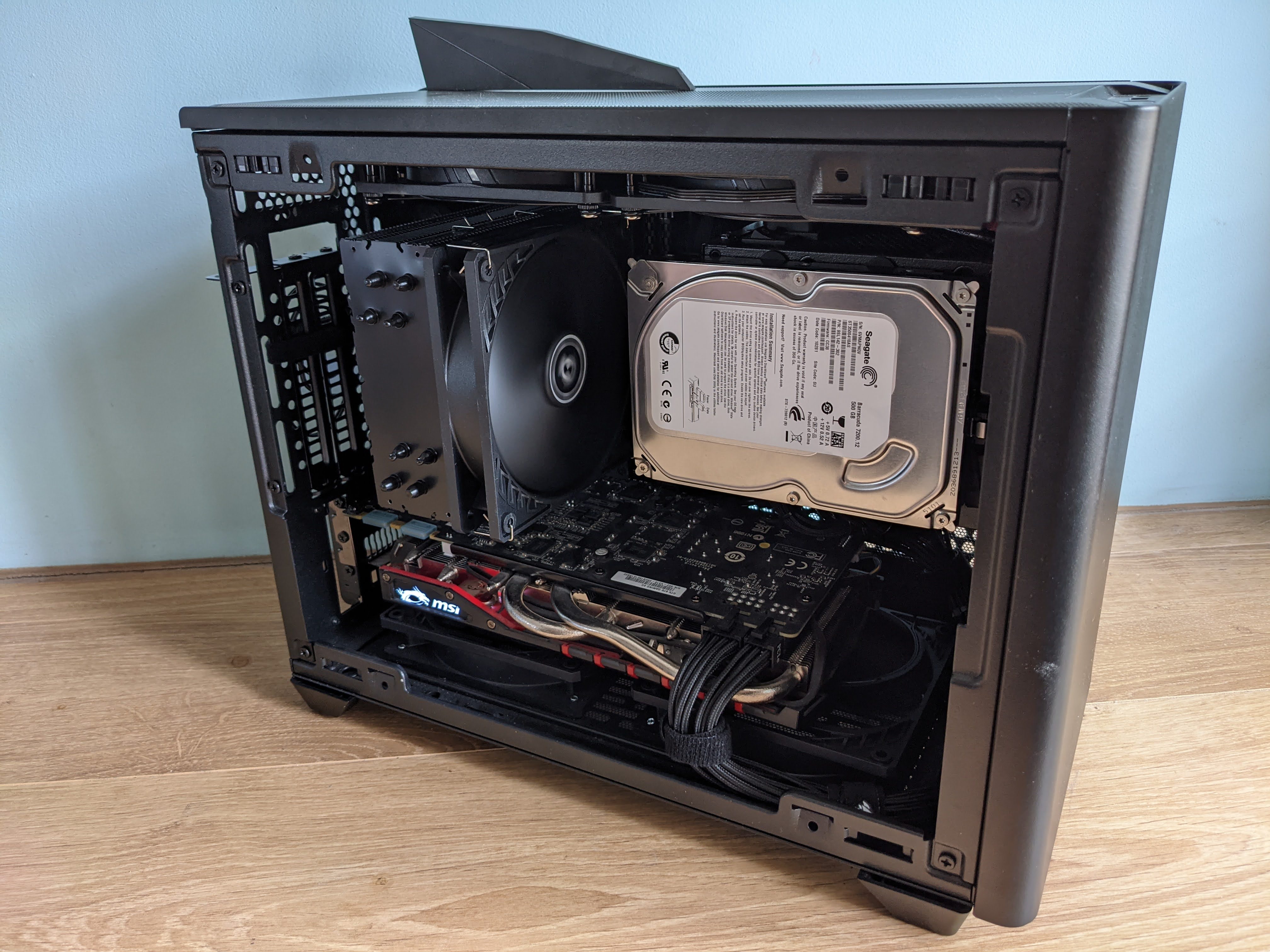

  6. Behind the HDD is just the PSU, which is pulling air in from the back of the case (vented panel) and pushing it out the top of the case. The PC is on in the picture, however the PSU stops the fan altogether at low loads. The two P12s are at the bottom, under the gpu and there's 2 cooler master sickleflow fans at the top that came with the case, so the general airflow is bottom to top. The additional P12 on the tower cooler (I swapped out the stock fan as the p12 is quieter) presently exhausts out theb back yes, however I may swap to rear inlet so it gets fresh air rather than warm air from the gpu. Temps are good though. Under gaming loads the CPU temp maxes out at maybe 65, even with the rear exhaust config. Under stress test on the cpu it also reaches around the same (no gpu). Idle is about 37 degrees. I originally had a 3600 in there before the the 5600x and the latter dropped temps by about 10 degrees across most of the range. The case also came with a vented side panel as well as glass and you can mount additional fans on there or an aoi if preferred but that's overkill for a 5600x.
  7. So, as an update, I built this: Asus B550i Motherboard Ryzen 5 5600X CPU ID Cooling se224XT Tower Cooler Adata 1TB NVME Corsair SF600 PSU MSI GTX970 GPU (Second hand one from a friend as you can't buy anything newish right now) Cooler Master NR200P Case 2 x Arctic P12 fans There's my old SSD/HDDs in there too. They'll be replaced in time. I got the 5600X in the end, not for performance now as I'll never notice that but more than it'll just last longer and as there's no more AM4 generations I'd rather what I have last as long as possible. Pleased with it though. Under non gaming loads it's silent. When playing games it's still quiet. All stays cool, it's compact, does what I need it to. Shame I couldn't get a new GPU but I'm playing older stuff right now anyway and the 970 copes fine. Eventually I'll upgrade.
