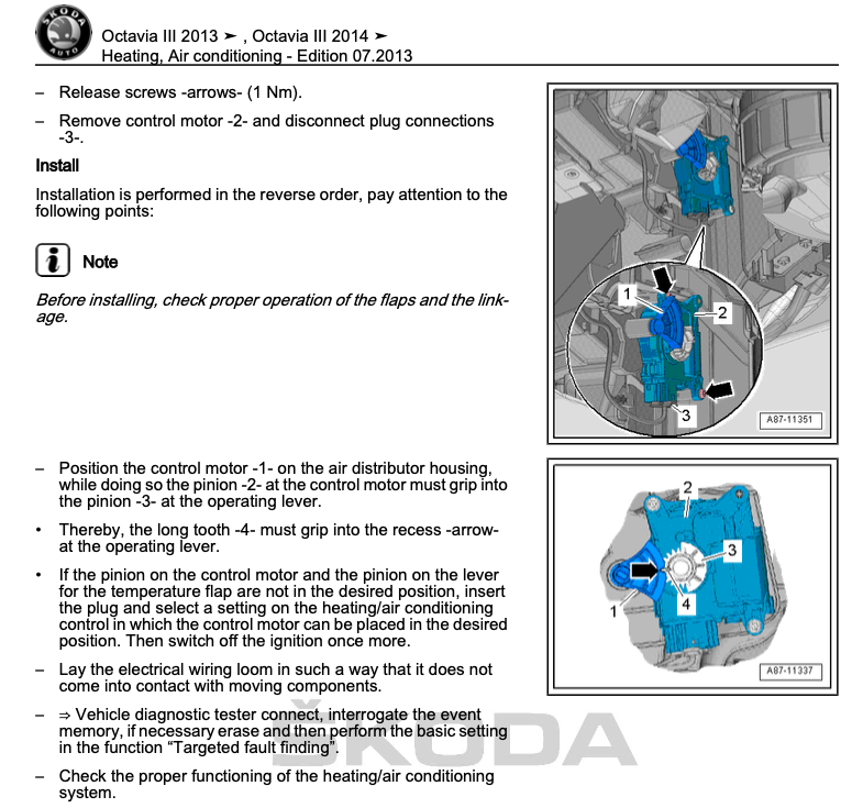

  7. That is correct, it controls the "mix" of cold and warm air in order to make the correct temperature. There is one on each side (driver/passanger). No idea why would it work better when rotated 180 degrees. If the rotor moves up/down, then maybe when you turn it upside the brushes get better and more reliable contact and hence it rotates nicely? But this is just a guessing game at this point.
  8. I assume you put back the white gear pinion that fell out, just for the sake of not having another set of issues beside the blower. Re blower, sounds like it's on its way out. It behaves the same outside the car (if I understood you correctly) as it is when its in place and oriented the way it should be. And when opposite, it works as usual and does not get tired. This would indicate (to me at least) that there is something physically wrong with it. Maybe try and clean and lube the spindle? Also, check there is nothing that could physically obstruct the operation of the motor. Or give it to someone who has the bench and expertise for motors to take a look at it.
  9. This is the temperature flap control motor. The part that fell out is one of the pinions.
