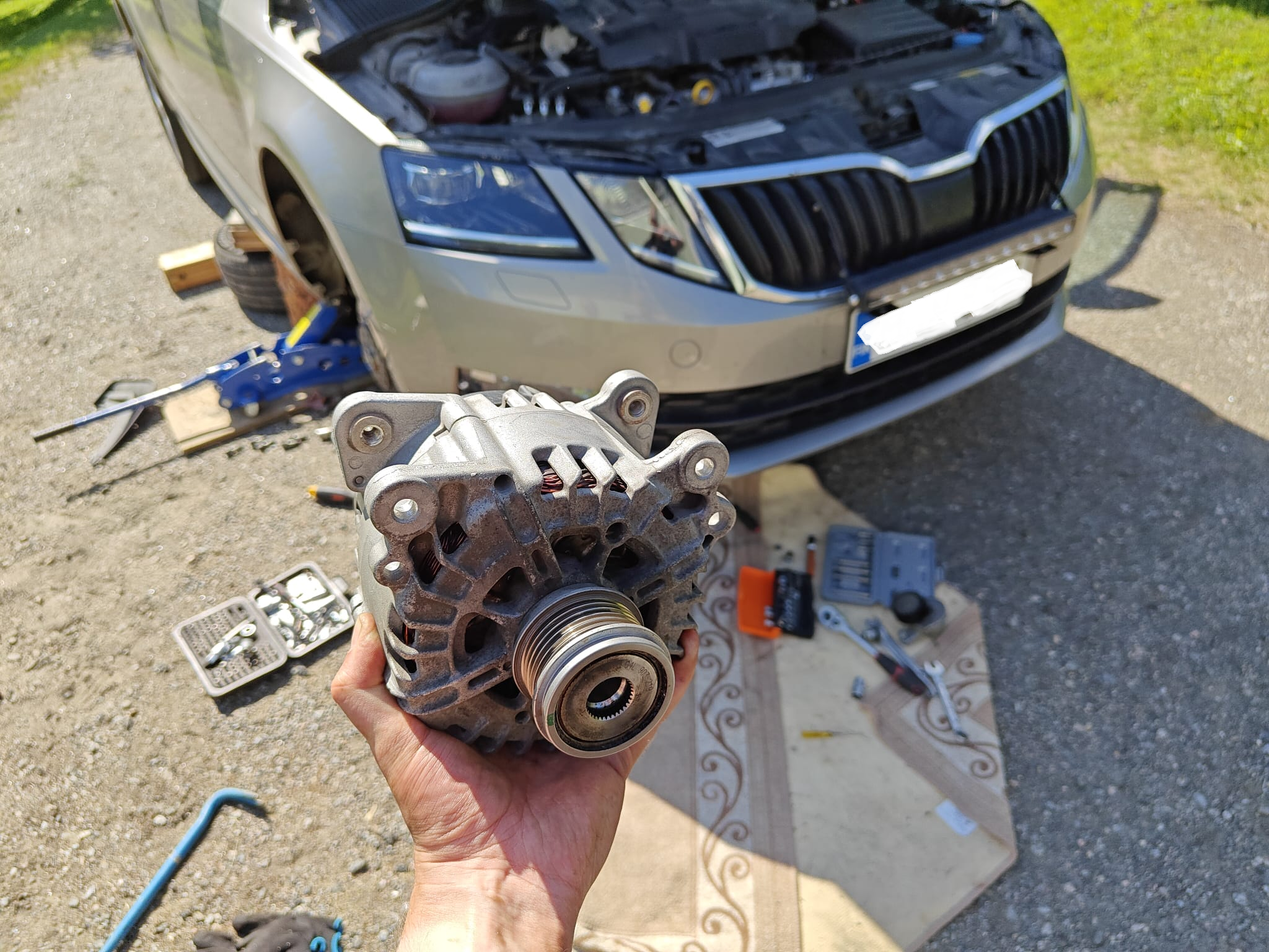

  13. And the original issue still persist even with the new alternator. Voltage fluctuates between 12.2 - 15.0V after startup and eventually stabilizes...
  14. Car repair shop refused to fix the alternator for warranty! For some reason battery coding said 80Ah instead of 70Ah. They said it caused the alternator to burn. I have no idea why battery capacity said 80Ah since I coded it several times and I'm 100% sure it was 70Ah. I also doubt 140A alternator will explode if it has to charge 80Ah battery. The shop quoted 1000€ for the alternator replacement. Even though I had the car towed to the shop, I just drove it home without serpentine belt. 2 hours and I had removed the alternator. I can't find anything wrong with the bearing or freewheel. I will get the replacement alternator tomorrow for 265€. I hope it fixes my charging issues.
  15. It came from the alternator freewheel. The seal was detached and the freewheel shot all the lubricating oil on to the fuel filter housing.
