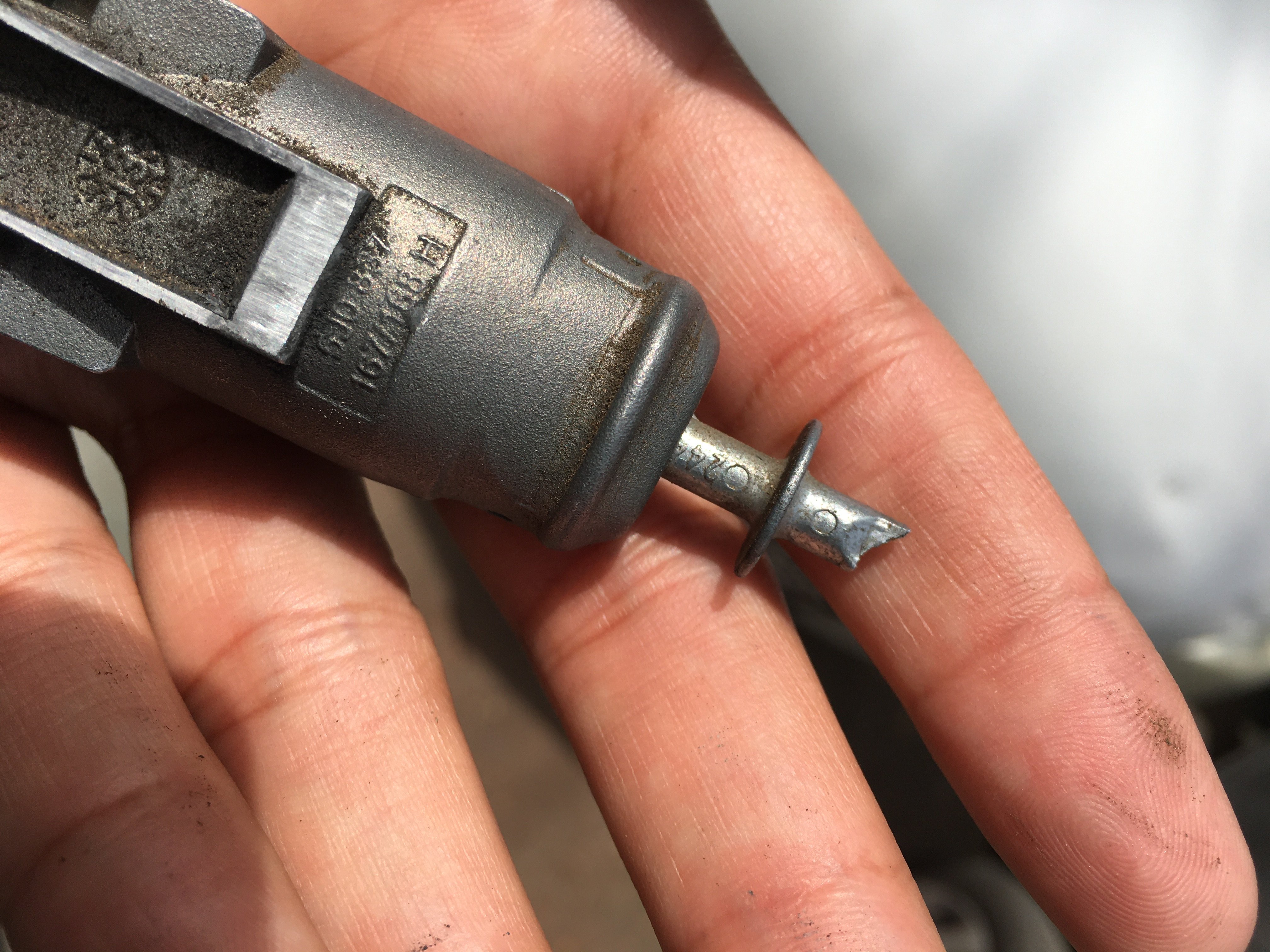

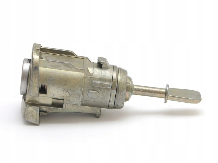

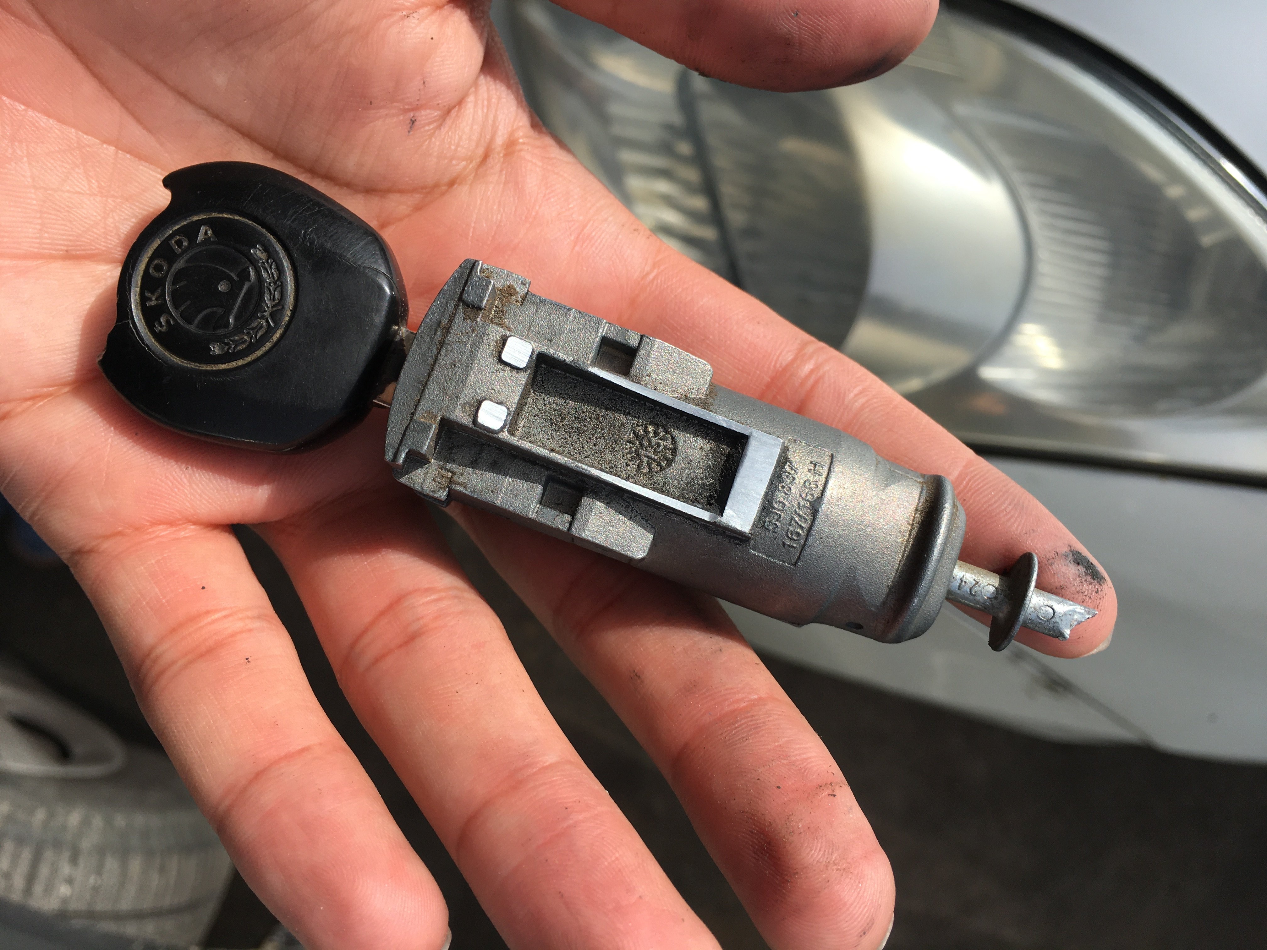

Update-Issue has been resolved (Temporarily) . It turns out that Front part of my locking cylinder was broken which looks like While brand new looks like- The part was not available, so I just interchanged the locking cylinder with the passenger side door (Which was working). Will replace the lock when the part is in stock. Thanks for help. -
