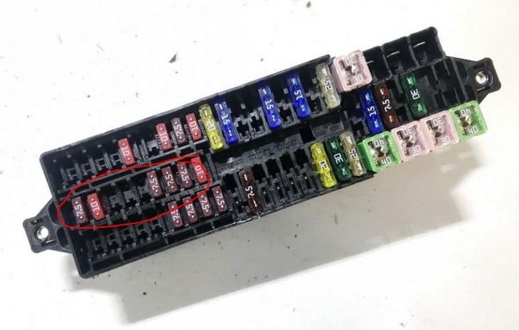

Anyway, I found my way through the problem by bringing a switched 12v line directly from the fuse box.
I marked in red in the picture below which like of fuses are switched 12v.
If you remove the two torx bolts, the fuse box drops enough to allow you to remove the back cover and access the fuses from the back, so you do not need to pin-in the cable from the front.
Then I added a 15A fuse to my cable, brought it up to the radio and I fixed it so it doesn't move around.
Finally, I removed the 12v pin (yellow cable) from the radio ISO connector and I connected it to the switched 12v cable that I brought up.
And problem solved! No more current drainage, as this line is immediately switched off when removing the ignition key.
I have the same problem. Could you please explain this step.
