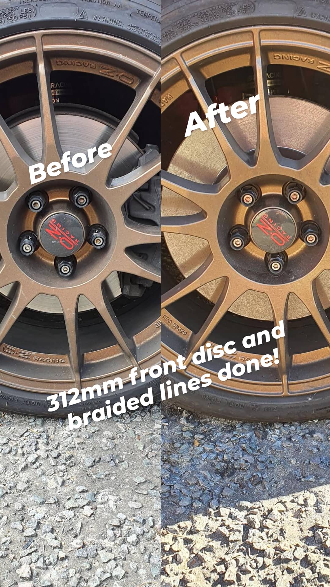

Little update with my build, I folded and ordered an rtmg turbo and carbon intake. I fitted the turbo last week and tomorrow I'm taking a trip back to my tuner to get a cuatom map for it. Was at 183bhp and 296Nm on the 1.4 turbo. Not really expecting a massive leap, my 1.4 turbo was 2nd hand and I was getting a bit nervous about it not blowing up (know of 2 doing so fairly recently) but it was running really nice. I have absolute faith that Leon at Road Rage Performance will work wonders with the new hardware. It will be ready by the end of the day tomorrow but for logistical reasons I'll pick it up Wednesday. In other news, I completed the 288mm to 312mm front disc upgrade. I used nearly new discs and pads from a member of another group that had upgraded to a BBK on his mk1 Octavia VRS, carriers from a mk1 1.8 TT off eBay and some Hel braided lines. It feels OEM but with massive stopping power when you press on. Plus they fill the wheels better, just need to paint them now.- Turbo Swap Choices for EA211 1.2 TSI

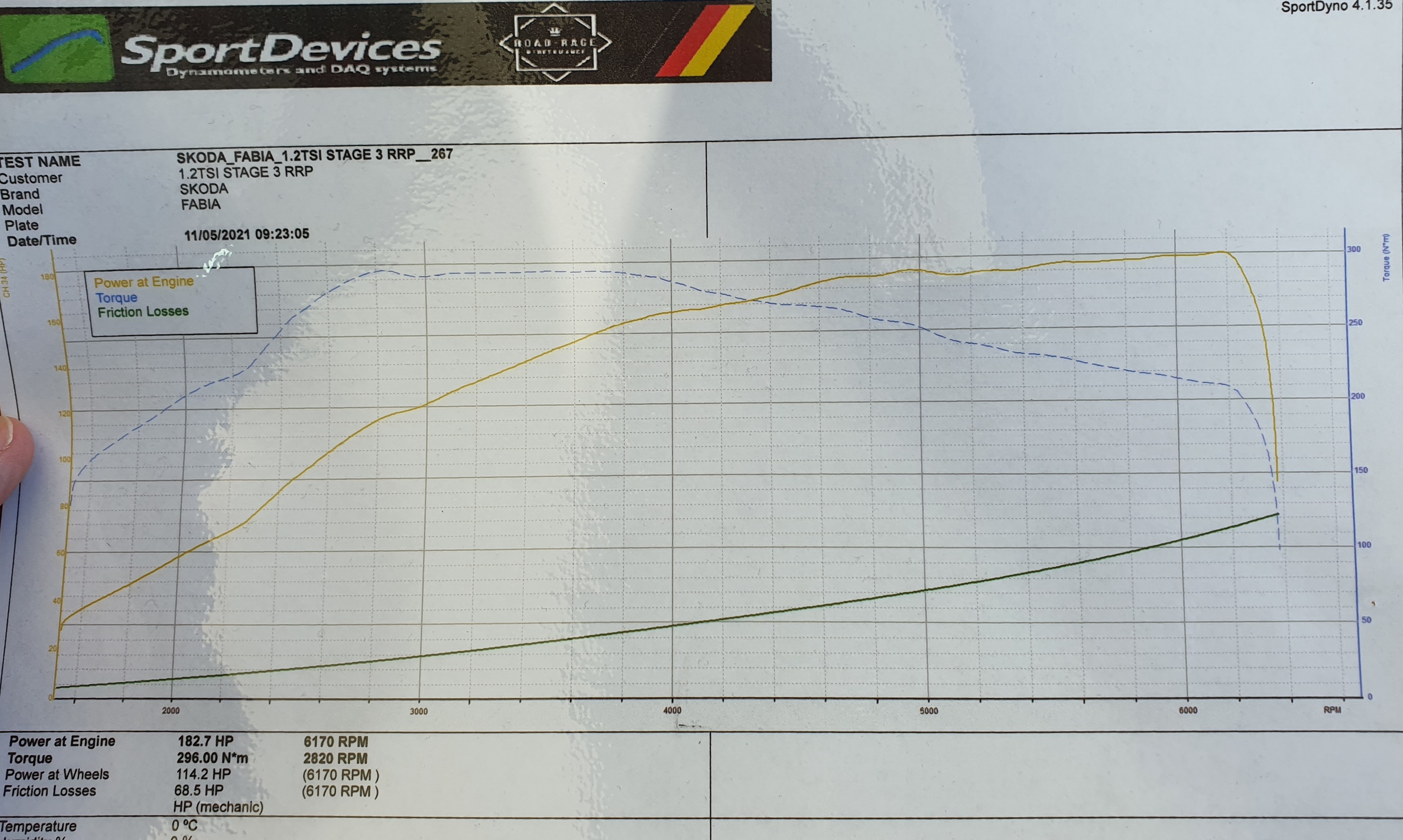

Latest dyno print from Road Rage Performance after my visit today. Since moving premises and changing his dyno he's found his old setup overread torque so my old peak torque of 336Nm was inaccurate. Since then I've added a DIY cold air feed, MST turbo inlet and the big change was the 2.5inch turbo-back exhaust with sports cat. I'm now seeing peak bhp of 183bhp @ 6170rpm and 296Nm @ 2820 - Turbo Swap Choices for EA211 1.2 TSI
