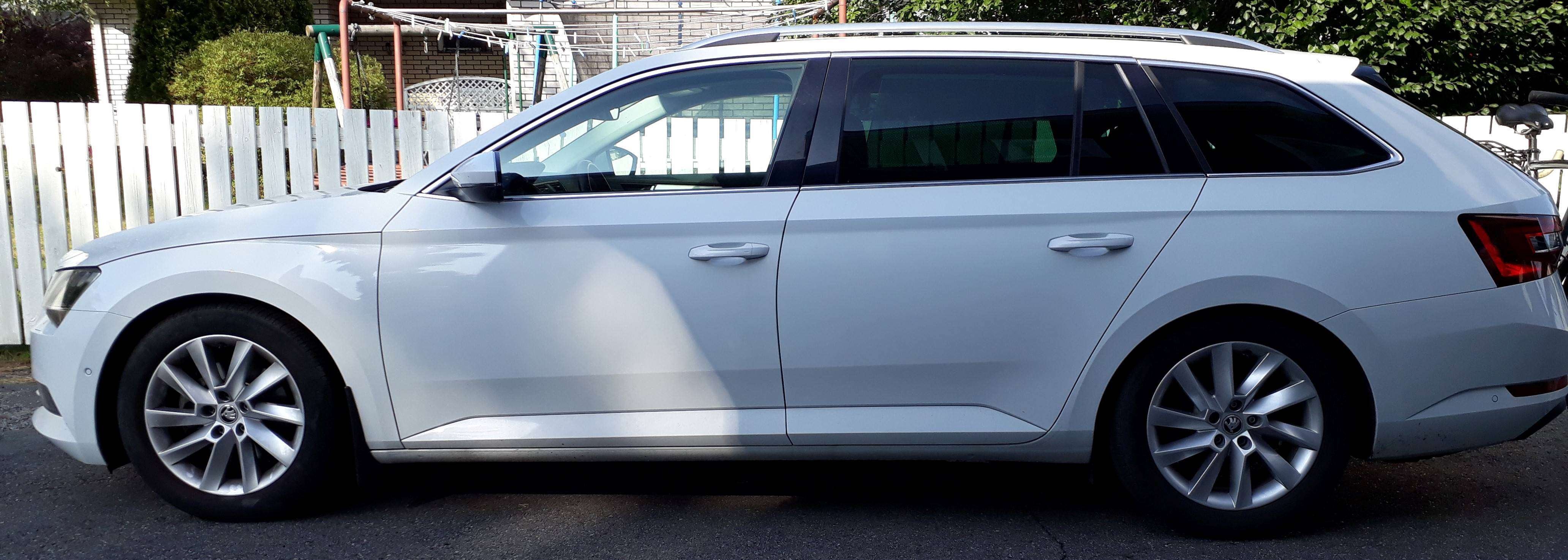

Rims are 19x8,5 ET35. I would say it will be quite a tight fit in the back with 9,5" ET35 at least if you try to keep the rim inside the fender. I can take better pics how close these are to give you better view. -

I had a call with wheel sales and they told 9,5" is too wide at least for front. So I'll go with the 19x8,5. And wheels I am planning are these. -

Hi, Would need some advice what size wheels & tyres to choose for the coming summer to replace original 17". I have couple options in my mind and would really appreciate if someone has the knowledge and can even share some pics of the below options. I have also Eibach -40mm lowering springs in place. 1. 245/35R20 tyre with 20x8,5" ET35 2. 245/40R20 tyre with 19x9,5" ET35 Option 1. will fit for sure but I would prefer the option 2. because of the bad roads here :) Just not sure if that would fit.
