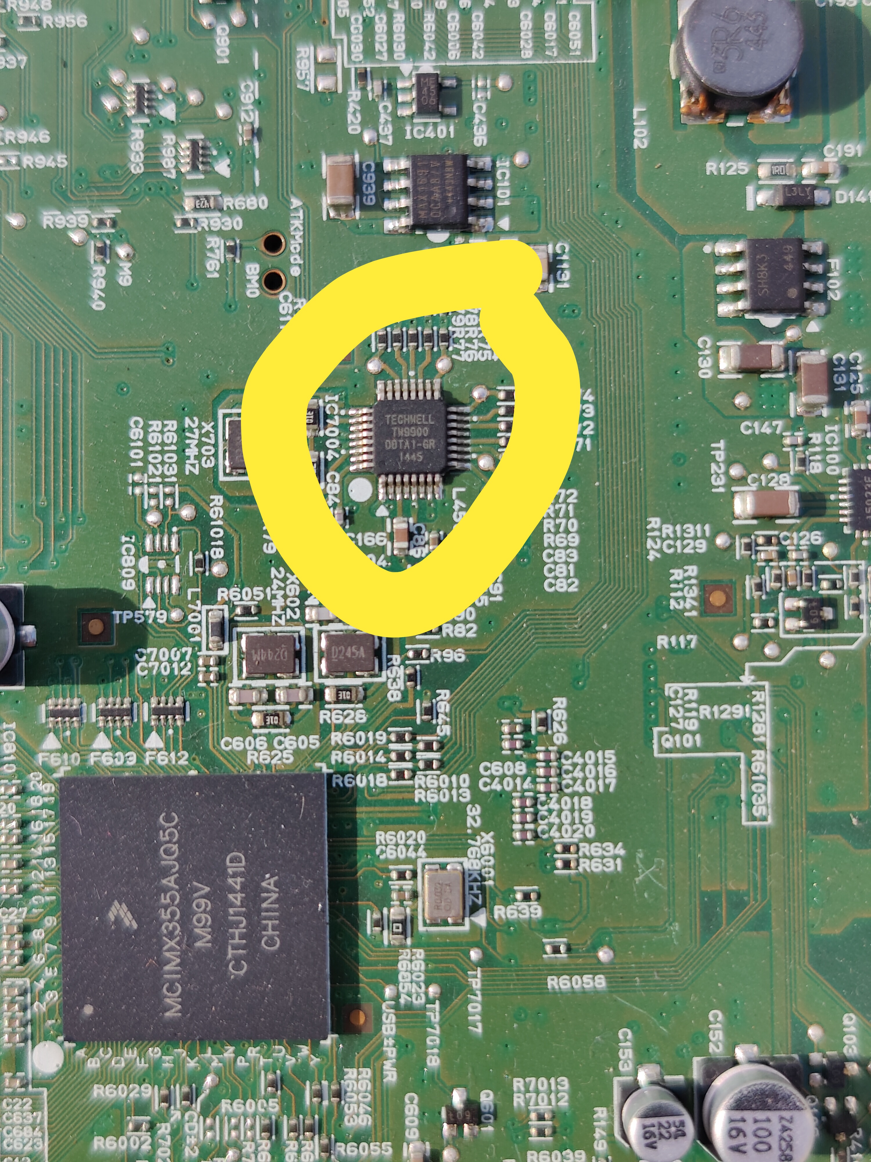

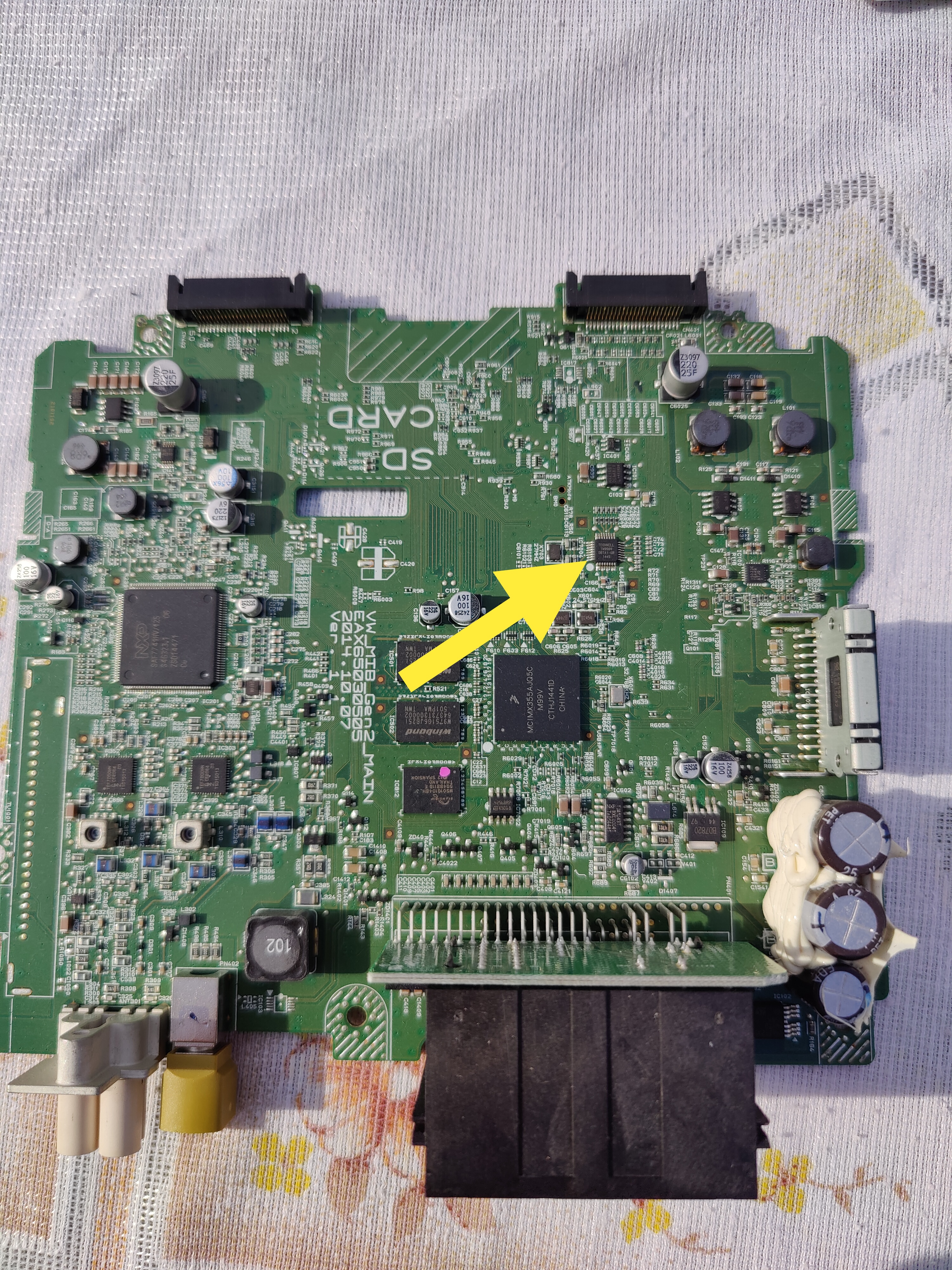

  8. Mine is welded on the board, without a socket. You can read the code from these pics. My 5F - LCH is also blank, but I have triple checked to make sure that the byte and bit work in my MY.
  9. Hi! As I said in my last post, my 5E0 035 871 A (MIB_Gen2) is compatibile. My HU is rather old, but to my surprise had the video processing chip. Yours - the 5E0 035 871 C newer Swing - seems to lack the chip and the video signal. The only way to be sure, is to unscrew it, but judging by the signs it doesn't, as it should have worked right out the box. Anyway, I also coded it to make sure: M5F-Information Electr. Coding-07: LCH -B19: enable b4 Depending on the MY, there might also be another one: M10-Park Assist Security-16: 71679 / 20103 Coding-07: LCH -B03: b4-5 – enable (10) RVC installed Good luck!
  10. Hi! Check if you have the TW9900 chip. That was the only way I was sure that my 5E0 035 871 A (MIB_Gen2) is compatibile. My HU is rather old, but to my surprise had the video processing chip. The C newer ones seem to lack the chip and the video signal. So, to sum it up: after I was sure that the HU has the chip I ordered the ~90mm camera, as it was the only one fitting. As a sidenote: it was missing a screw, but I improvised. Good luck!

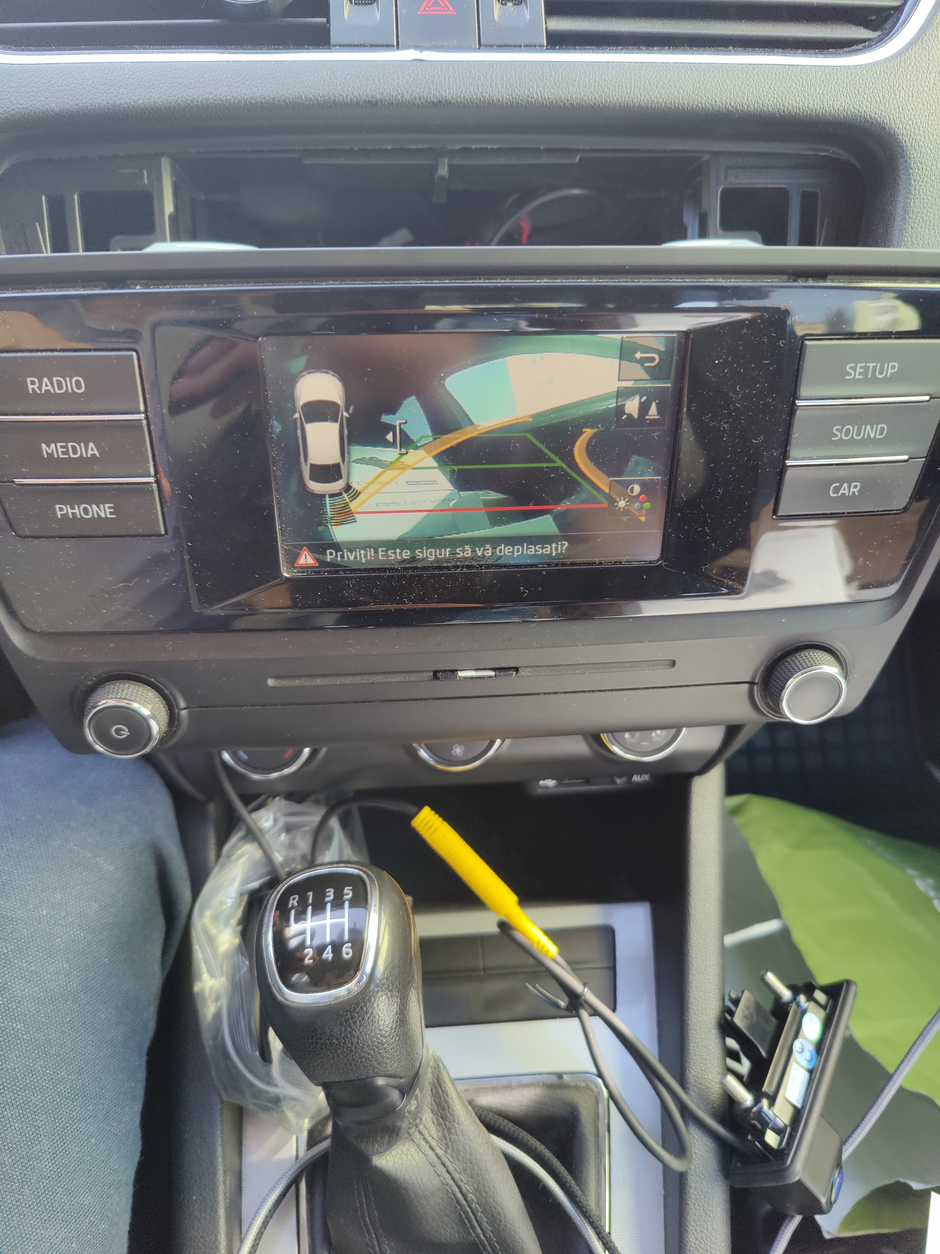

  14. Lo and behold:) my 5E0 035 871 A (MIB_Gen2), without glove-compartment unit(!) is compatible with a reverse cam. The worse is yet to come, but I hope I'll manage to install it swiftly. Glad we got that out of the way and I hope it will help others too! Thank you guys and especially you langers2k!
  15. (more than) happy to report that my 5E0 035 871 A (MIB_Gen2) has the TW9900 chip. I'll order the cam and return with info if and when I'll set it up.
