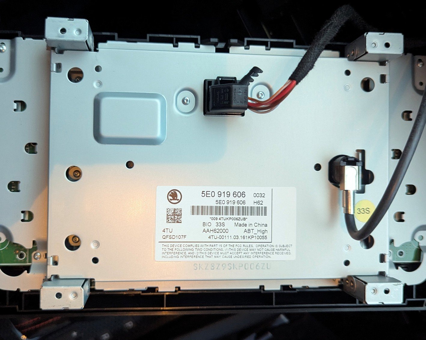

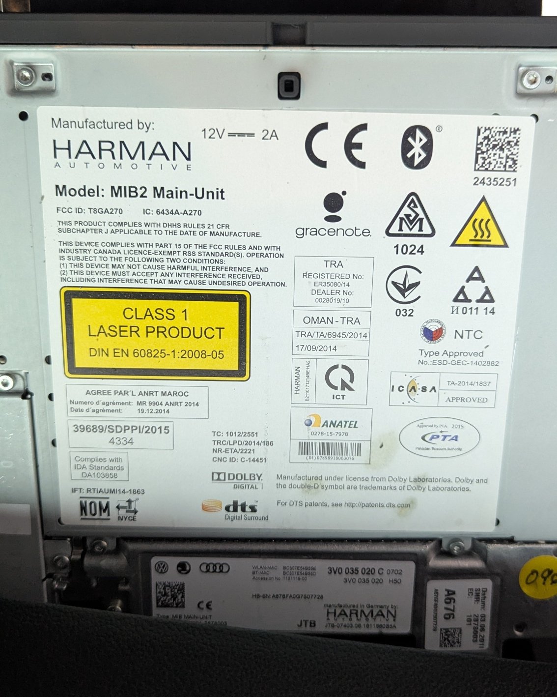

  2. First started considering it for the nicer, smoother and more modern look but also hoping it may improve some minor connectivity issues with ny wireless AA device...and perhaps some extra features.
