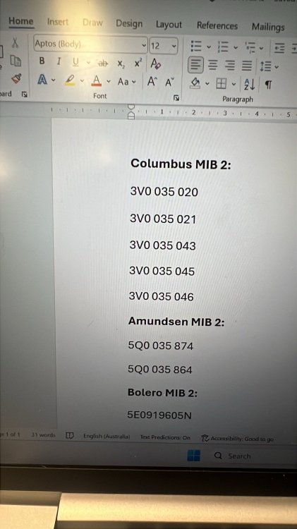

After a lot of struggle I have figured out the easiest way to do this.
Follow the 3 steps below:
  1. Get a used MIB 2 unit and install (this is the unit in glove box) below part numbers are compatible:
  1. Get a FAT32 SD card - normal size
  2. Go to mibsolution.one and download the following file onto your SD card: MHI2_ER_SKG13_P4256_1_AIO_MU1440_20230504
    location would be in : mib>MQB_Solution>MHI2-Harman >Skoda
  3. Slot SD card with that file and do a software update
This All in one patch file removes component protection and installs all relevant features.
Spent a fair bit of money and effort to find out this is the easiest and most effective solution.
Feel free to reach out if you have any questions.
