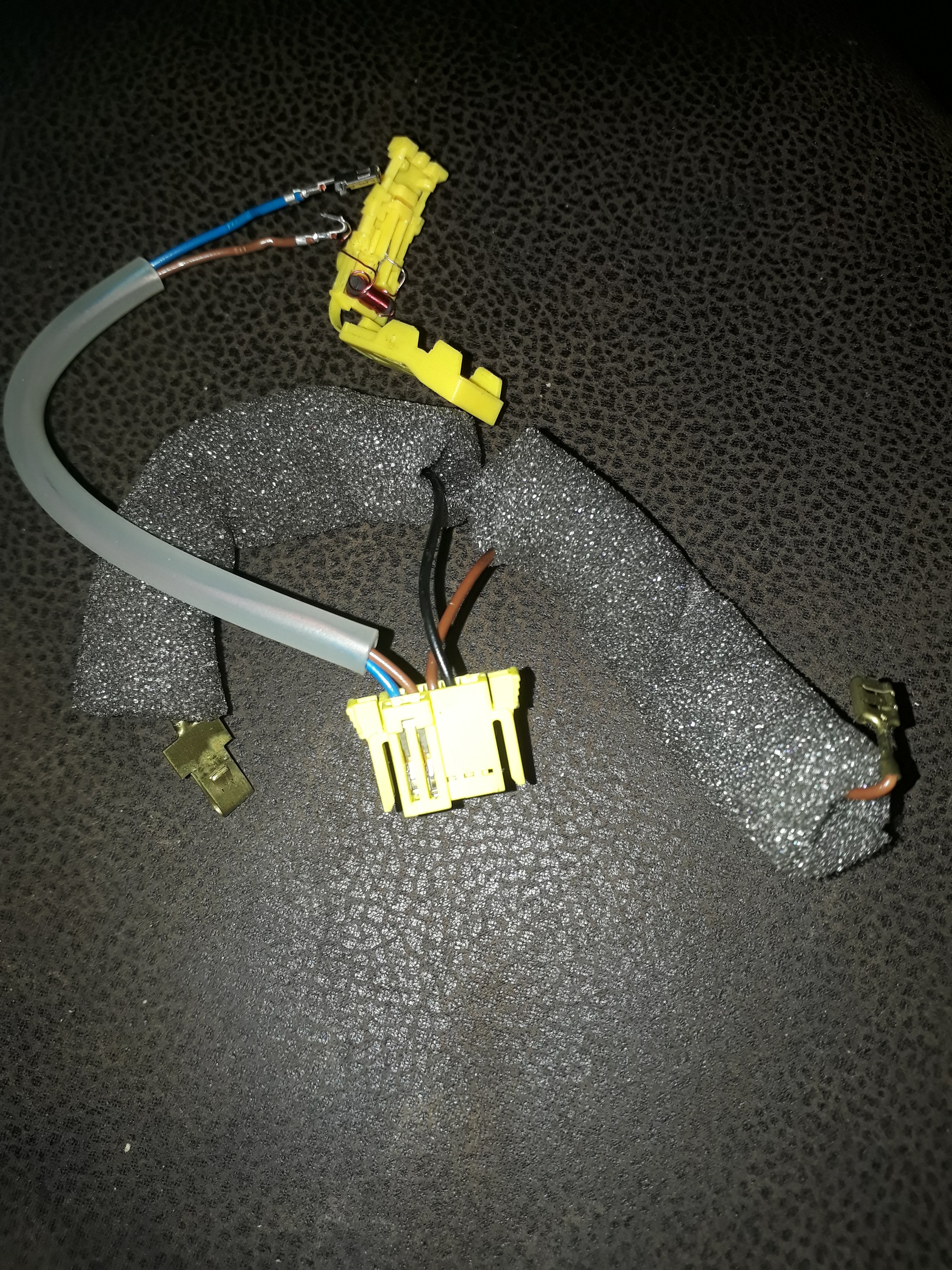

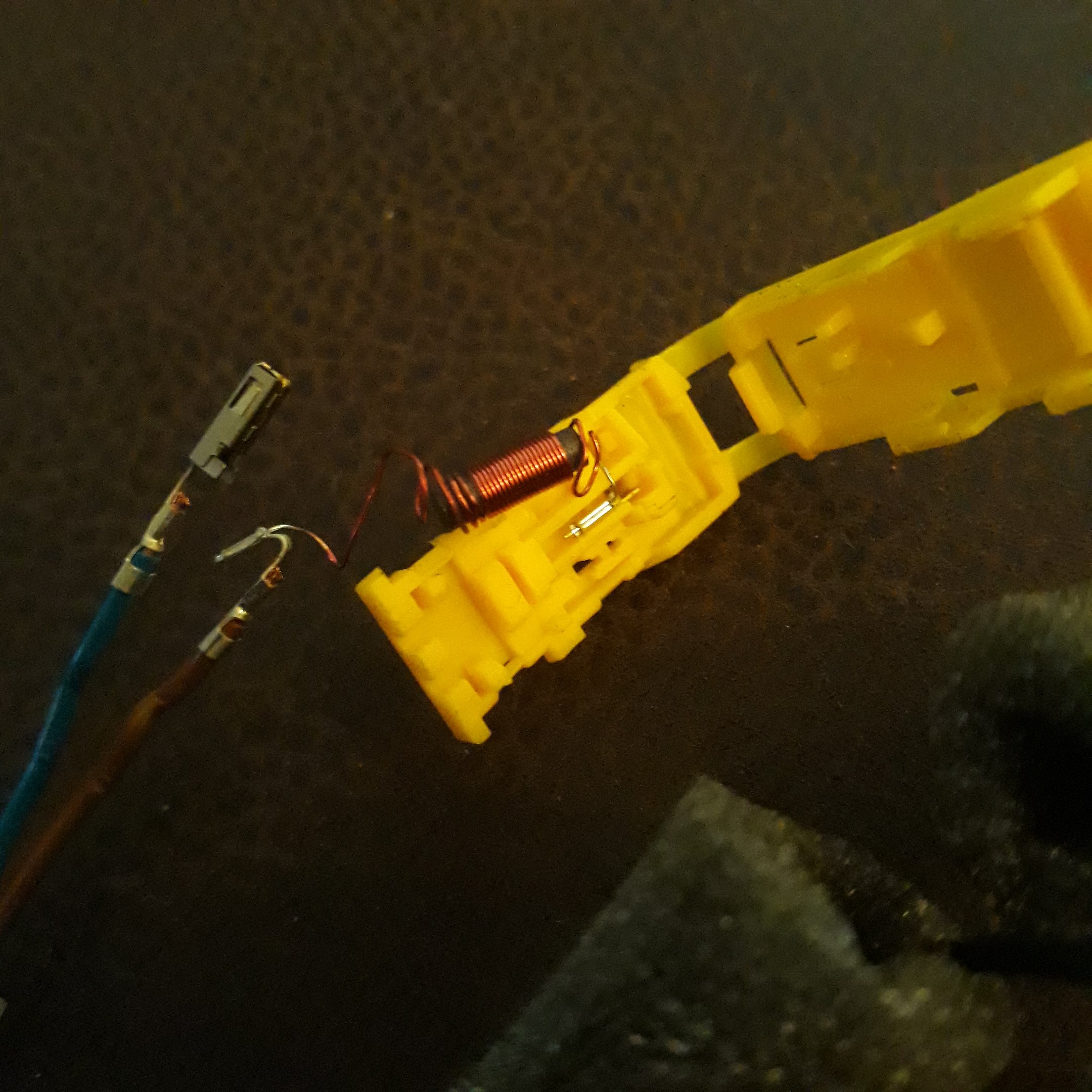

VRS steering wheel install
Hi guys I have acquired a VRS steering wheel to fit to my MK1 Fabia. When I unclipped the airbag from it the airbag slipped out of my hand and pulled the wiring harness which then sprung apart the airbag connector as can be seen in the photo the red tiny wire has uncoiled. I checked the wiring harness on the old wheel and it is different so cannot use it for this wheel. So going have to try and source a new cable I think. I don't suppose anyone would happen to know the part number for this please. I have looked on eBay and cannot find one that looks right. Many thanks in advance ð
