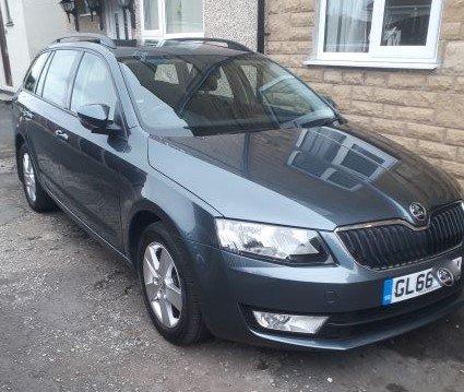

  1. I've got a 2016 1.6 tdi. Car came with a moll battery from factory and was knackered about 3 months before the end of the 3 year warranty. Apparently there was a service bulletin about a duff batch and when I asked Skoda about it they replaced it under warranty with a Yuasa one I think. It's been fine ever since, although the first thing I do before driving is turn off the stop start as it's a pain in the ass coupled with the DSG when pulling out at roundabouts etc 😁

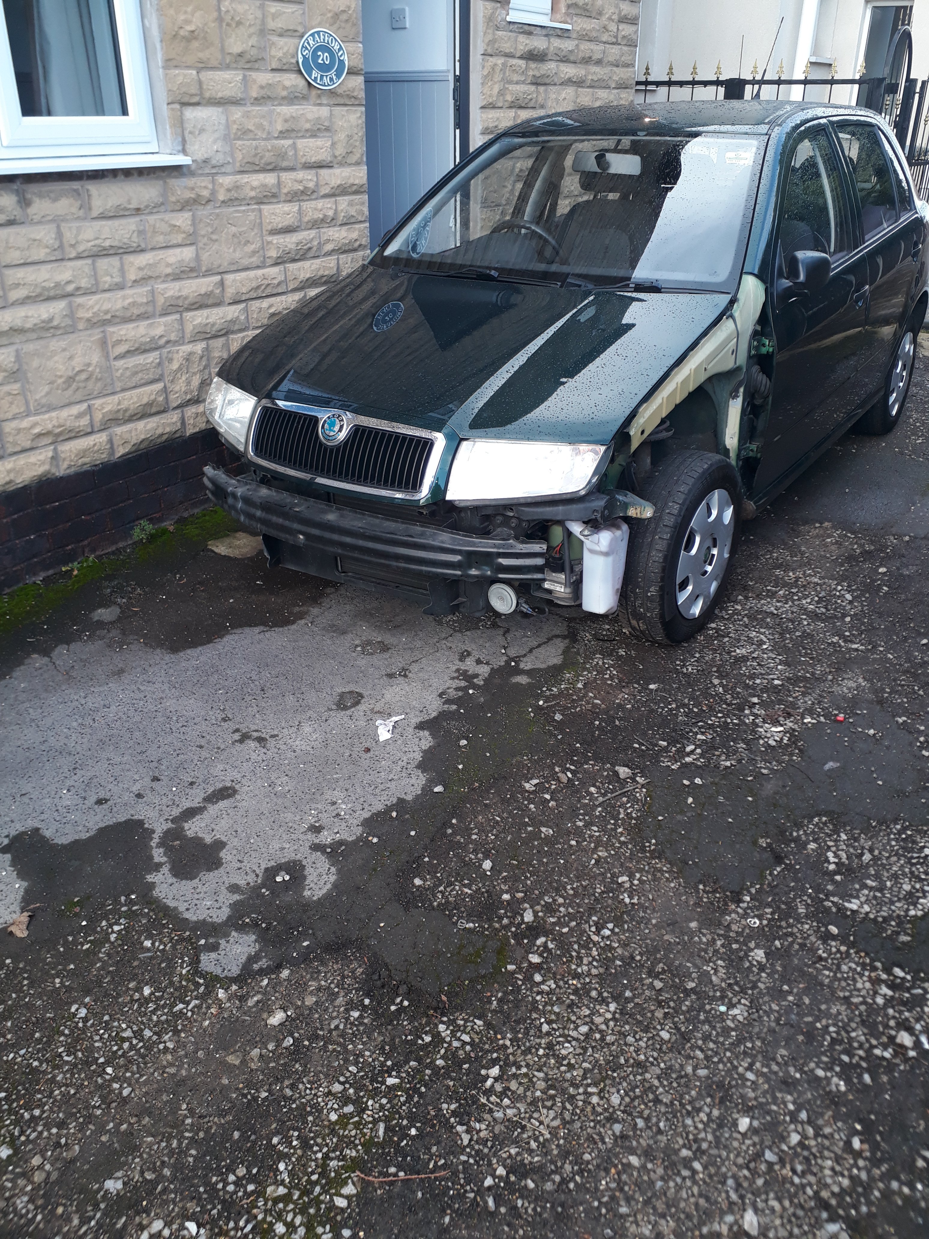

  9. Sounds like an old black cab! How many miles has the car done? Hope you get it sorted mate. I was planning to crack on with mine today but hasn't stopped lagging it down all day. Supposed to not rain tomoz so hopefully can get the new wings installed and bumper back on. My lounge looks like a salvage yard 😁

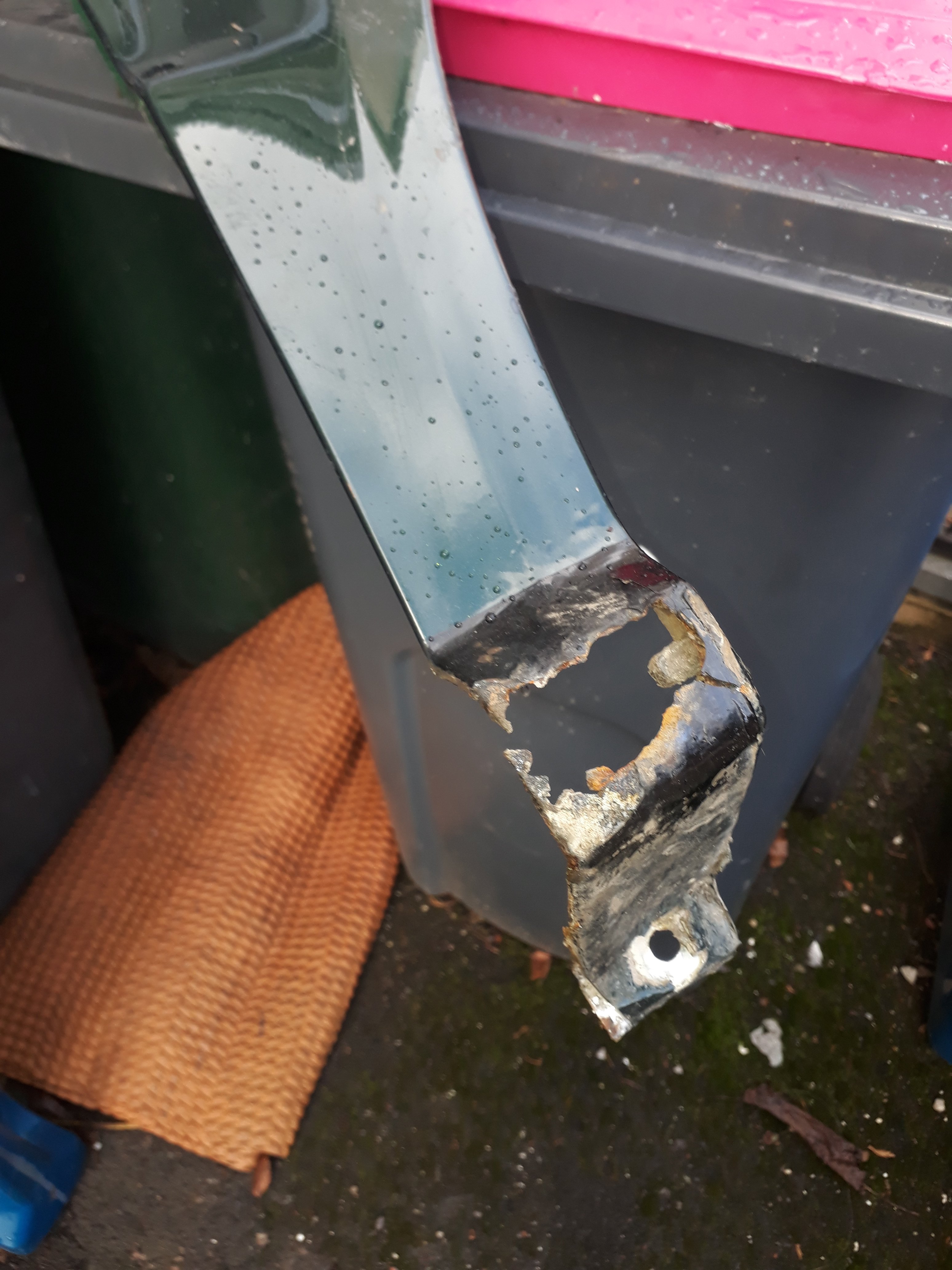

  17. Had another listen today but decided it's probably not as bad as I thought at this stage so will be taxing it December and running it for a while and monitor. Today with the help of hatboyharvey videos I took the front bumper and wings off. Didn't take long. The wings were rusted through at the bottom .... thought it was surface rust when I bought it 🤦‍♂️ but got 2 prasco pattern wings and dry fitted them. Seem like a pretty decent fit so took them back off and taking them to be painted next week. I was worried that the rust might have attacked the front of the sills but just ended being a bit of surface rust so no welding needed. A wire brush 2 coats of rust remedy and a coat of hammerite and they are fine. I got a gearbox oil top up and ordered a cheap 500ml syringe so will be checking that next week as well. Checked back take shoes and they appear to be about 60% worn so might just throw a new set on while its not in daily use as they are cheap enough. What i thought was gonna be a good service is turning into a full restoration 🤣🤣
