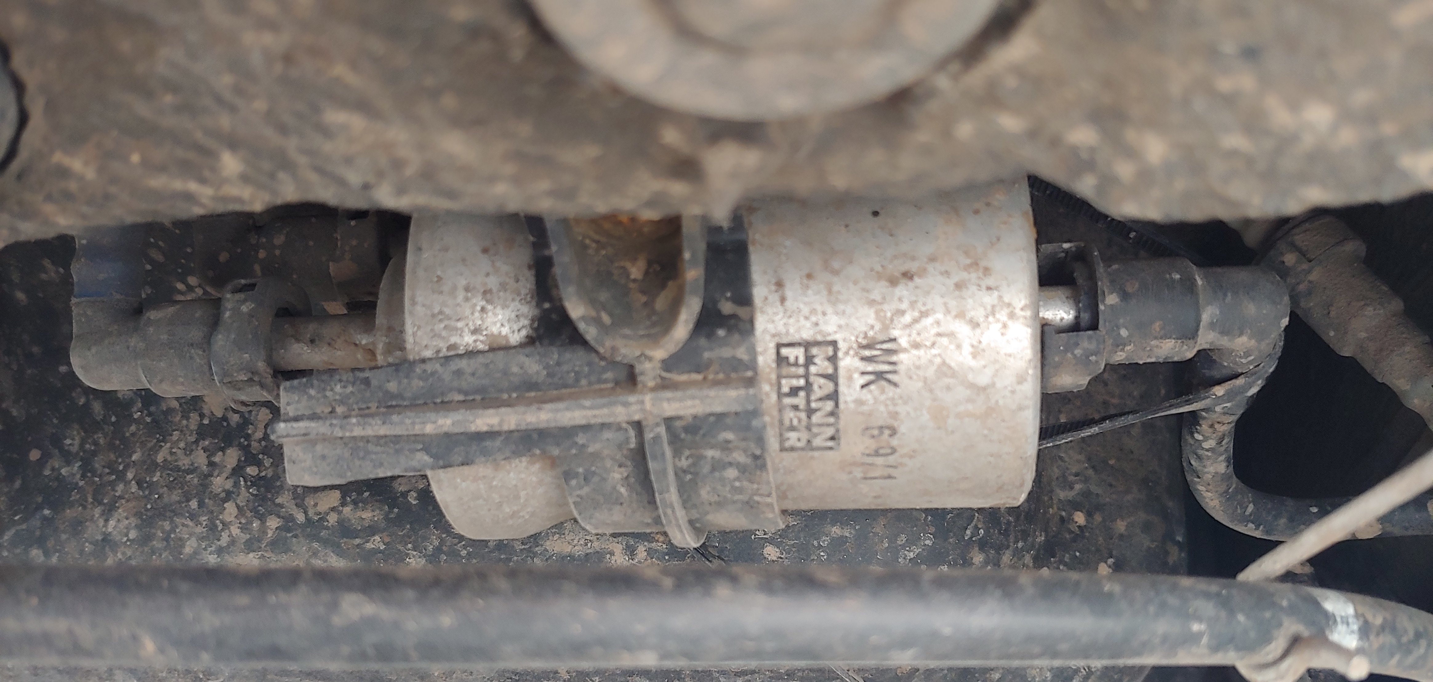

  11. I've checked, can't see anything, I was going to change the fuel filter to see if that made a difference. I've just looked and someone as bust the clip and its being held on with a cable tie, there are no leaks around it though so I don't think this is causing an issue other then fecking with my ocd. how annoying, this wouldn't cause an issue would it? also does anyone else think changing the fuel filter would help the issue I'm having? It was just a long shot. Fed up of spending money on it now to be fair (spent quite a lot last year), think I'm just gonna leave it until it dies. I've plugged it in again and scanned it today no codes have come back. The wife reckons she had the changed at some point, possibly about 5 years ago at a garage in Kidderminster, who she used regularly, but after a service, I did a check and they didn't even change the oil filter, needless to say they wont be getting no more custom from us.) this is why I hate going to the mechanics. Thanks
