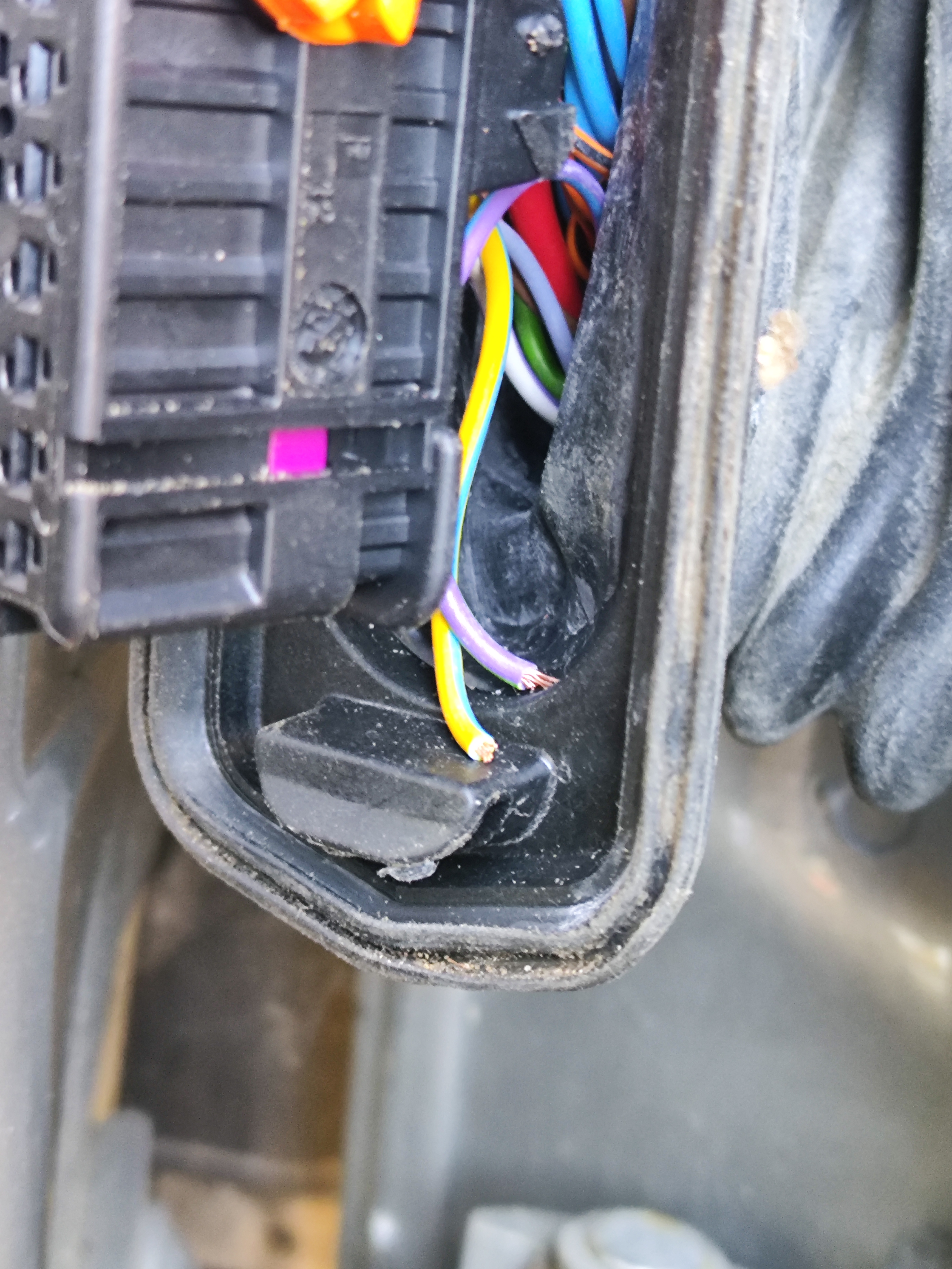

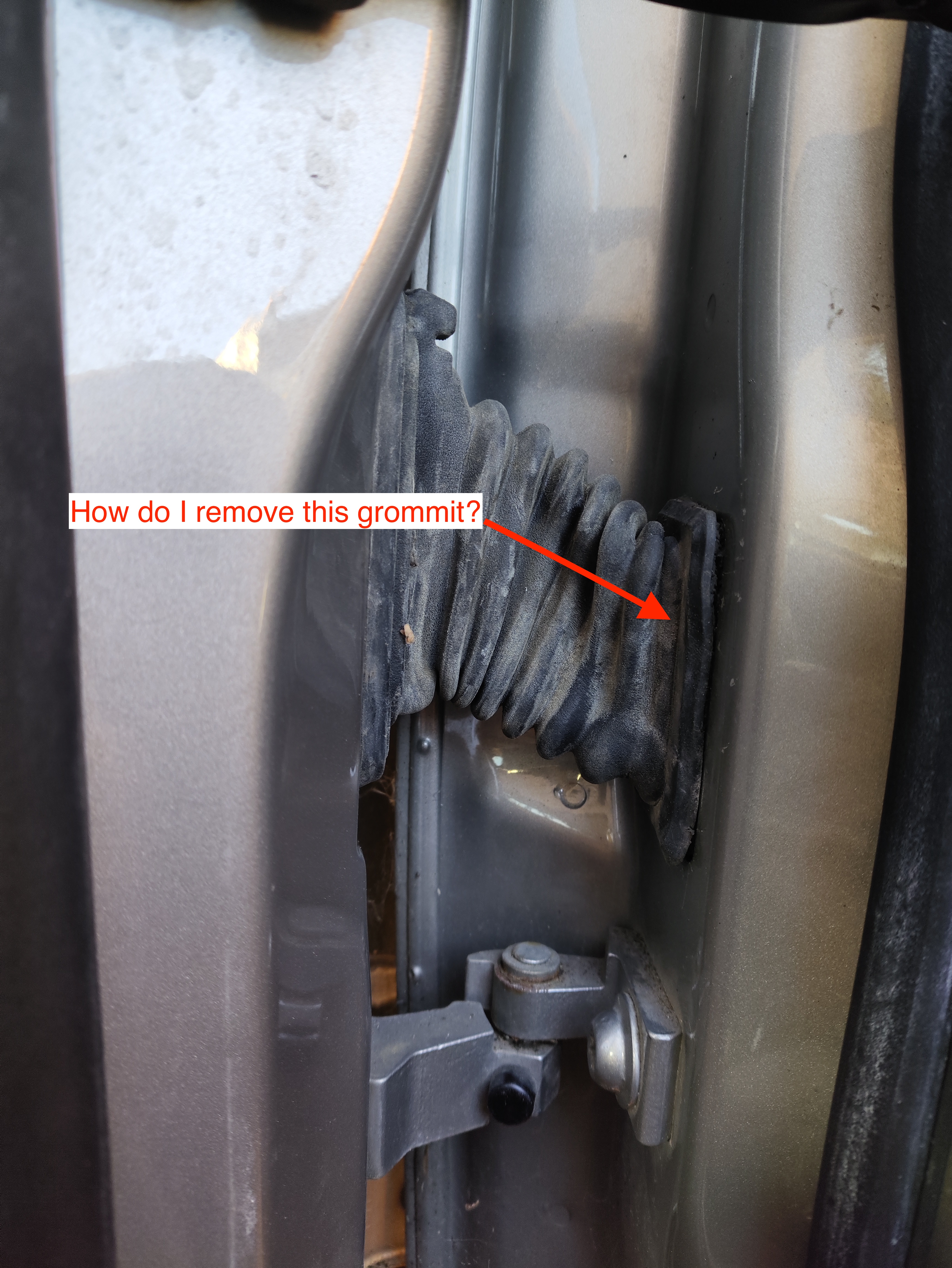

Door wiring access - help!
Hi, how did you manage to remove the soundproofing in the end? Were you able to remove the rubber grommit once the soundproofing was out of the way?

Further update: 26/01/2024: So I removed the OSF door loom where it goes into the car body as shown in the pictures and have discovered 2 broken wires so far. Yellow and Blue stripe wire Purple and Green stripe wire There may be others too but I can't remove the grommit which goes into the door as shown in the picture with the arrow. Anyone know how to do this as I attempted it but I'm worried I'll destoy the rubber as it's a 10 year old car so it's not as supple as it once was. Any help would be appreciated.

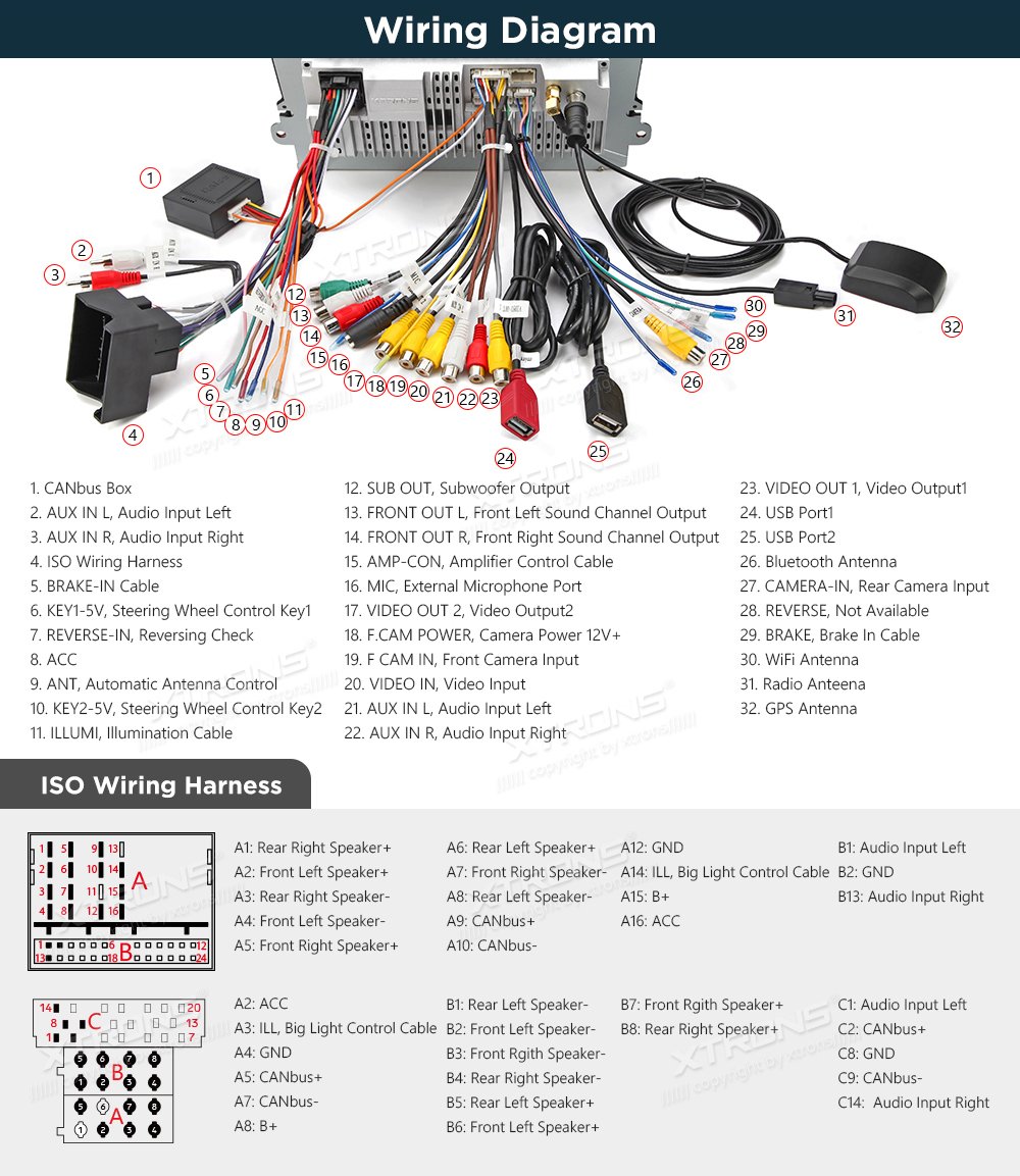

UPDATE: I have found some fixes and so this thread might be useful to others in the future. So for the persistent power supply and resulting persistent bluetooth connection issue: there is a small black connector as part of the canbus box which has an orange and red wire attached. This needs to be disconnected to stop this issue. You can check this by the unit powering down the second the car door is opened. Steering wheel controls become active once the car is running, not when it's off but with the ignition on. No coding required or additional modules, the Xtrons works with the car from factory. I have noticed one quirk though: when selecting the next track from the steering wheel it skips 2 tracks instead of 1. Screen being too bright at night: You need to wire the illum wire from the back of the unit to the orange wire from the quadlock harness. In the image attached which I got from Xtrons support you can see the illum wire as number (11) and the orange quadlock wire is A14. if this doesn't work then as a backup option you can download a free app named "Night Screen" onto the headunit itself and it provides a master brightness control which is really simple to use. I'm probably going to keep the app installed just in case I need it extra bright in summer/ direct sunlight. Bypass the video/handbrake lock: I'll leave you to decide whether you want to do this or not, entirely at your risk. On this unit you connect/splice wire number 5 (brake-in) into the ground wire number A12. There is also a setting under car infotainment>video: disable video in motion: set this to off. I think that's all the info so use with caution if you're reading this but the above worked on my 2013 Mk2 Superb which previously had a Columbus unit fitted.
