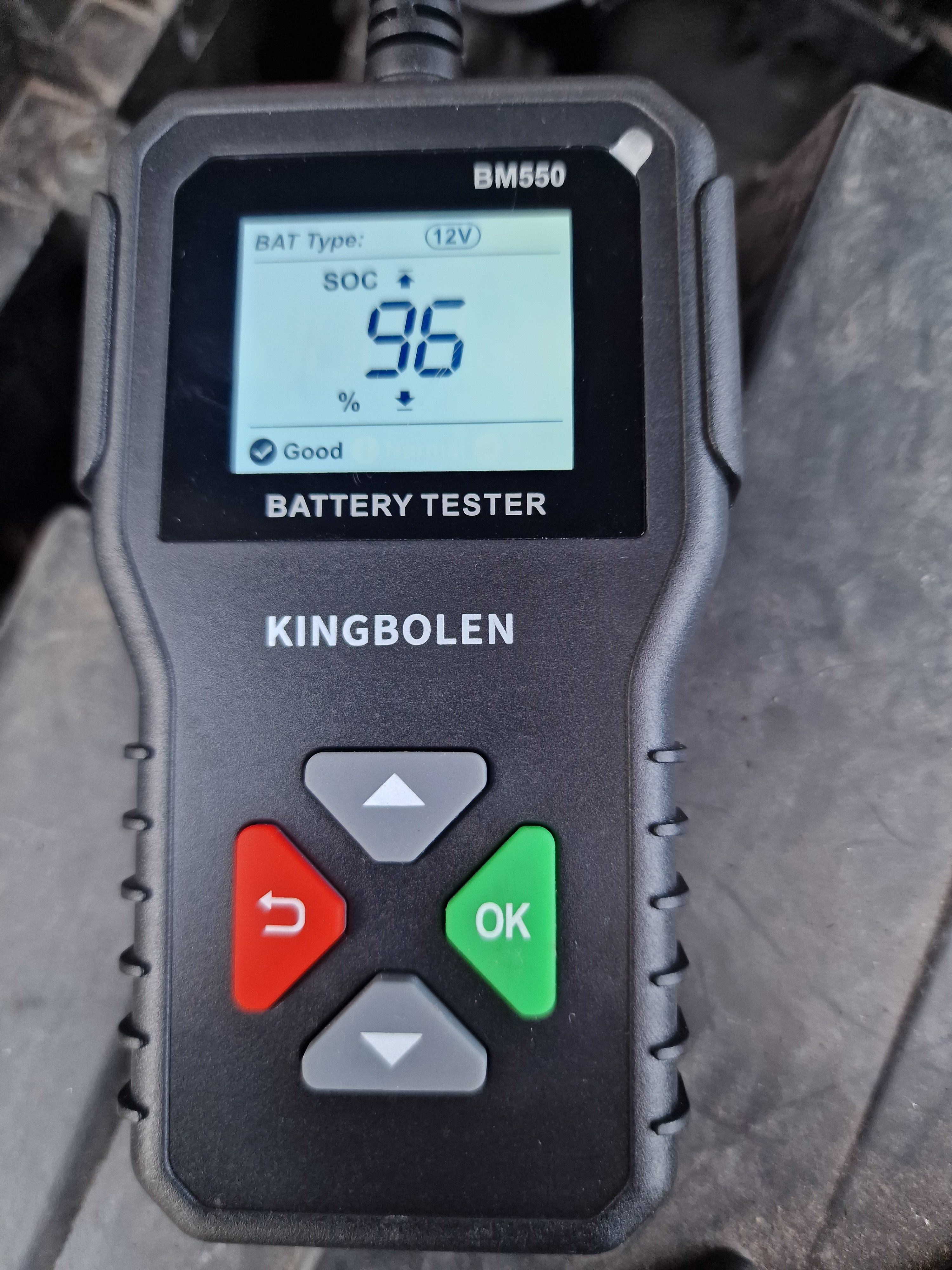

Charge dropped to 93% on the new battery so went for a drive and its back up to 96%. So alternator is defo sound.

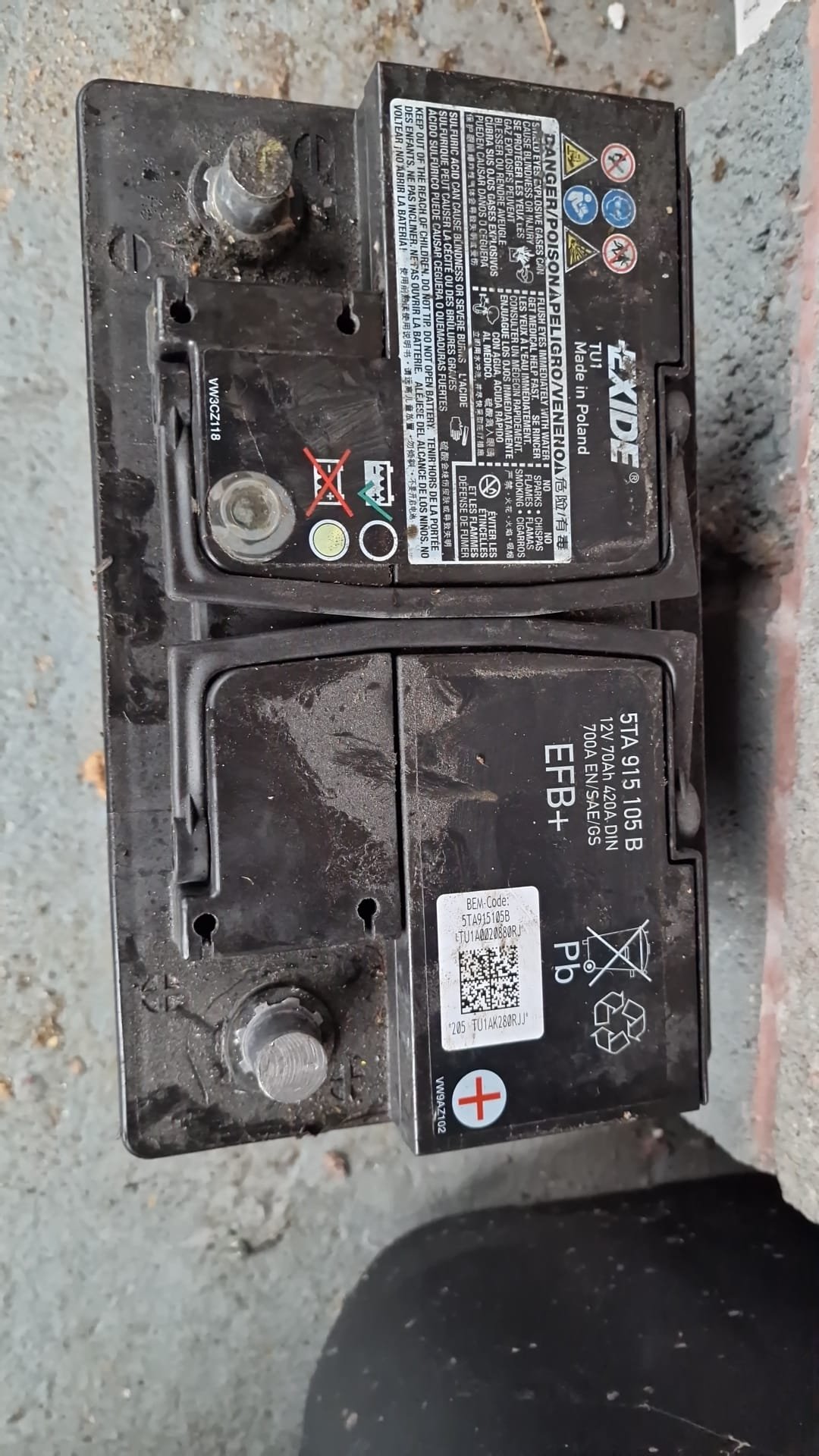

My battery is same, almost, but its a Exide. Here is mine with the logo on it - 2020 I got the car. I swapped it out today (5+ years old) for this which I believe is pretty much the like for like options. It has a higher CCA at 760 but thats only positive. https://www.ebay.co.uk/itm/277000251108?mkevt=1&mkpid=0&emsid=e11401.m144671.l197929&mkcid=7&ch=osgood&euid=c084fd95db534e97a7e5f31b6cc1969b&bu=43060722950&exe=0&ext=0&osub=-1%7E1&crd=20251208114245&segname=11401 Took me 30 mins to install. Bit tricky because of the bracket that keeps in place is hard to fish out. Do you have to recode the car if you going from 70ah to 75ah ? Thats what put me off the Yuasa and made me go for the Exide. Might work but it will be hurting the health of the battery if I am right ?

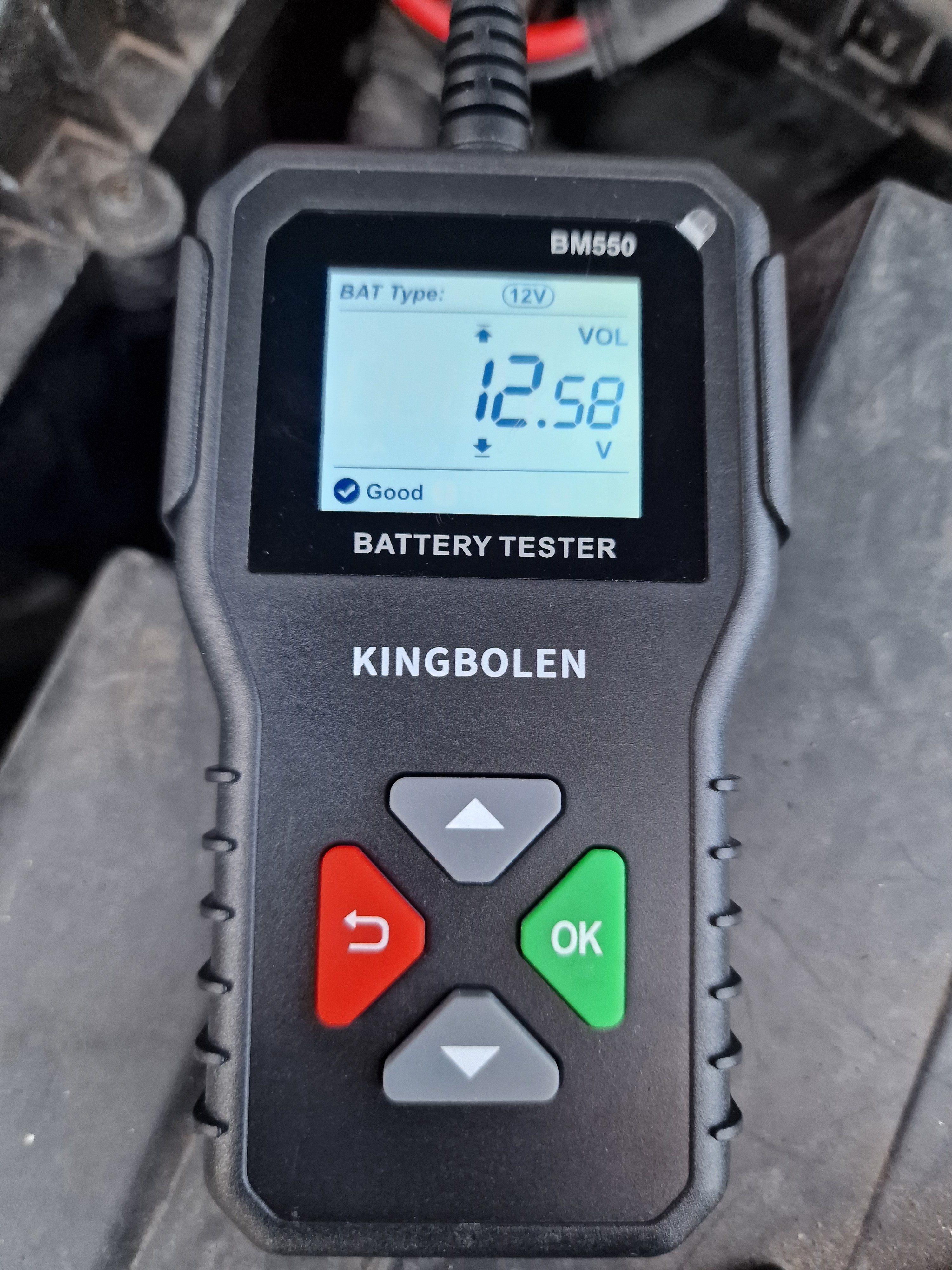

Installed new battery today - pretty much like for like.... Exide EL700 Not the easiest battery to install. The Kodiaq has a very annoying bracket you need some form of hook to move. All good now . Will let you know if the horn / acc issue ever returns!

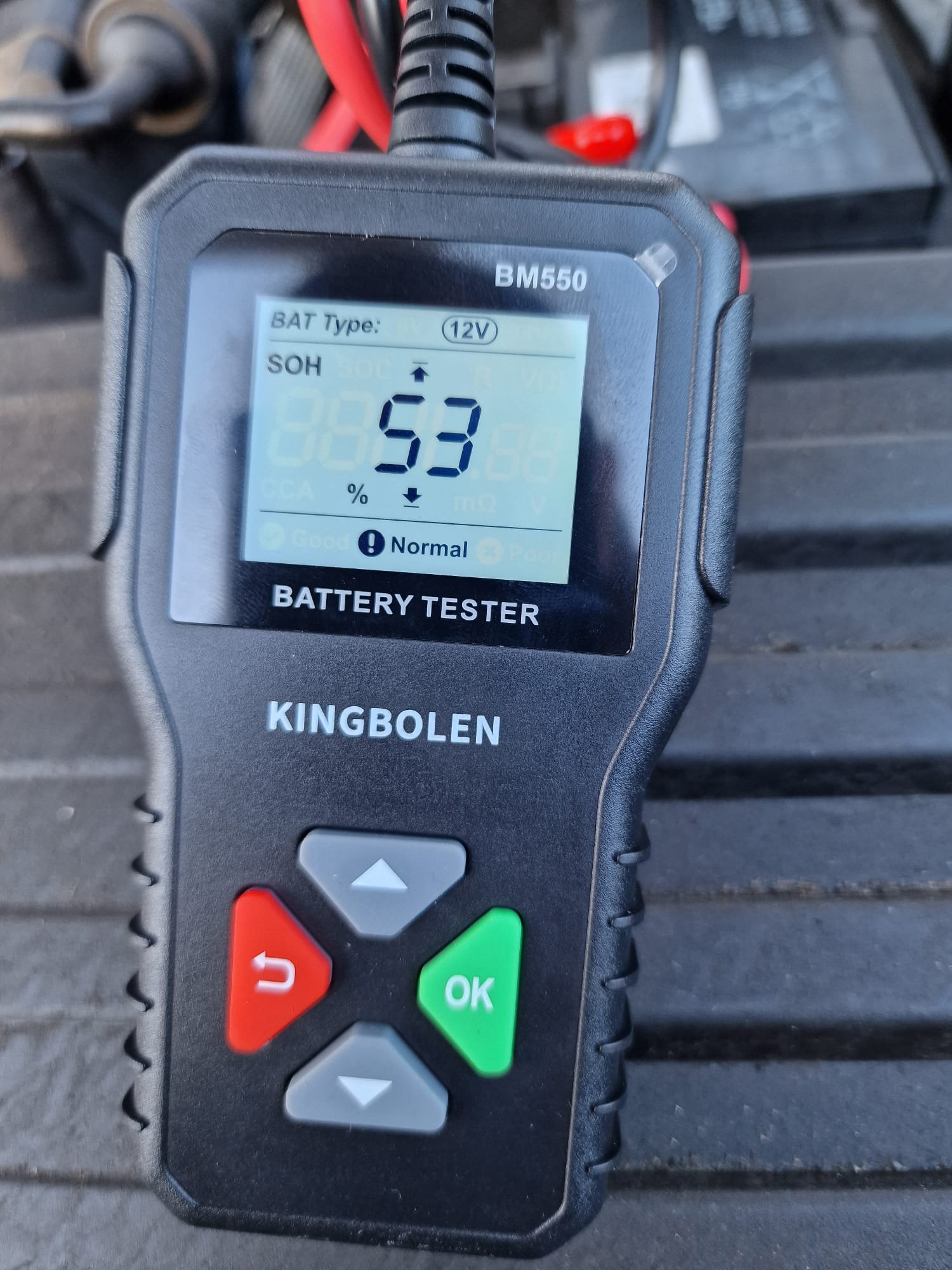

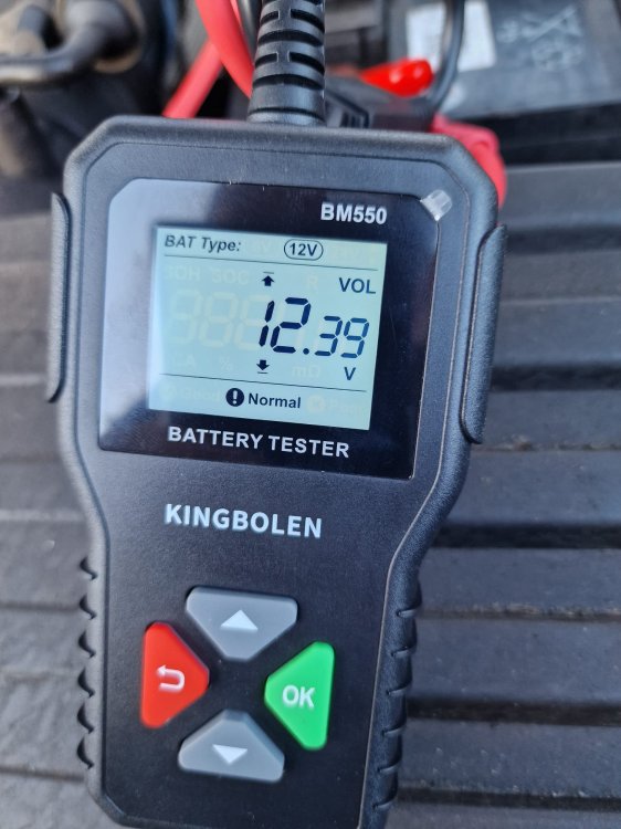

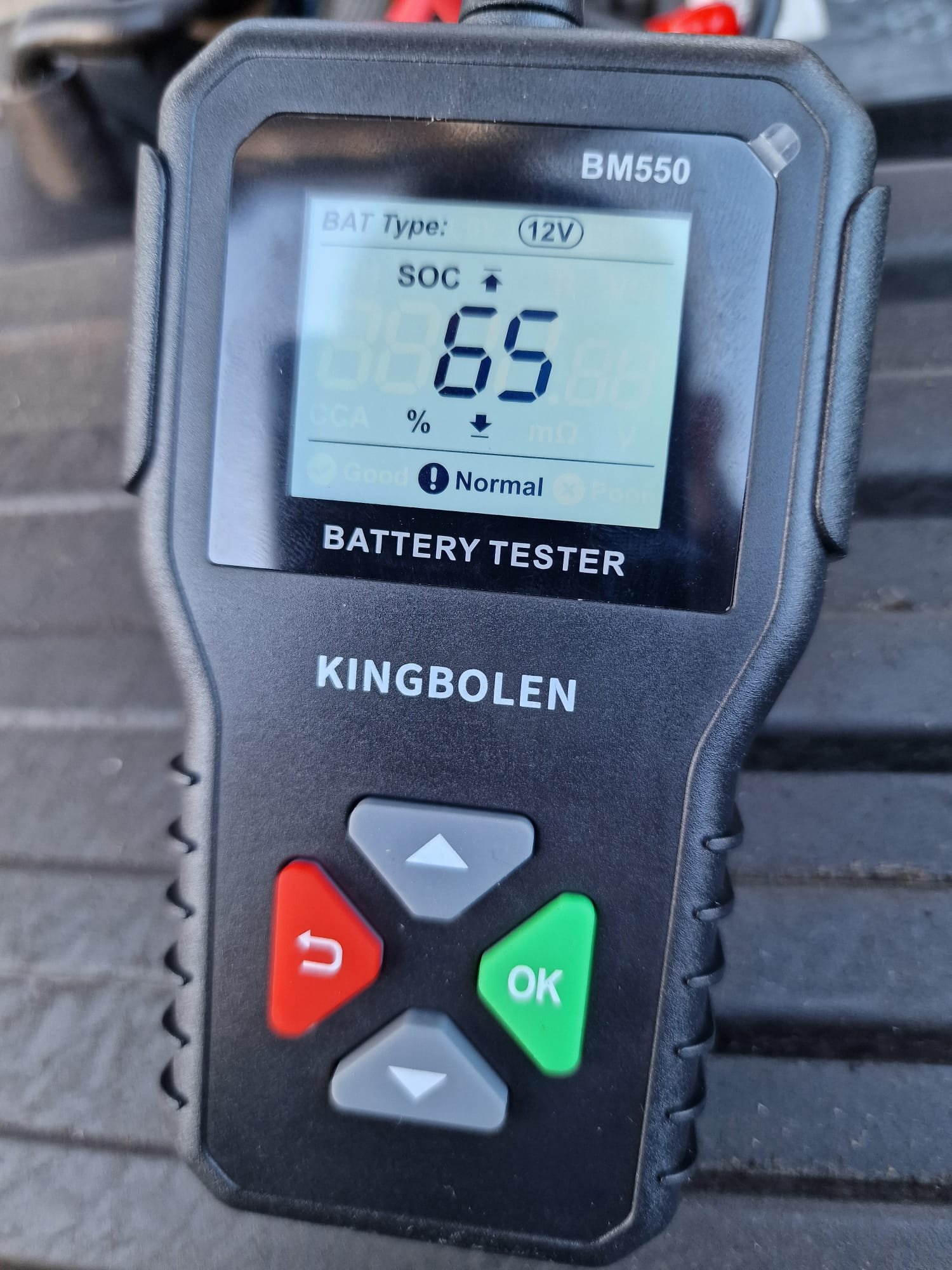

So I tested my battery this morning and it told me what I thought I would see.... VOL = 12.39 SOC = 65% SOH = 53% That is certainly a battery that is past its best I think it has to be dead before you get a "Poor" indication. So this matches up with the theory that as poor battery is going to cause you issues with ACC and HORN. So I will replace it soon and will let you know if I ever see this issue after changing the battery.

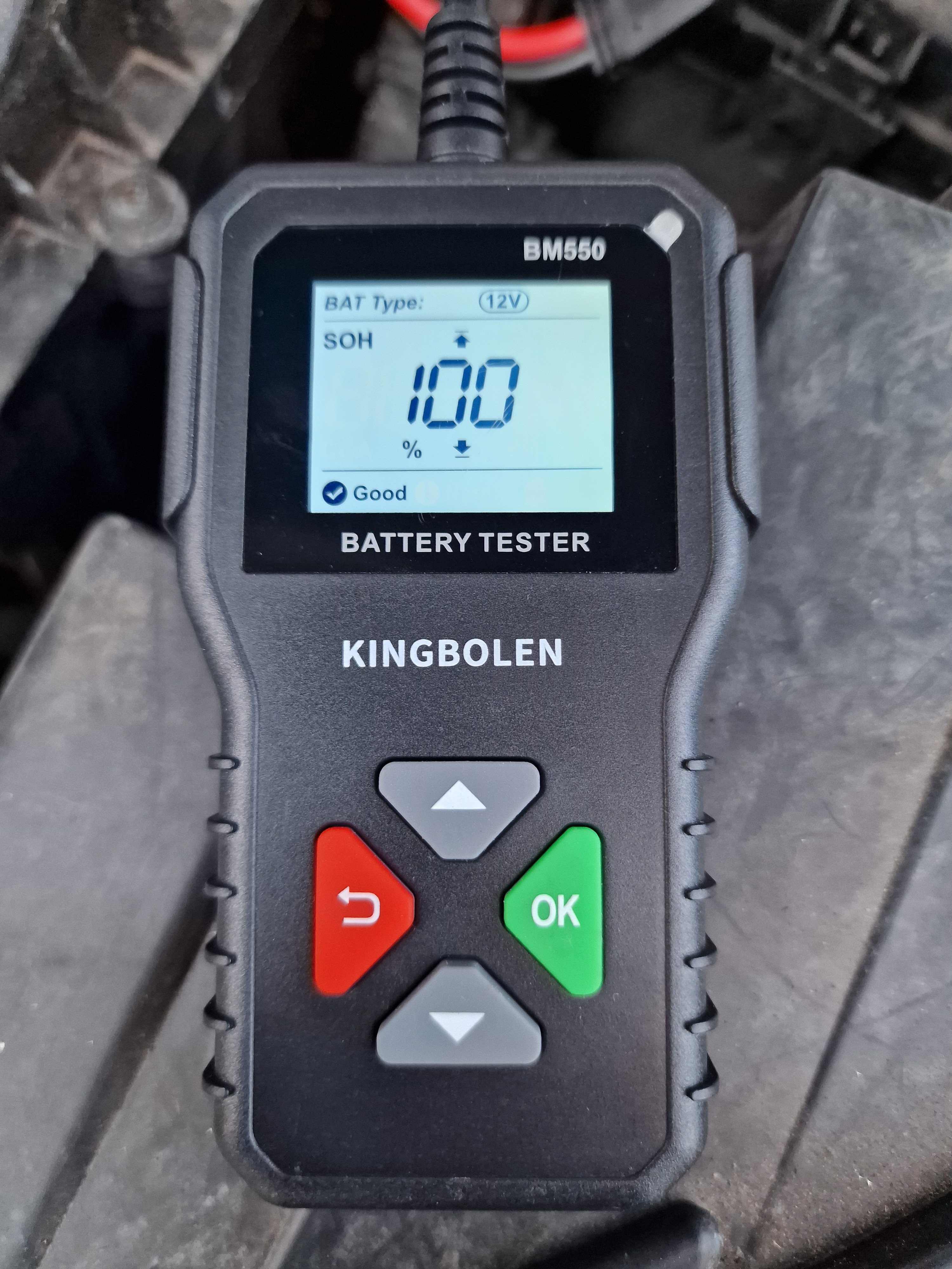

Mutimeter only tells you part of the story. Need to check the state of charge & health to get the batterys health. Your car might start up but that dosen't mean the battery is healthy and then you start to see issues like this is my understanding. KINGBOLEN BM550 is the sort of thing you need to test properly.
