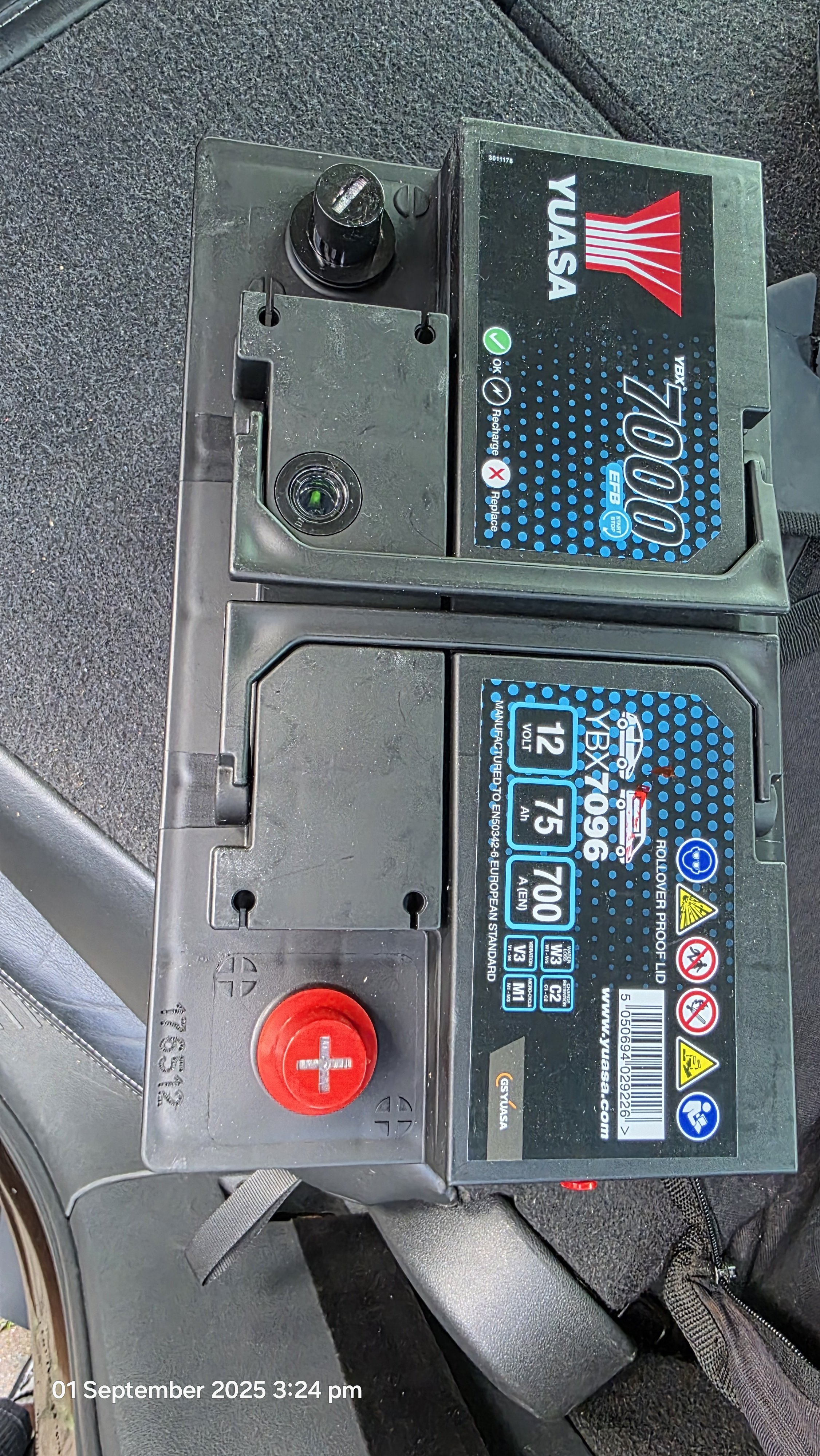

Hi, my car has recently been saying battery below 12v. So im guessing I neeed a new battery. I bought it 2nd hand from a Skoda dealer in 2020. So its possible the battery has been in there since new,(2017). Now battery prices range from £110 to almost £300. Went on a few sites and found on GSF a Yuasa ybx7096 , (pic), which they say is compatable. Bought it,thought it was a good deal, £121, reduced from £160, via the usual weekly discount codes.

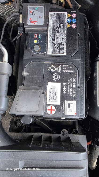

They current one is a Varta, (picture). But before changing it i noticed a slight difference. The current one say EFB+. The Yuasa is without the plus.
Is this a big deal? I've put in replacement battery,20250831_102954.jpg20250831_102954.jpg20250901_152409 (1).jpg for the car, in google and it mostly comes up with just EFB.
Is EFB and EFB+ the same thing? I can't see any EFB+ batteries online.
I wouldn’t say that was the original battery. Looks like a dealer replacement battery, part number begins with 000. The year is usually stamped on the negative post. That Yuasa battery will do the job.
My understanding is that the EFB+ is a fairly recent upgrading of the EFB - I don't think EFB+ batteries were around in 2017, so your old battery was probably not original.

Thanks all 👍. Yeah the Yuasa battery worked fine. Been on for over a month no problems.
