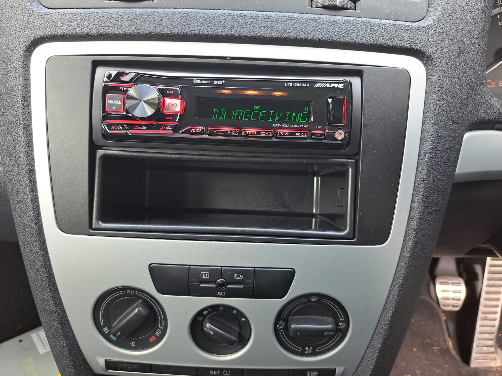

  1. UPDATE: Received and installed successfully. I had to route an ignition switched live from the fusebox, but that generally comes with the territory of installing electronic stuff. Other than that, all is good. This head unit has also allowed me to remove the dedicated DAB receiver I was using, as well as remove the hideous and bulky CD wallet from the glove box. All my entertainment is now coming through either DAB or USB. I haven't even bothered setting up the Bluetooth yet. There's a slight gap above the replacement surround, but I can live with that. I'm a happy bunny!

  3. OK, thank you. What was the issue relating to the gateway anyway, in terms of switching out a head unit? The Alpine unit I was looking at is £150. It has DAB and a USB port, which are the only two features I'm interested in. As a bonus, it has Bluetooth with hands free, and user selectable RGB lighting. It looks a bit dated, but I'm not bothered about that. https://www.caraudiodirect.co.uk/alpine-ute-204dab-mechless-dab-car-stereo-radio-bluetooth-mp3-flac-usb-aux The same store also sells the DIN adaptor kits.

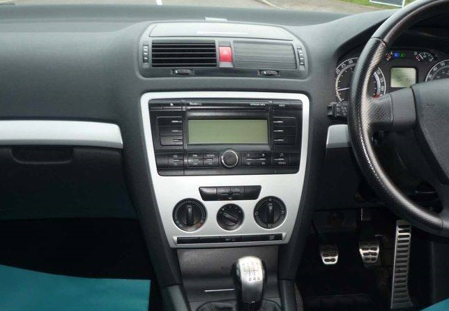

  4. Thanks for your help with this. The part number I have is 7N0907530AKZ00.
