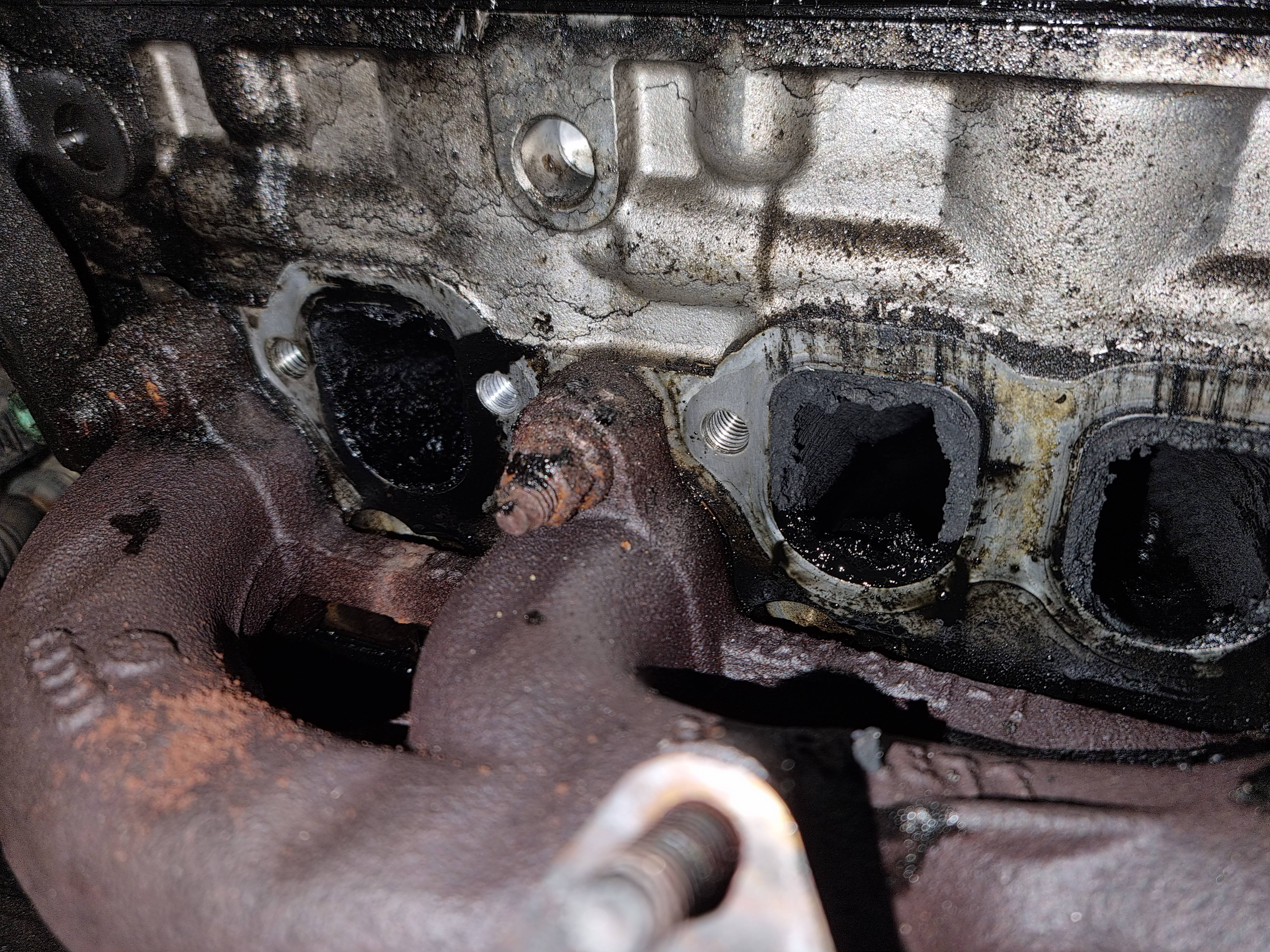

  3. Scraped out what I felt was loose in the head, engine was a bit reluctant to turn over at first but rotated through all 4 injectors firing so the engine isn't seized in any way. Going to take my time cleaning up all the parts and ordered new bolts and gaskets. Should run well once done!

  5. Is it safe to clean out the ports on the head?

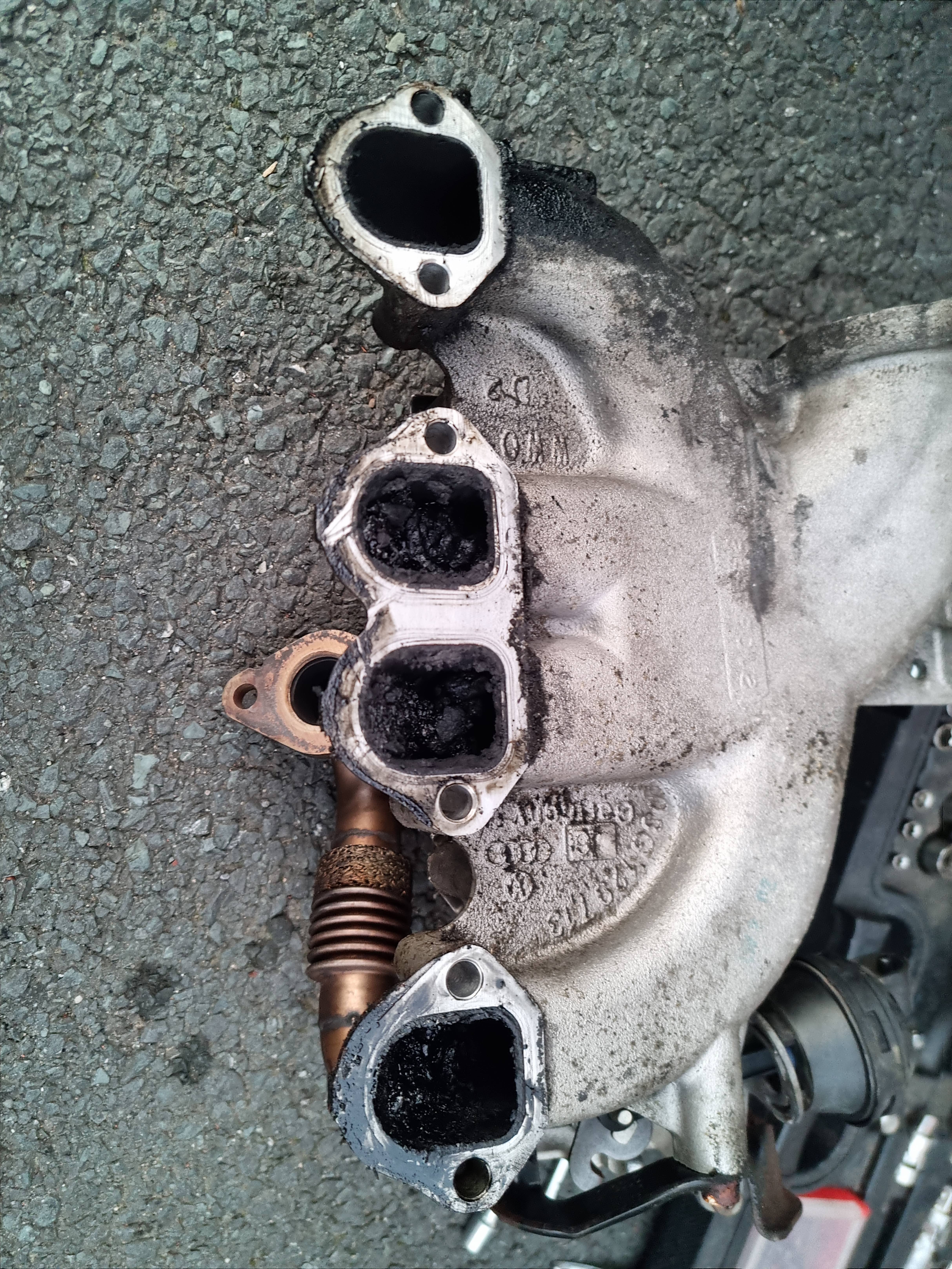

  6. Inlet manifold is now off. Struggled with access to the 6mm bolts but perservered. I'll attach photos, but the inlet is clearly completely full. It seems to me that there just wasn't enough airflow to even turnover. Not sure how to approach cleaning the ports. Is it safe for me to scrape them or not? Maybe try burn some of the crap off?

  11. I'm almost certain everything is connected, I've had things apart a few times, but I'll check again. I cleaned as much of the inlet manifold as I could, a lot has surely fallen down. There was I'd say 1cm of buildup on all the surfaces, I did scrape quite a lot inside the manifold, I'm not sure how much would prevent the car from starting. The EGR is new. I've ordered a used manifold to clean up before taking mine off so can stick one straight on. Would taking the glow plugs out and turning the car over be wise to do once the clean manifold is on? Is it worth changing anything else while it's all apart? It's likely the last time this car will see this kind of job
