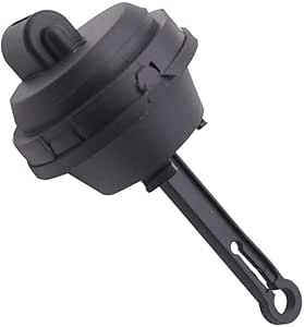

On my old Seat altea 1.9tdi BXE (same engine) there is an egr cooler at the rear of engine. On the cooler there is also a vaccum unit. Its plastic. On mine I kept getting EGR flow errors and limp mode. EGR was working fine. I tracked it down to the plastic vaccum unit. It was sticking and not opening fully. It could also be the egr cooler thats choked. The plastic vaccum unit looks like this
What you’ve shown in the picture is a vacuum actuator (plastic vacuum unit) that sits on the EGR cooler in your Seat Altea 1.9 TDI BXE engine.
  • Its job is to control the EGR cooler bypass flap using vacuum pressure.
  • If this actuator sticks or doesn’t move smoothly, it prevents the cooler flap from opening/closing properly.
  • When that happens, the ECU detects incorrect gas flow → leading to EGR flow errors and sometimes limp mode.
Likely causes:
  1. The vacuum actuator itself (plastic diaphragm or mechanism sticking).
  2. The EGR cooler is clogged with soot, making the flap hard to move.
  3. A vacuum leak in the line feeding the actuator.
What you can do:
  • Check if the actuator arm moves freely by hand (with vacuum applied it should pull fully).
  • Apply vacuum with a hand pump → if it doesn’t hold vacuum, the diaphragm is torn → replace actuator.
  • If it moves but sticks, the cooler flap is probably clogged → remove cooler and clean/replace.
Many times, just replacing this plastic actuator (or cleaning the cooler flap) clears the EGR flow error without touching the main EGR valve.

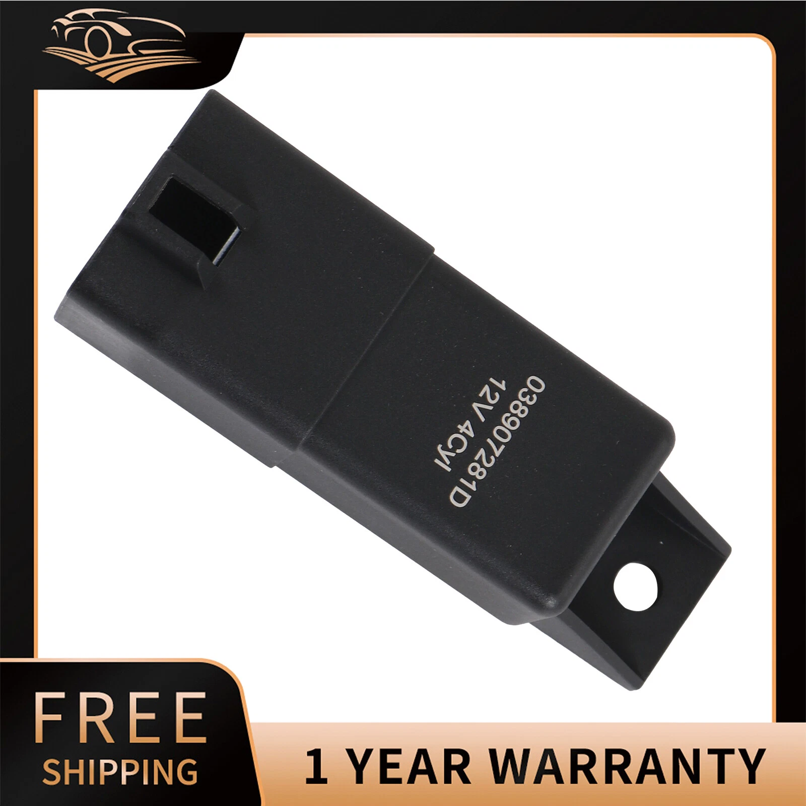

The glowplug harness disintegrated so I've got a new genuine one coming. Does anybody know where it connects? Does the ECU need to come out to wire it in?
Not sure but there may be a timer/sensor unit for the glow plugs that it connects to. Had them on a few old diesel vans.
Think the one on the 1.9tdi looks like this
Its usually in the engine compartment somewhere. I think the MK1 were under dash
