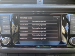

  12. So I recently swapped the original head unit from a 2015 to a 2016 for apple carplay .. After going to the dealer to disable CP everything worked great (carplay & bluetooth) and the next day the only function left working is the radio .. I went back to the dealer and they said they have nothing they can do about it because the head unit comes from another car and i should go to someone who can hack the unit.. is there anyone that can help me? I understand that it could be unlocked remotely (that would be great if possible)

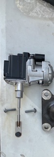

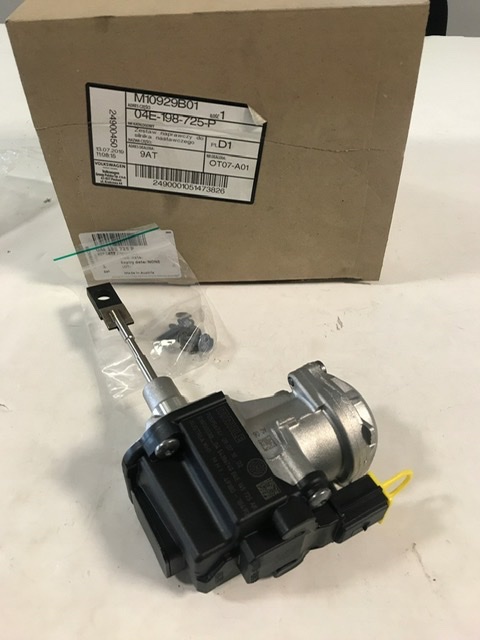

  13. The arm , i currently have the top actuator and trying to get my hands on the bottom one

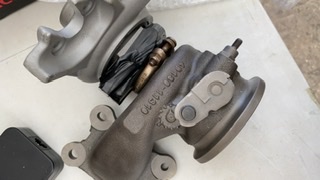

  14. *Info for anyone interested in upgrading to a hybrid turbo* So after getting the 1.4 hybrid turbo i faced a problem with the wastegate physically not fitting the turbo , the 04E 145 713 N turbo that is used as a base for the hybrid turbo comes with a different wastegate than the 04E 145 721 B the 04E 145 721 B wastegate- the 04E 145 713 N wastegate- the 04E 145 713 N based hybrid turbo
