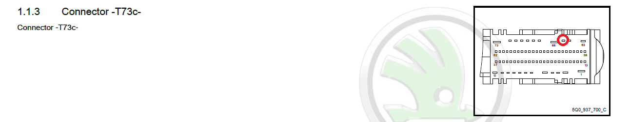

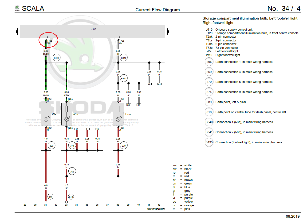

  1. Hi, Have anyone retrofitted footwell leds to they'r Scalas ? Im looking for confirmation that I am reading this chart correctly : Do I hook up positive wire to "T73c" connectors pin "65" ? I got a set of 4 lights and harness from Aliexpress and also couple different brackets to try if I could also install these under front seats so they illuminate in the back aswell. And also does anyone know correct way to code these to work properly (Im using OBDEleven) ?
