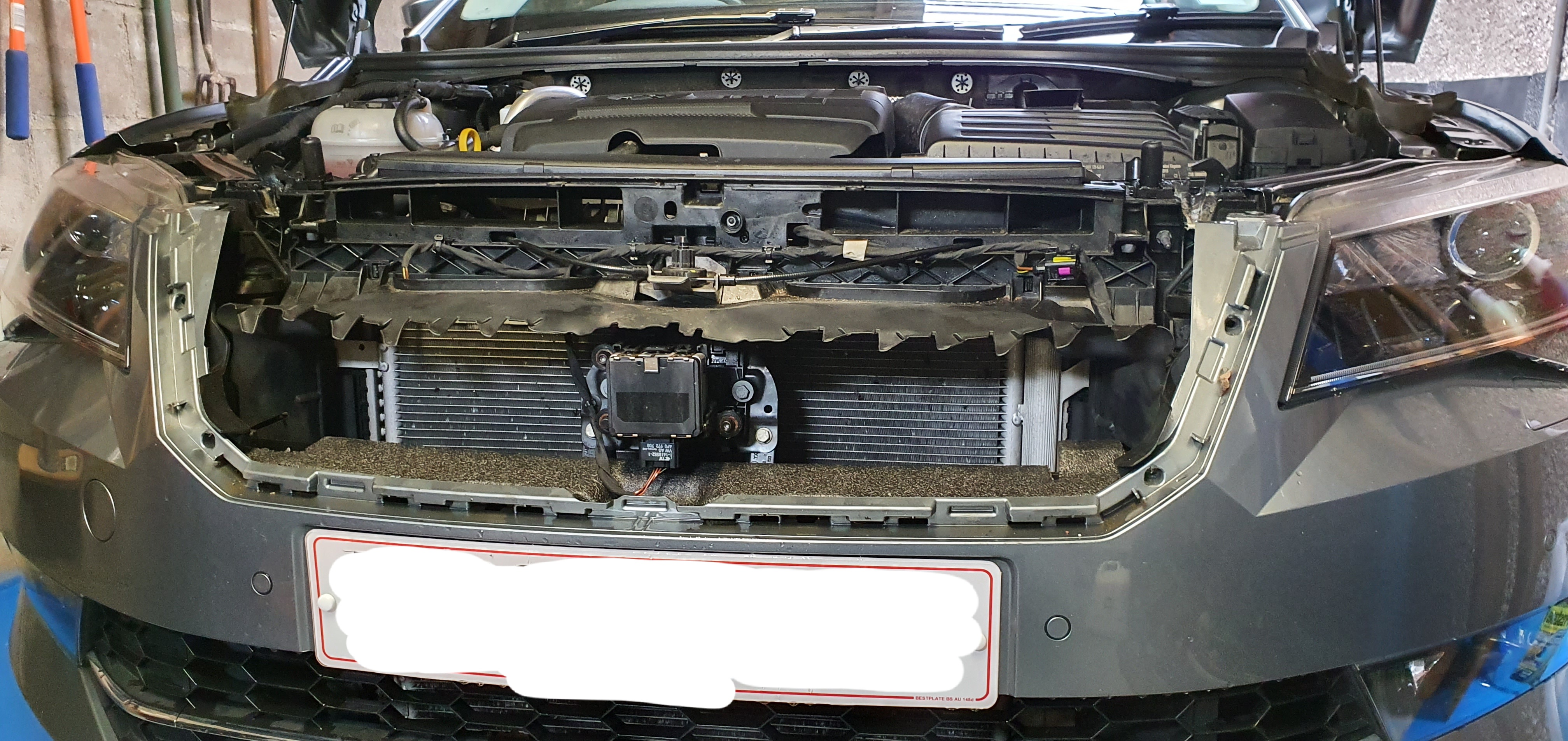

You can remove the whole bumper if you like. I think @JR RS did it this way. I changed my grille surround and removed the entire grille with the bumper still attached. It's ok, but a bit awkward in places. A good bit holder is the key to not losing any torx bits!
There r 9 screws that hold the grille to the front bumper, and 8 tabs/clips!!!
IMG_10112020_105759_(1080_x_608_pixel).thumb.jpg.520a7219b9755d0bb4ddfda713d45164.jpg
Bit overkill, but yeah, having the front bumper off will involve a lot less swearing, in order to remove & fit the grille.
To remove bumper - wheels off, wheel arch liner off, disconnect washer pipe, disconnect wiring harness, remove screws - pull bumper out.
be careful NOT to hit/upset/knock the ACC radar while sliding the bumper in/out.
I created this how to guide on removing the front bumper.

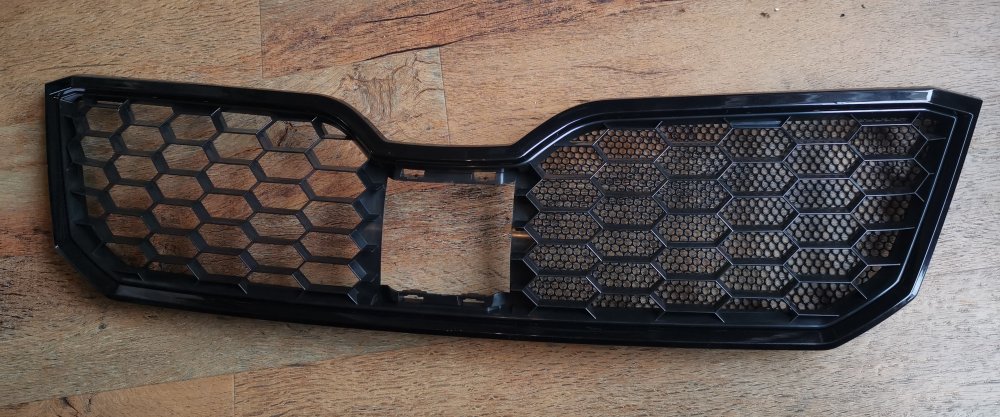

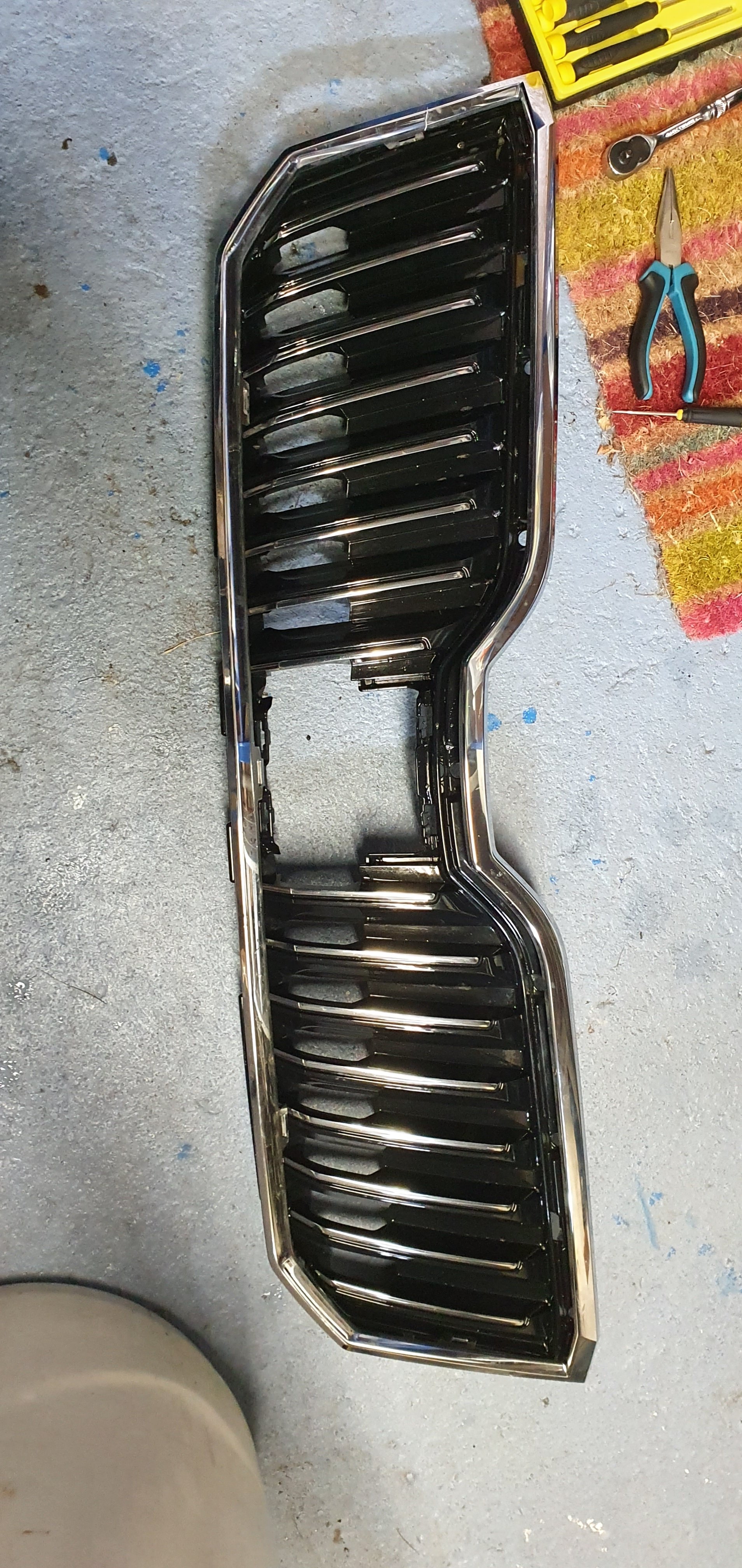

Thanks so much guys, extremely helpful. I'm installing black plastic mesh behind the honeycomb one as it feels way too open for stones to hit the radiator. See right side meshed, left not for comparison
Safe and clever approach! I would do the same if I did the same mod!.

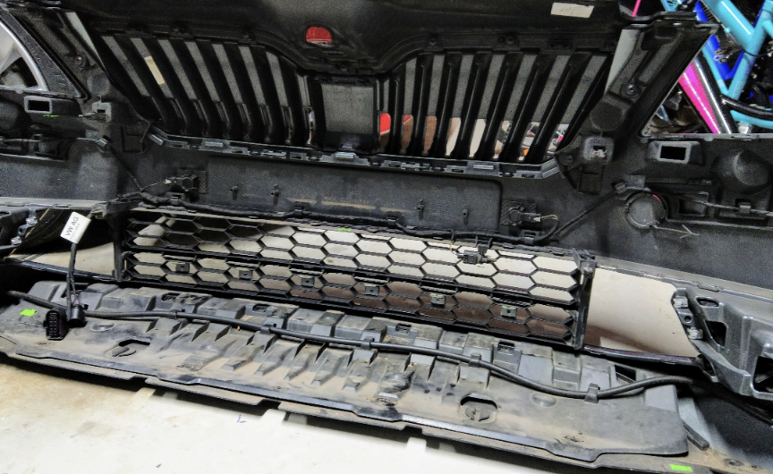

It would also make sense to install the same mesh on the lower honeycomb grill (under the licence plate), wouldn't it?

Hmm I haven't examined the lower grille. Will take a look. Took hours to plastic weld the mesh to the back of the honeycomb. Araldite glue didn't work well, or maybe I didn't get the mix quite right. Must be really well attached first time, I have no intention of taking the bumper off again to fix it!

As you say, the  lower part of the radiator is very exposed to stones with the original honeycomb lower grill.
To me, your improvement idea with this kind of mesh fully makes sense.
As @Bap33 mentioned, the lower grille is exposed indeed.  U might as well mesh it too if ur doing the top grille.
Getting the lower grille off is a bumper off job too.

https://www.ebay.co.uk/itm/BLACK-1m-x-40cm-SEMI-RIGID-HD-HDPE-7mm-PLASTIC-MESH-SCREEN-FILTER-RIDDLE-BARRIER-/292241421165?_trksid=p2349624.m46890.l49292
It was a bit of a pain to fit. When I went to fit the grille I realised there is very little extra room for tolerance, so I had to trim the mesh as tight as possible and use an 18watt soldering iron to plastic weld it together, I spent a lot of time doing the trimming and plastic welding, because after all the effort of fitting it back in the bumper and getting the bumper back together, I don't want the mesh to come apart in the wind at high speed, so I made sure this was as strong as possible a bond. I didn't want to use metal mesh because paint would just chip off it and it would rust over time.
