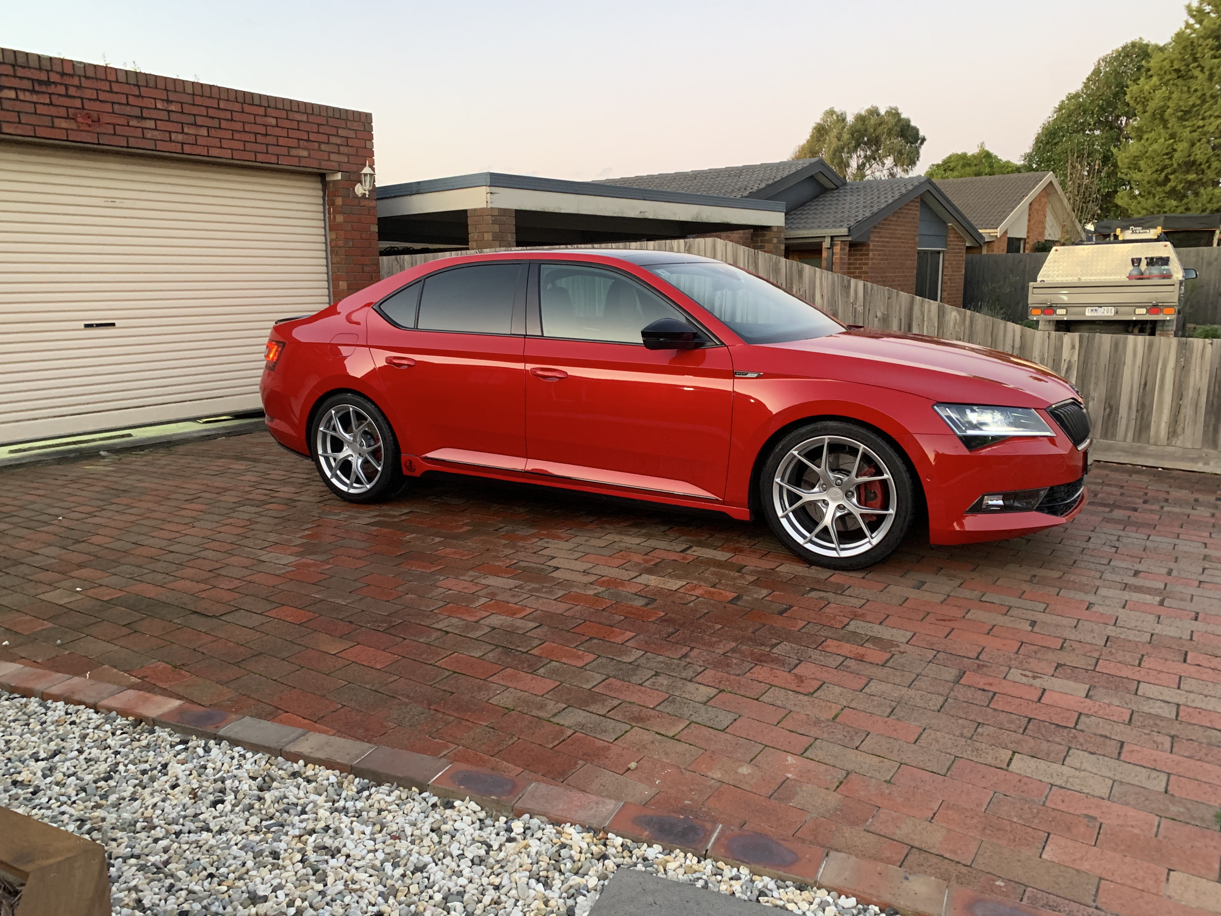

  10. Not today, but last weekend. So I scratched one of my rear alloy pretty badly two weeks ago. I could not find any color-match paint for the wheel. In the end, I decided to paint all four wheels into silver. Have to say, the silver is not what I thought at the beginning. It is too white-ish to me, not that cold/metalic-ish silver. But the final result is not bad at all.
  11. I think he is talking about the far left silver car, not the black one in the front.

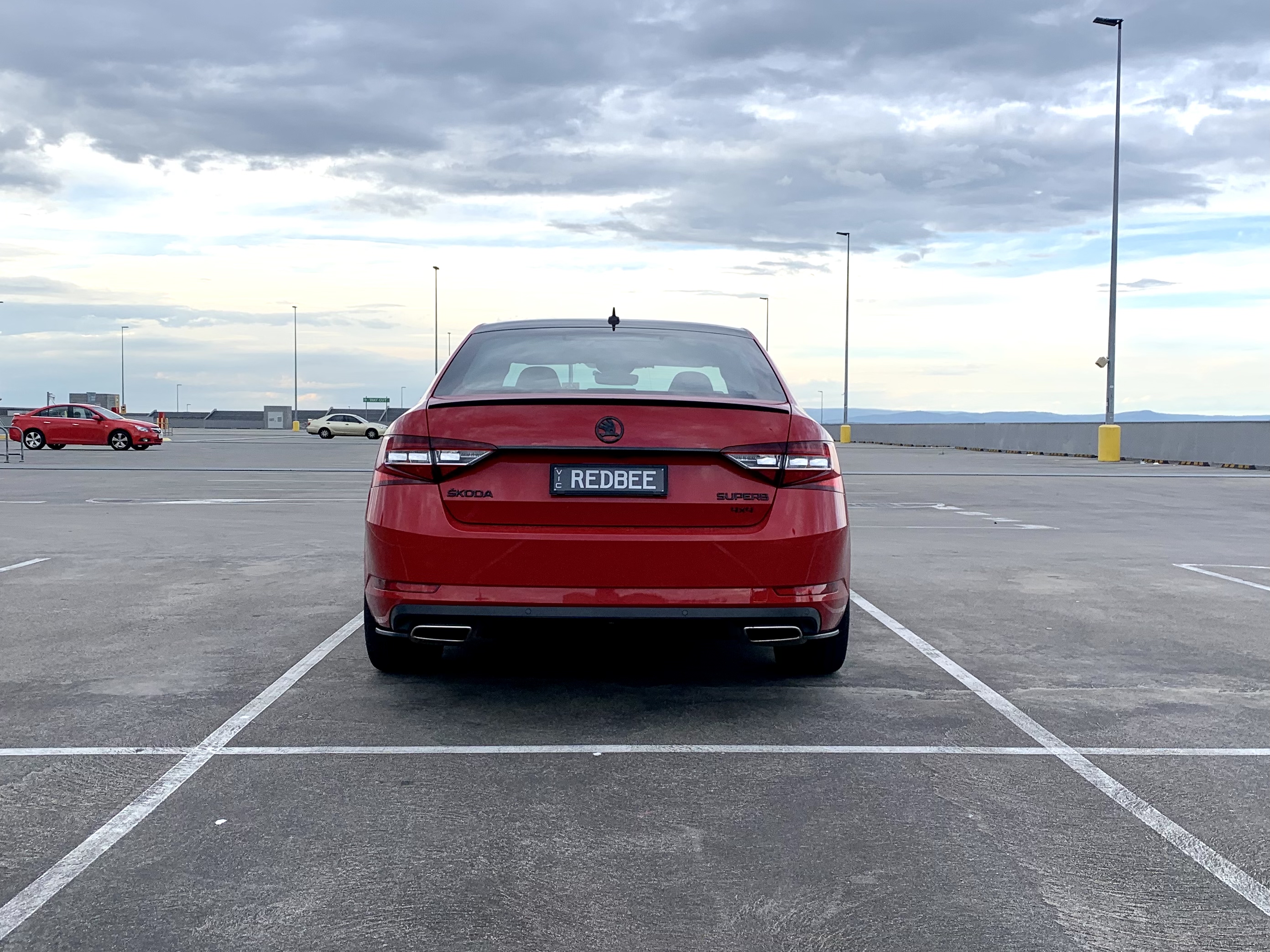

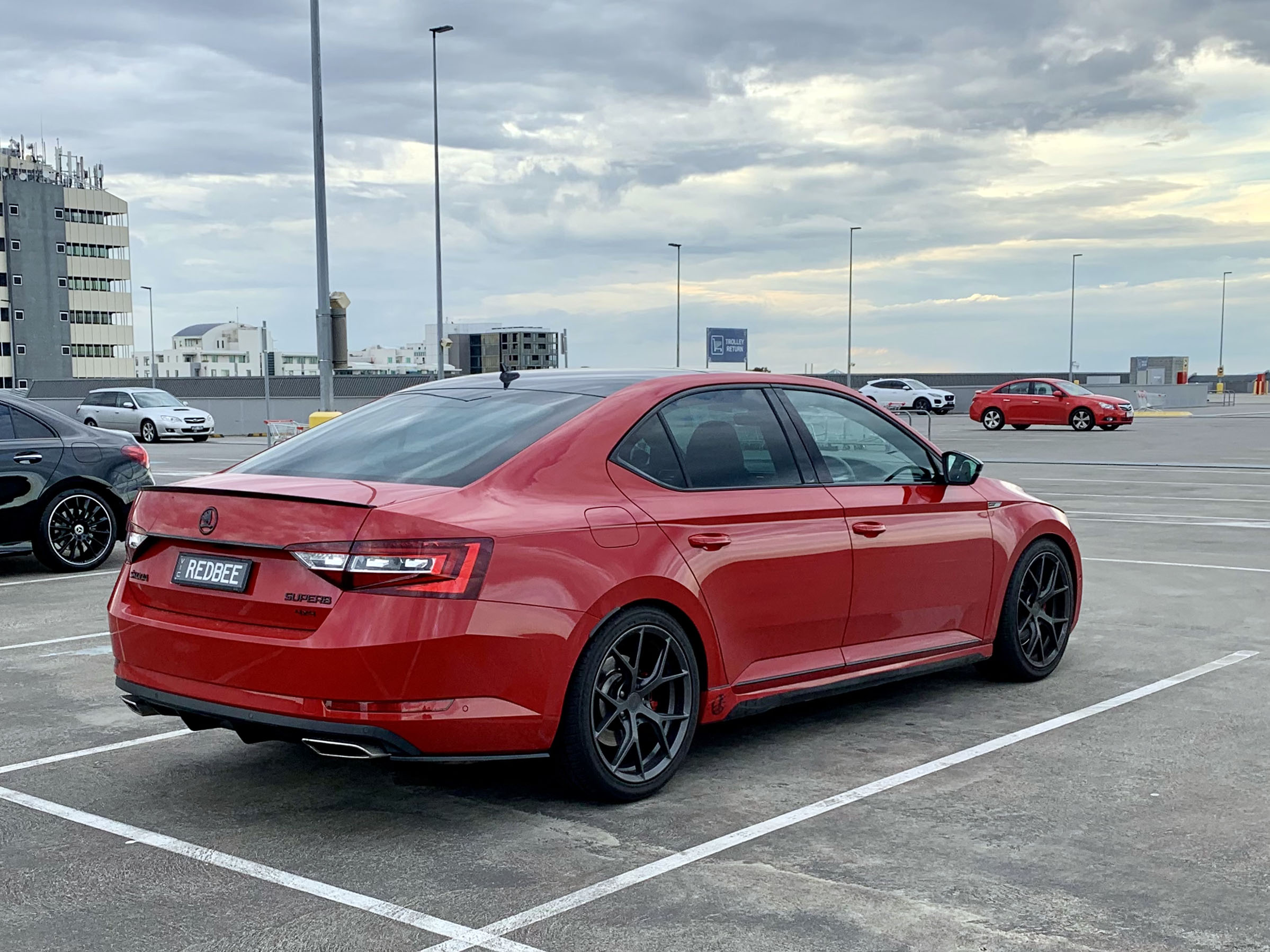

  14. I have maxton diffuser and rear splitters on my car. Diffuser is gloss black, splitters are plastic finish. Installation is pretty straightforward, as long as you have some basic tools, it is an easy DIY job. I also cut and modified the splitters. As you can see from the pics, they are basically flush with the bottom of the bumper. The original design is a bit too boy-racer to my tastes.
