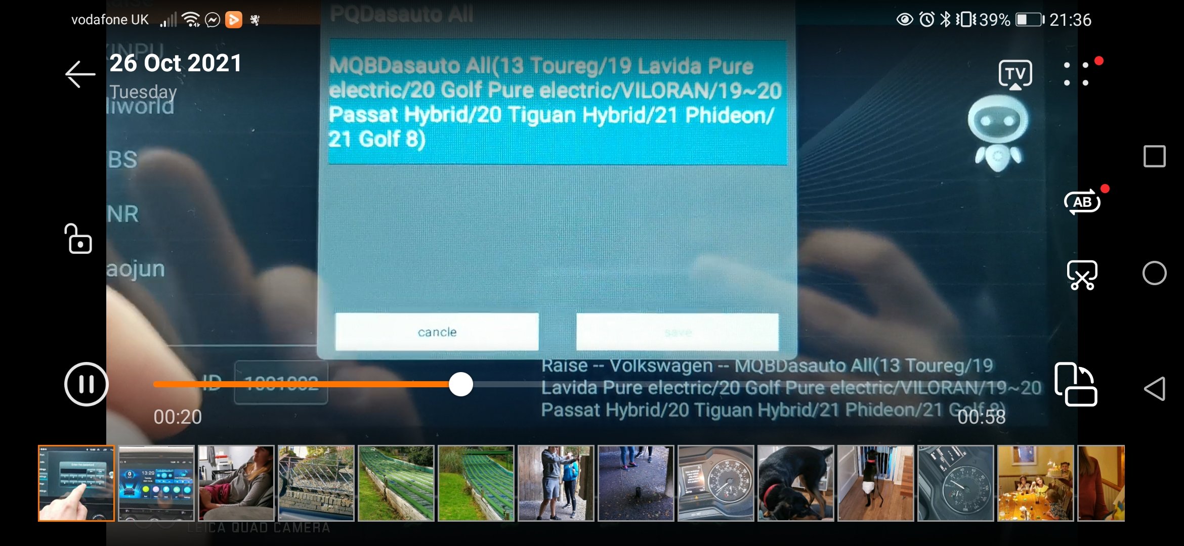

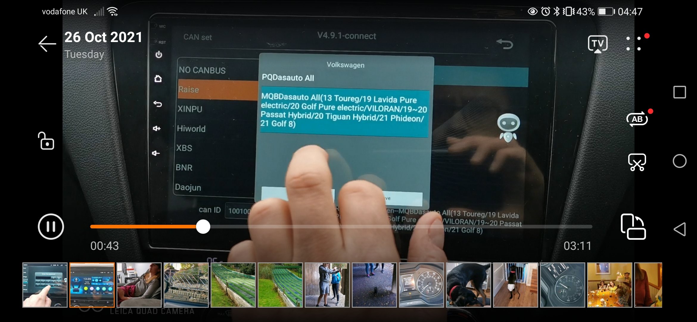

  15. Ive noticed that on the 'Raise' Canbus setting, it gives you the lines and the curve. As mentioned before, the RZC one isn't there. Ebilaen are saying to use Raise but I only get the following options. (Excuse the fingers)
  16. So, jumped into the car this morning to sort this, and I don't have RCZ option, only Raise which is the one that is on however paying more attention to it, it is for a Tiguan Hybrid. Going to drop them a message on Ali Express see what they say.
  17. Yeah, I think possibly I've selected the wrong canbus setting. They told me to use RZC or raise option??? I've lost my locking beeps and don't know how to get it back up lol. Was it the Agama launcher you were using. I've got that just now and seems OK tbh.

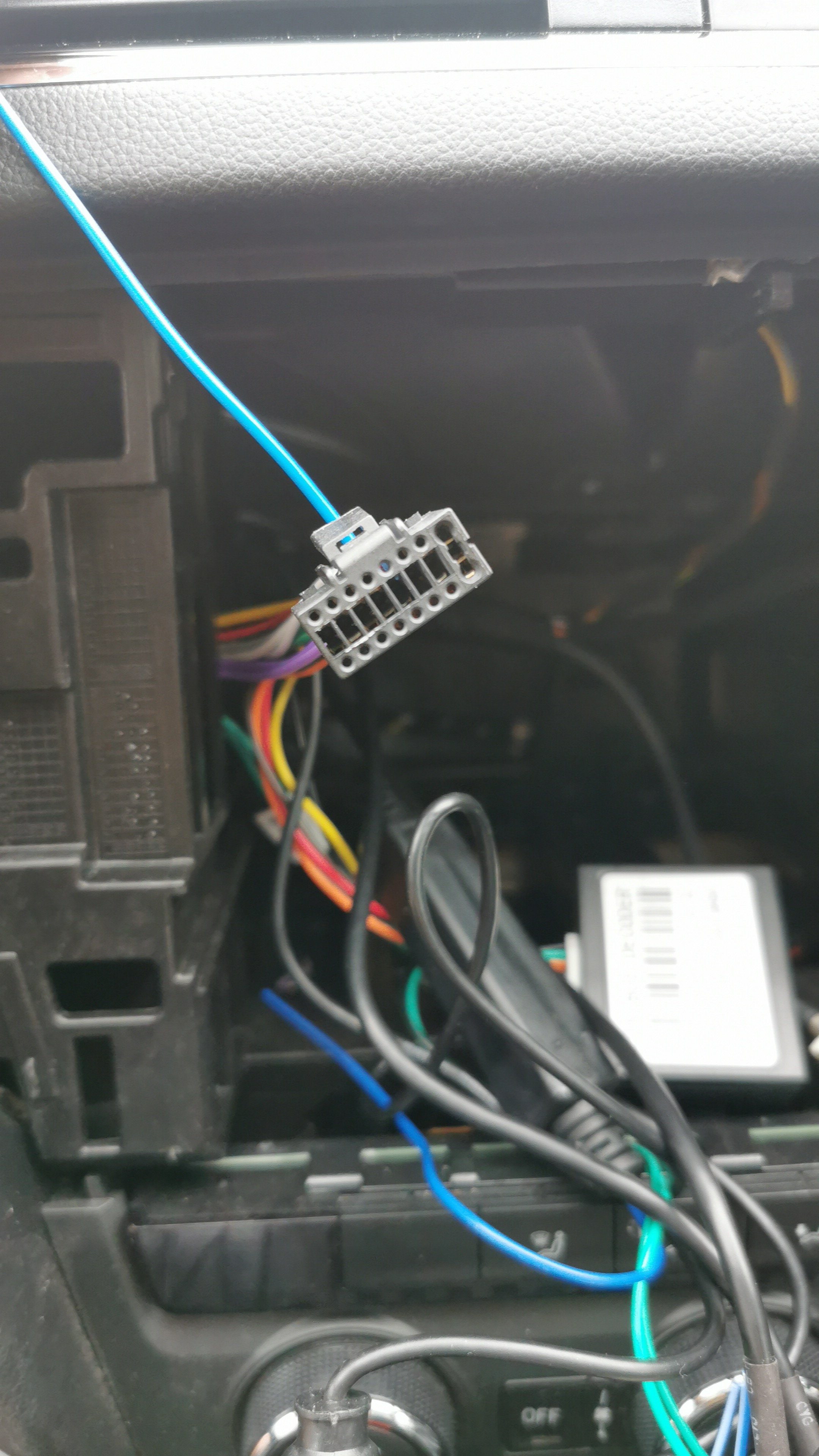

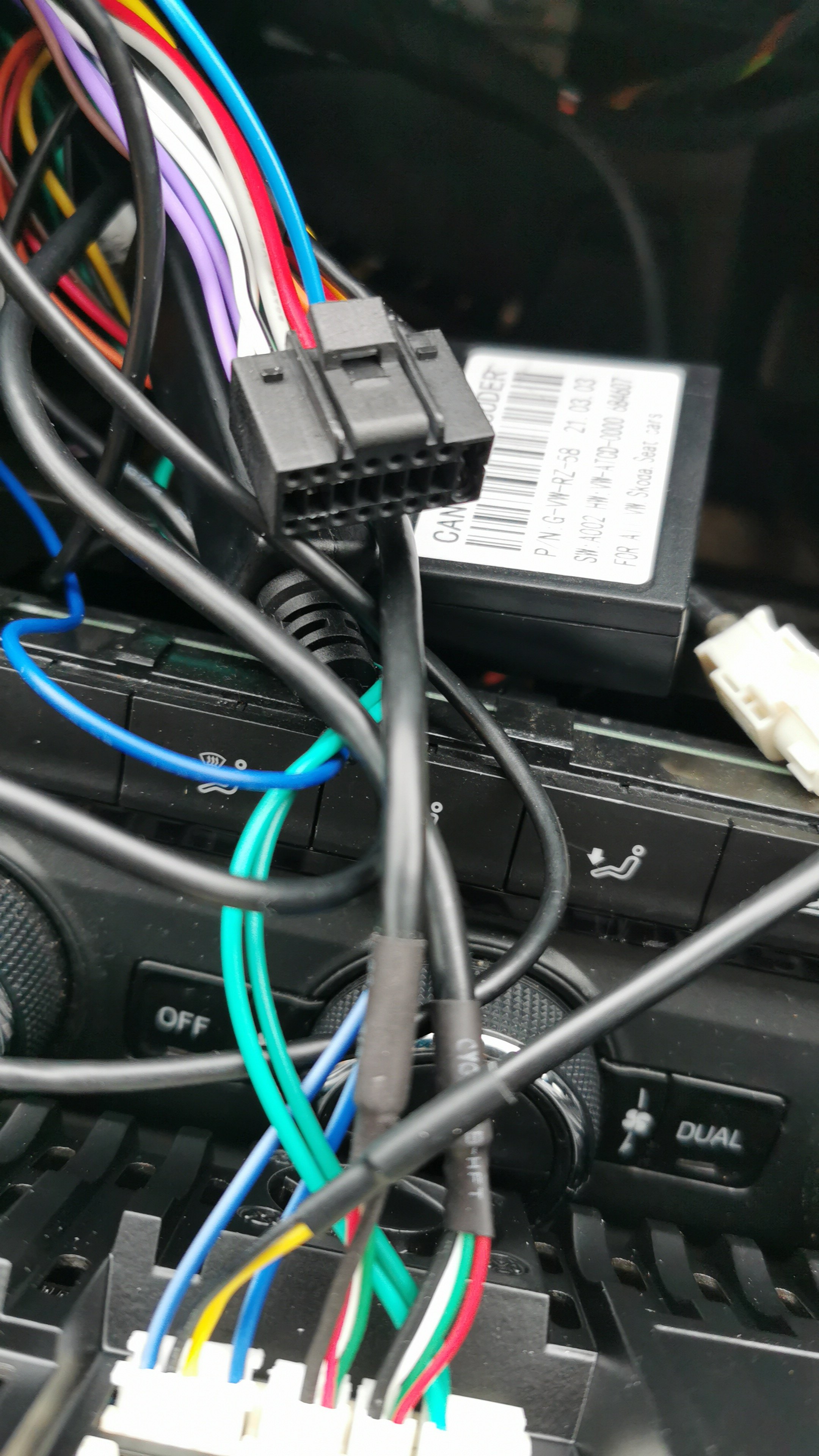

  21. Hopefully it's fine, the lowere part of the glove box was off, that was the surround where the cd player sits, didn't want to go disconnecting the airbag buttong and stuff. I can't seem to see any other way of feeding the loom through, it's tight to the right hand column, no more to play with. Had thought about going back to seller, but in all honesty, I need it working for Friday as I'm taking the car to Wales. Wife has a VW Golf but my golf clubs won't fit in properly haha. I can't see how that xtron loom extension won't work tbh. Need to at least give it a go.
  22. This should do the job, shouldn't it. https://xtrons.co.uk/volkswagen-iso-extension-cable-isomqb
  23. So, tried to install mine this morning, I don't have enough give in the power cable to switch this bloody thing on. All my power was going into the cd unit in the glove box, need about an inch more to get the stereo to slide into place and actually work
