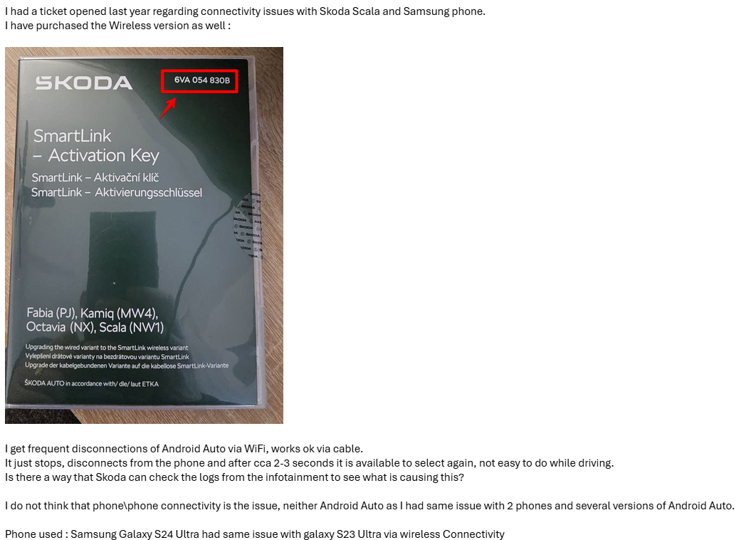

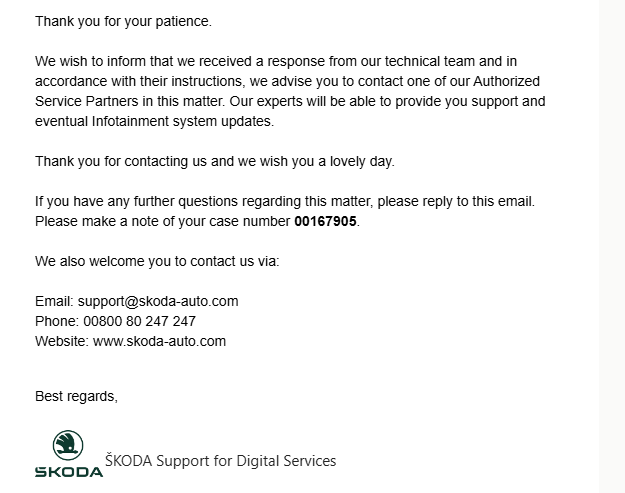

  5. Thank you for your answer, most likely a bug in Skoda software. Very hard to prove, and also for the car dealership to test\replicate. Skoda just sent me to the dealer
  6. And the answer from Skoda : Anyone facing similar issues ? Via USB cable it works flawlessly.
  7. I do not want to open a new topic as it is related. If not I will ask the moderators to notify me. I now use a S24 Ultra and same setup as before Scala+Bolero+Soft version 1800. Lately it disconnects from Wireless random. Tested with both Maps and Waze, it simply disconnects and in 3-5 seconds it can be seleted again on the car screen. Phone system and apps are up to date. Notified Skoda via email but they failed to assist :
  8. I am sorry for your experience, I opened the ticket to Skoda in May 2023 and followed up with them almost monthly, first they said it will be done by the end of summer, than autumn . In December I visited my dealer prior to notification it by email. The dealer performed free upgrade to 1800 and cable was fixed. I notified Skoda in June 2023 that Seat works wirelessly, and Skoda was wise enough to enable this with a cost . Also on one of the brochures on the dealer I saw the wireless functionality and asked for that as well, paid approx 60 EUROS and now both cable and wireless AA work.

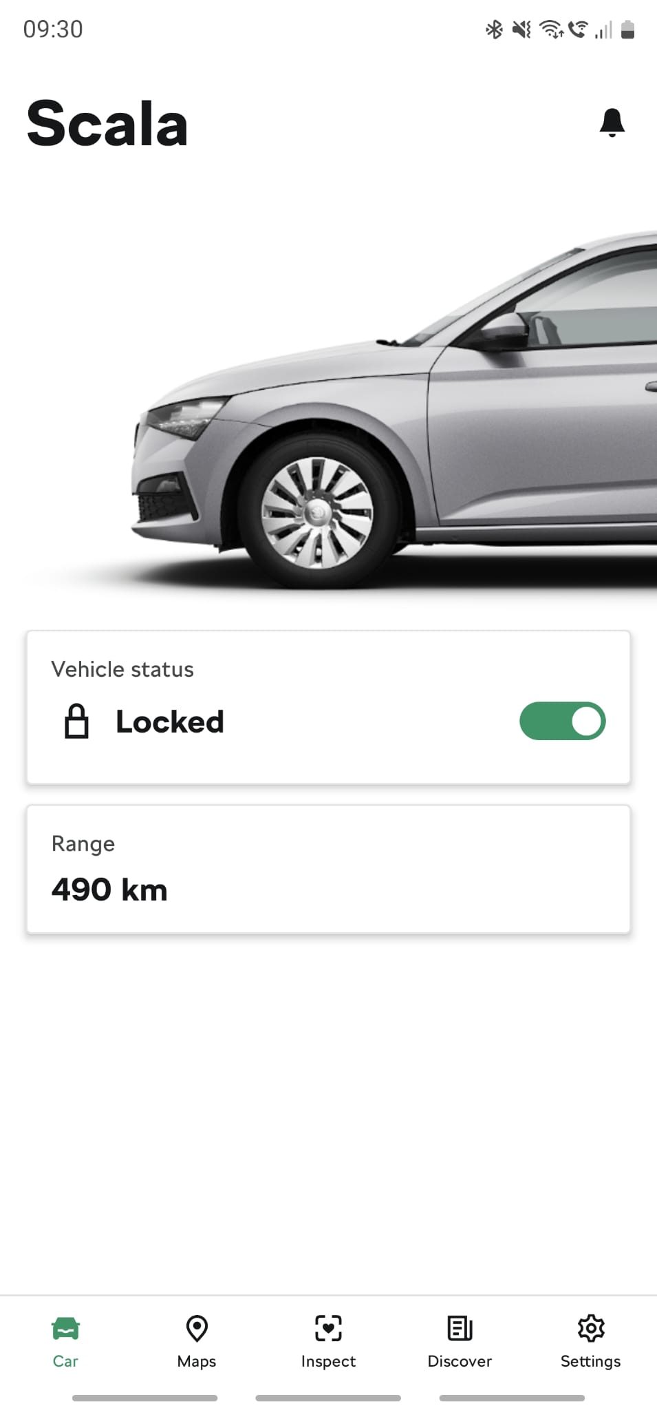

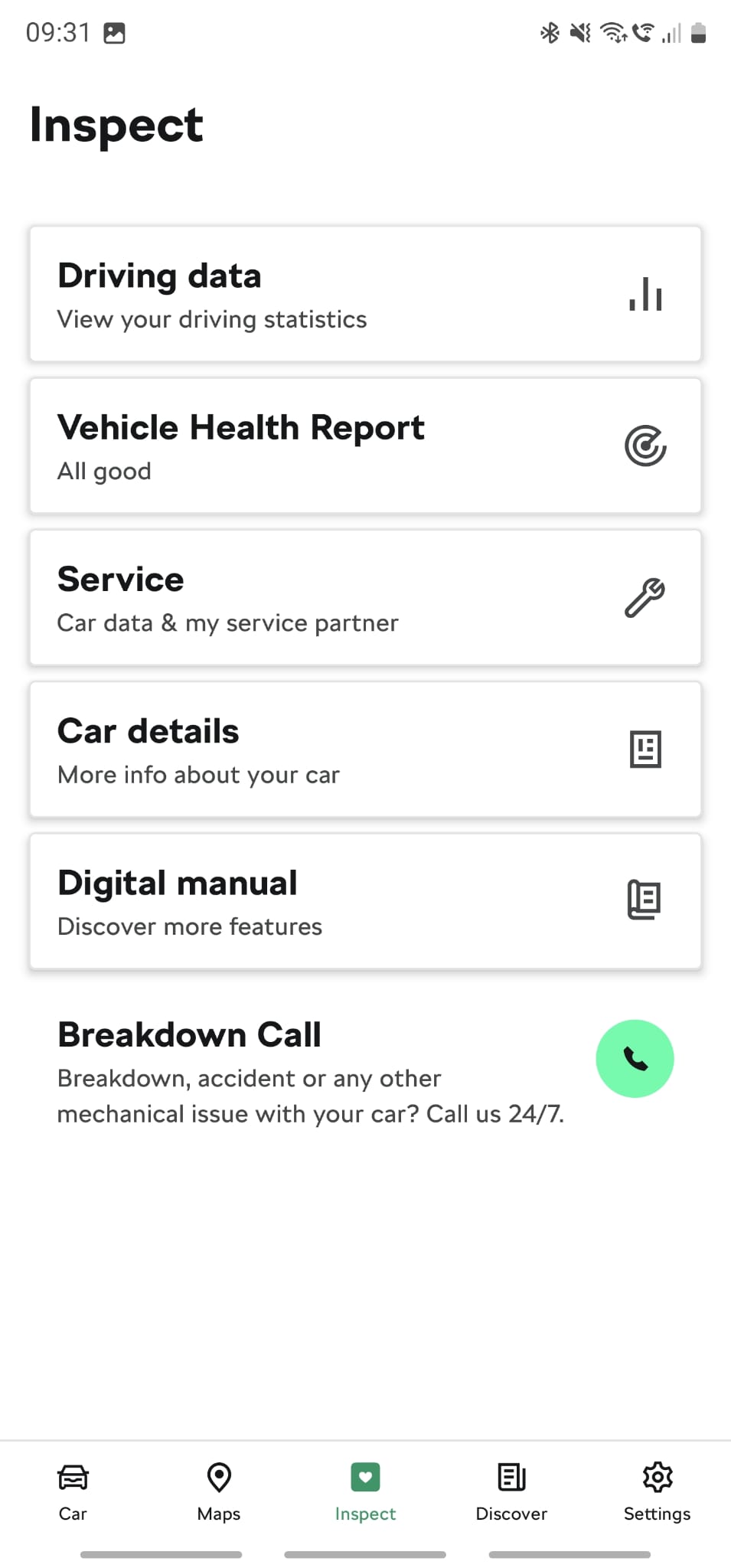

  9. I do not have the features on my Scala. Open the app and check the menu, if there it is compatible with your car if not I guess that answers it.

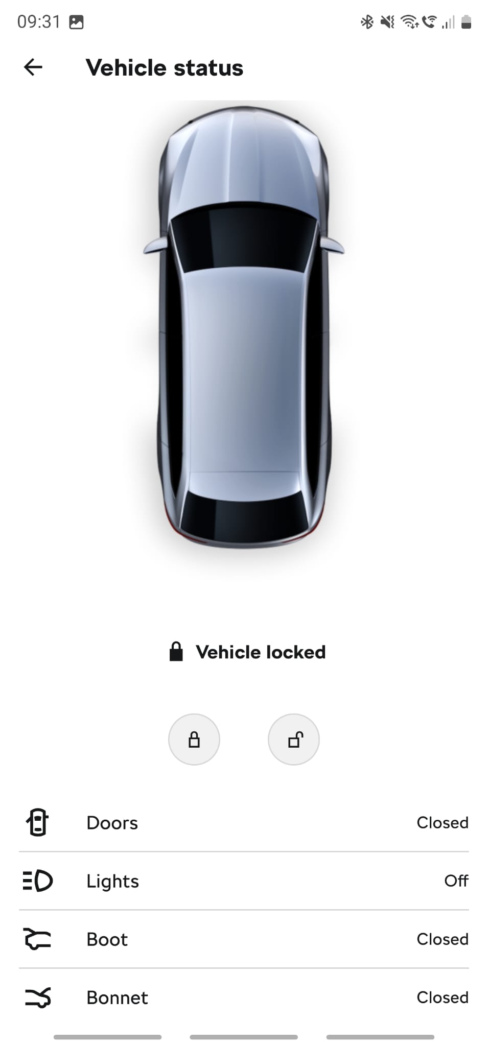

  10. Hello, As most likely you know Skoda Scala was not compatible with My Skoda app but My Skoda Essentials. We have an update and now My Skoda works as well, go check it out.
