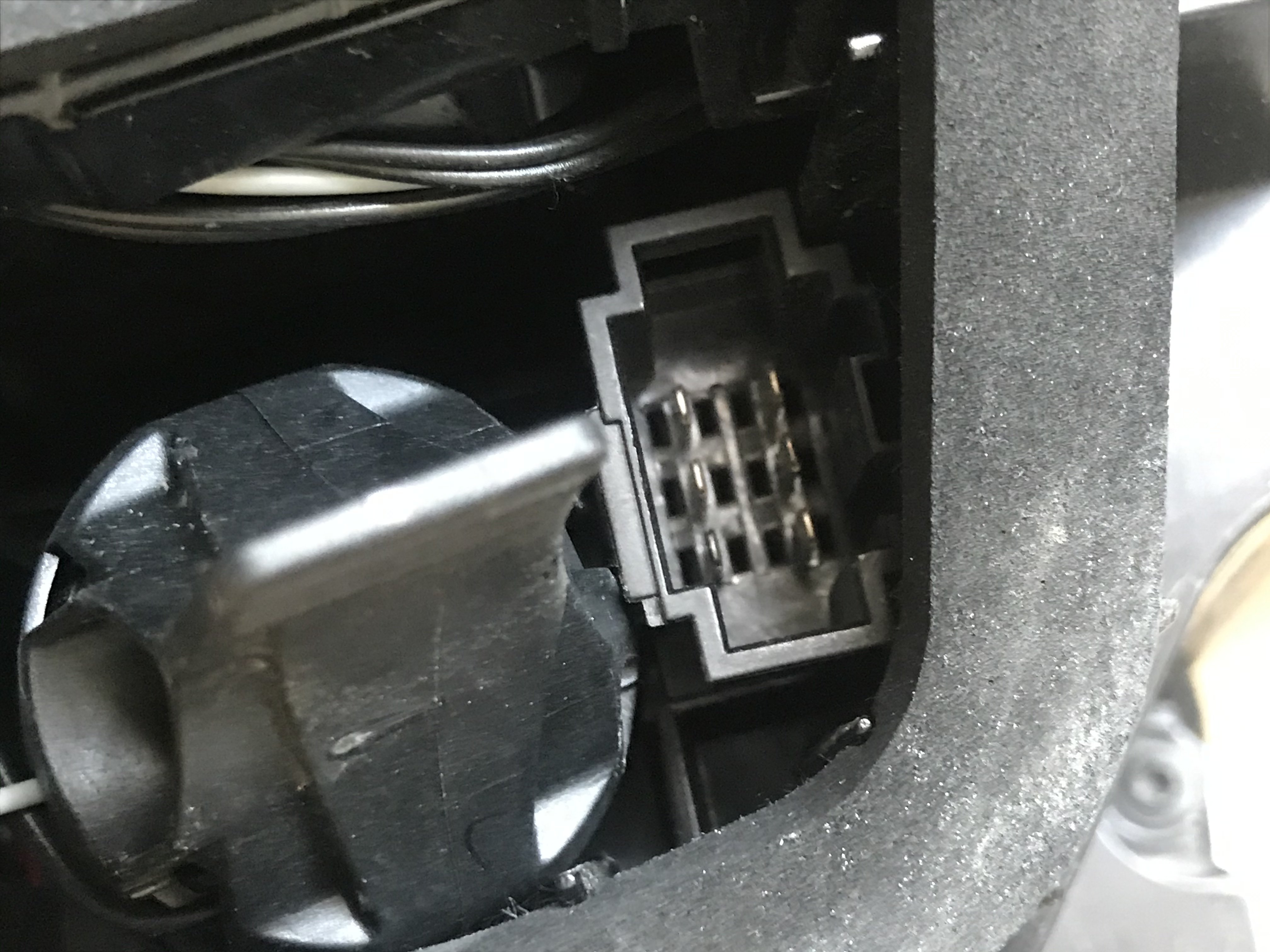

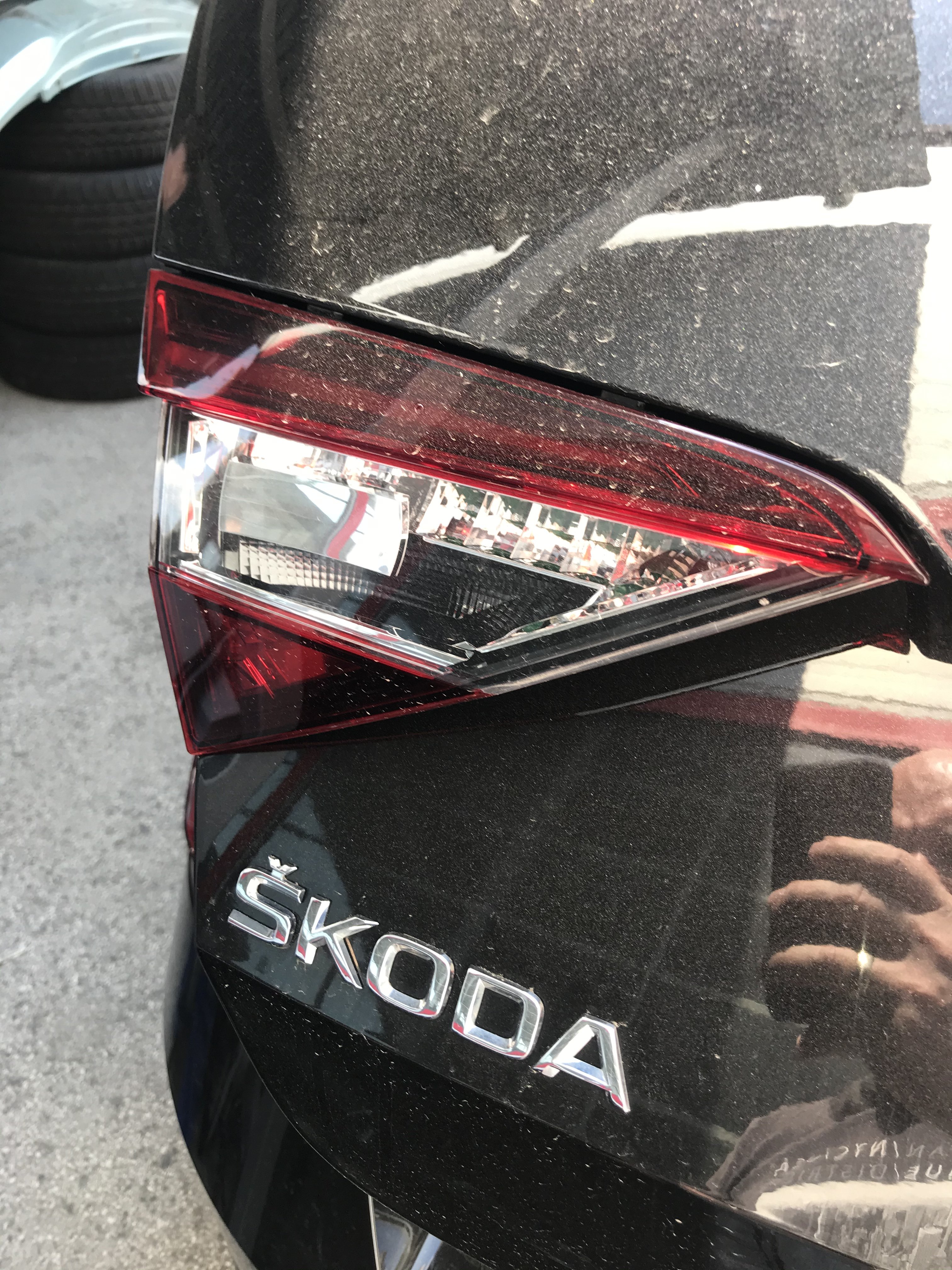

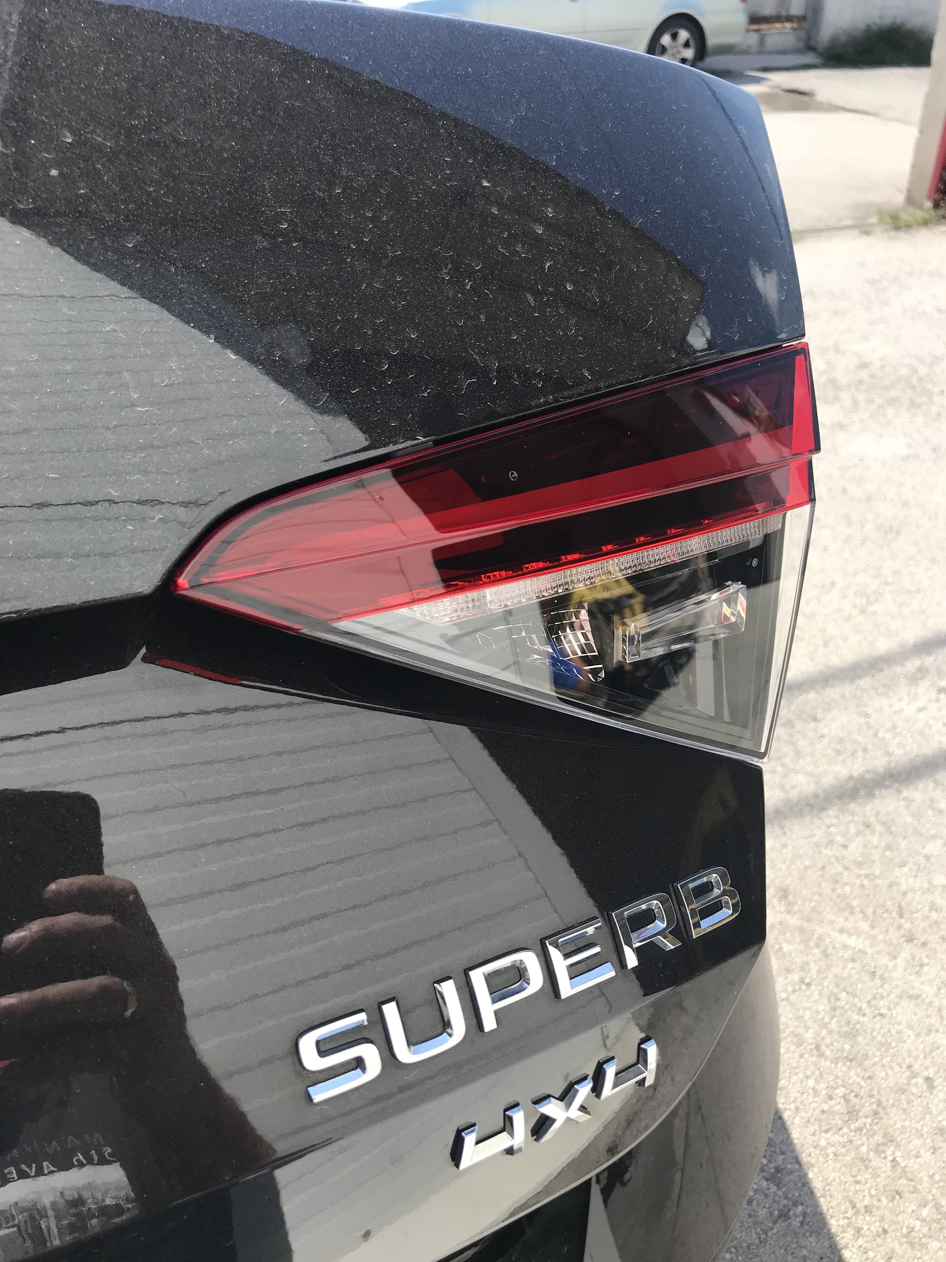

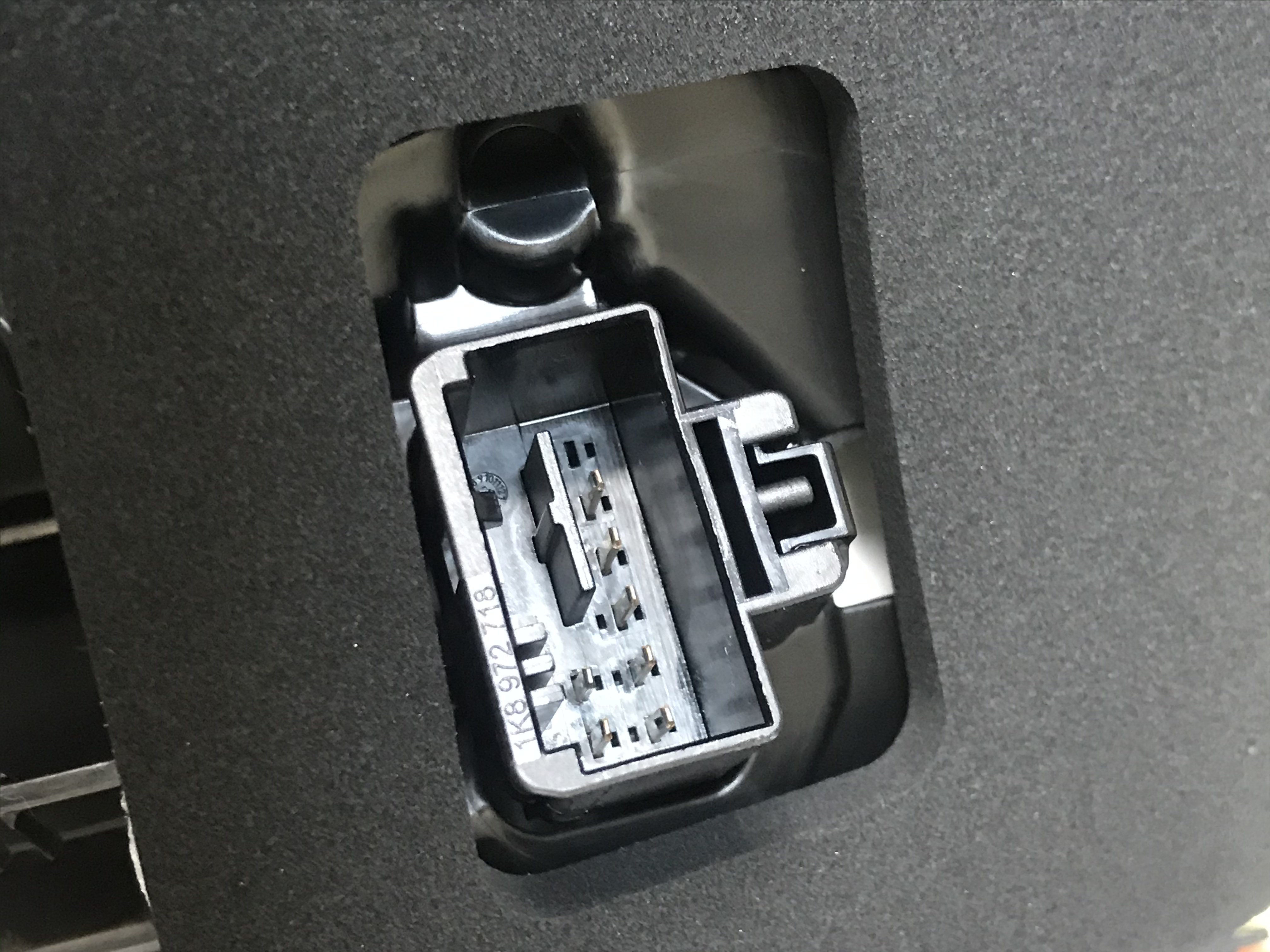

  8. Guys, all the information of the person who made the modification ( in the video) is a lie, there is nothing true with what he said and wrote as information.
  9. I received a good offer from a company whose name I will not mention, to provide them with the final result which is already nearing final completion.I have not accepted but I have not refused, I will think about it
  10. Hi I think things will get,I ordered the jacks for the facelift stops-two are offered by Skoda the other two (for the external stop) are not, but they are everywhere, so it's not a problem. You will have and adding some cable but I think everyone will cope alone,Personally, I plan to make transition cables so as not to cut the original installation, but this is everyone's choice. As soon as the jacks come and I have progress, I will release information, photos of parts and everything necessary for processing
