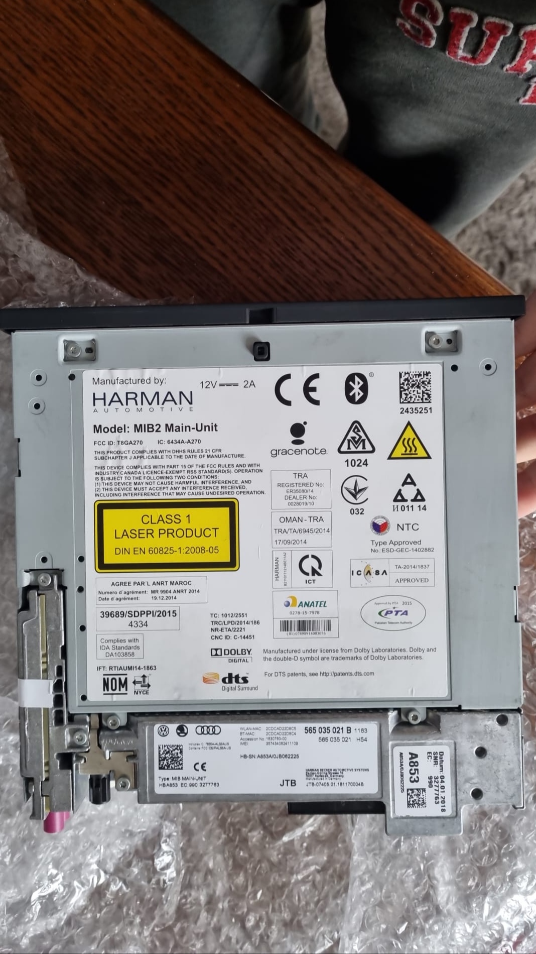

This is a 9.2" mib2.5 screen And a mib 2.5 unite for glovebox Part number 565 035 021b

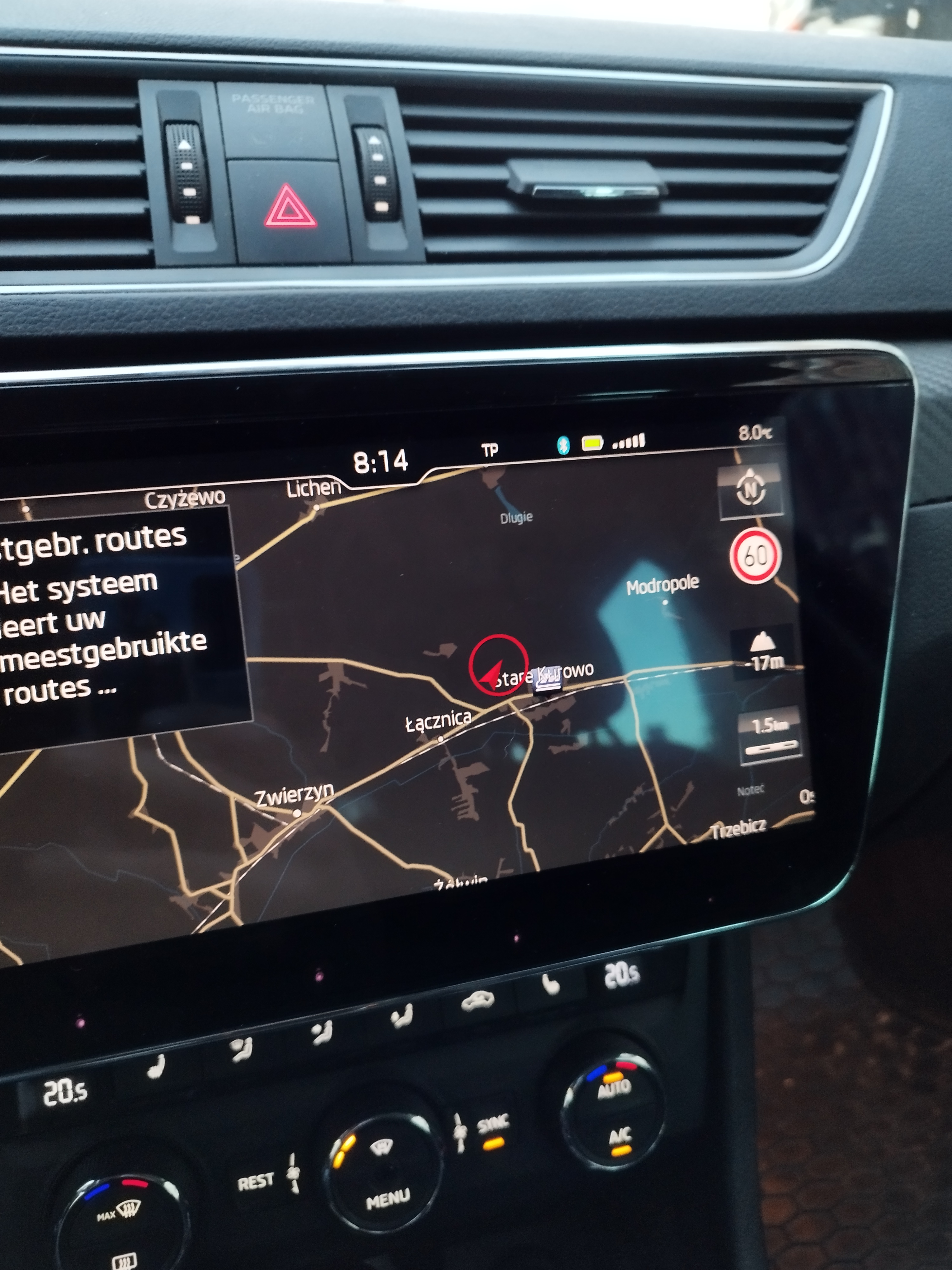

Problem solved. It was the gps antenne plug- Mib 2.5 retrofit
Today i retrofit a mib 2.5 in my superb 2016. Everything works only the navi is not working it is stuck in poland and i am in belgium. How do i fix this? - Mib 2.5 retrofit
