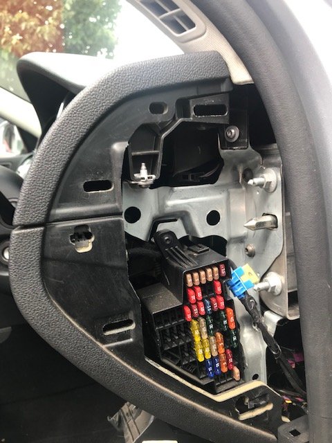

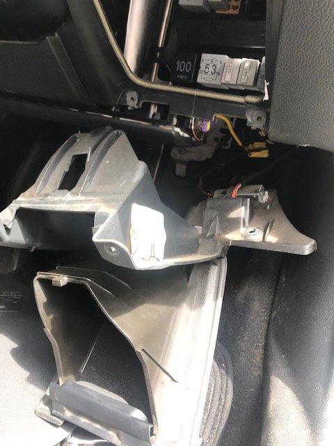

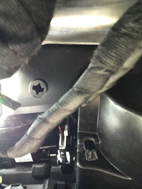

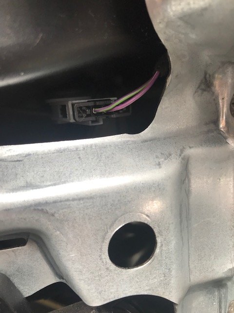

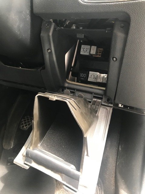

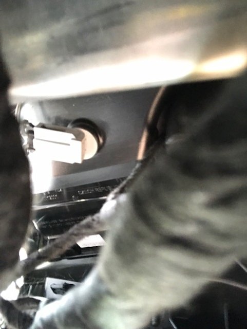

The replacement sensor arrived today. Don't know if it's worked yet because it's too warm to check. Anyway, a few photos on where the sensor is and how to access it. If you remove the fusebox cover from the drivers side, you can see the sensor tucked away in the dark space above the silver bracket. Photo of general area and close-up here: To get access to the area, open the cubby-hole by the driver's right knee. Using a screwdriver gently lever it so that it opens out completely. This gives you access to 4 torx screws that need to be undone to remove the whole assembly. There is one larger torx screw underneath the dash (not pictured) that also needs to be removed. It's pretty obvious which one, once you've undone the other four. Now you can look up and see the sensor. Simply turn it 90 degrees and it will drop out. Disconnect the connector, put the new one on, and replace it. Refitting is a reversal of dismantling. Next picture is of the cross-shaped hole where the sensor would sit. Photo after is the sensor in position. I really hope this works...
