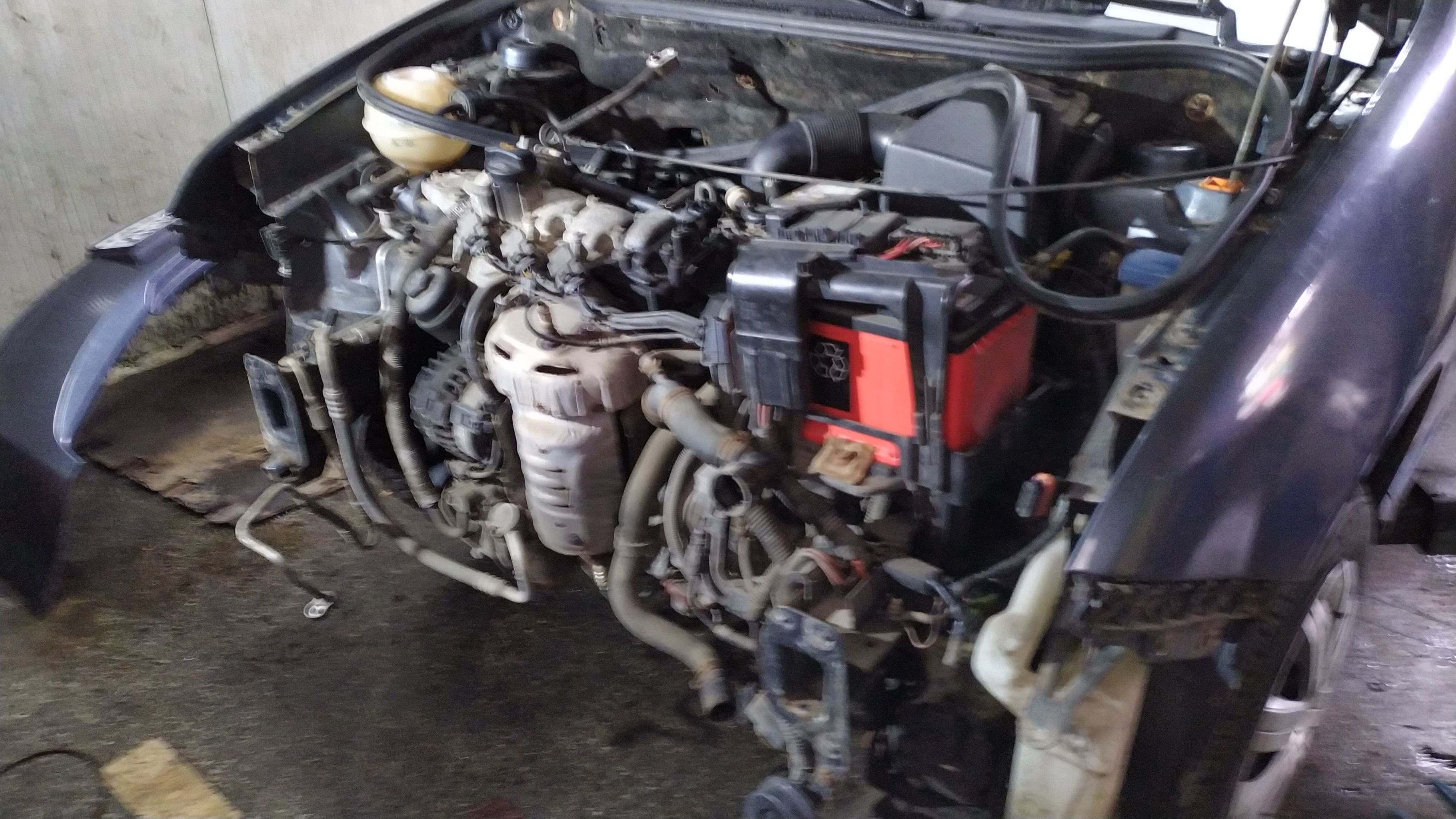

  2. I'm back with a late update on the issue presented initially in the thread. After further investigating the issue and after finding a small coolant puddle underneath the car, it seemed that the engine radiator was actually punctured. I managed to replace both the heater and the engine radiator but I have to admit, I felt I was in way over my head when I saw the hole front of the car disassembled (sorry for the blurred picture). It took me around 10 hours during the week-end to have everything done and that's without the time spent researching and getting the right tools for the task. I did had some issues with the radiator support as it was previously smashed in an accident and I had to play around with the parts fitment so it's somewhat decent. After a few km everything seems to be in order and I noticed no leaks so far.

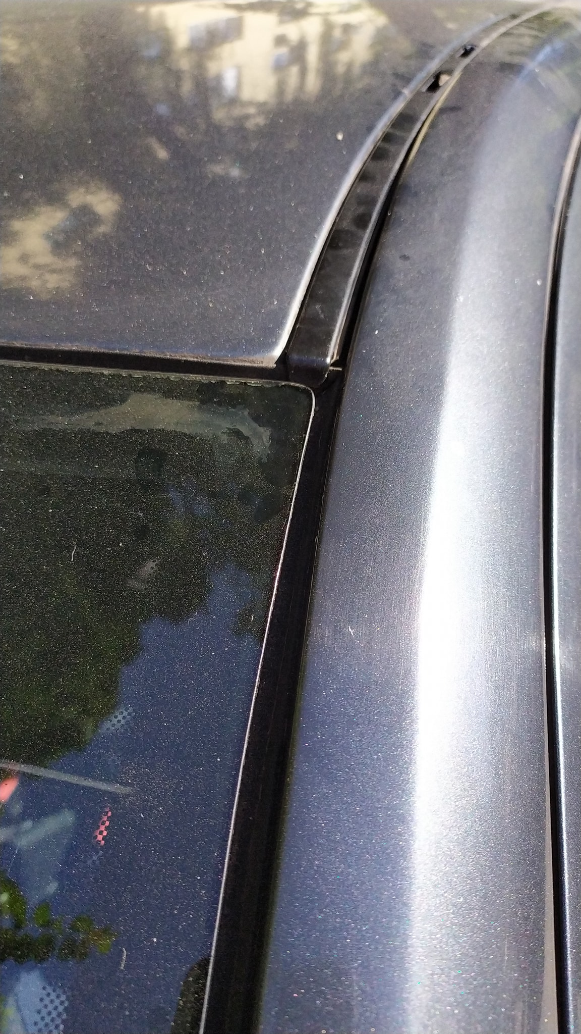

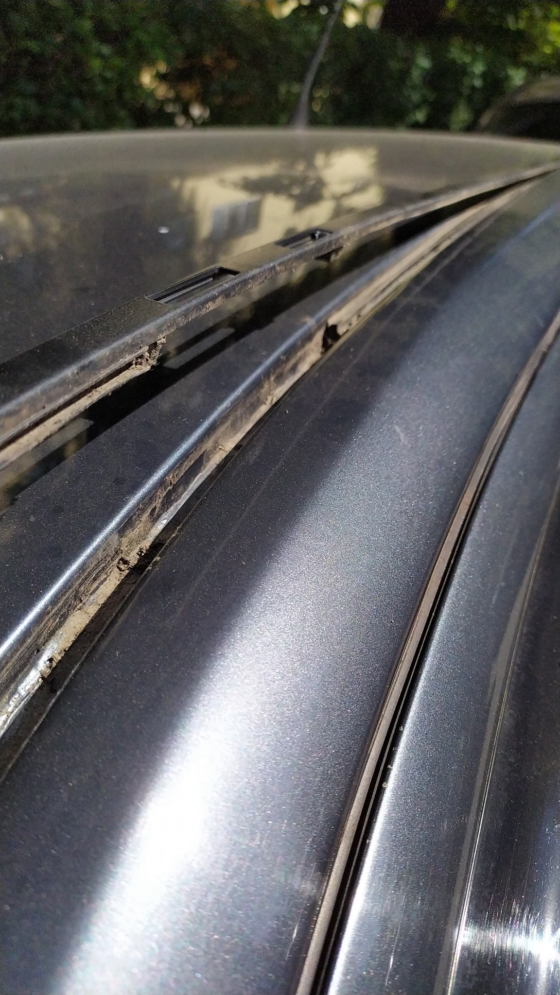

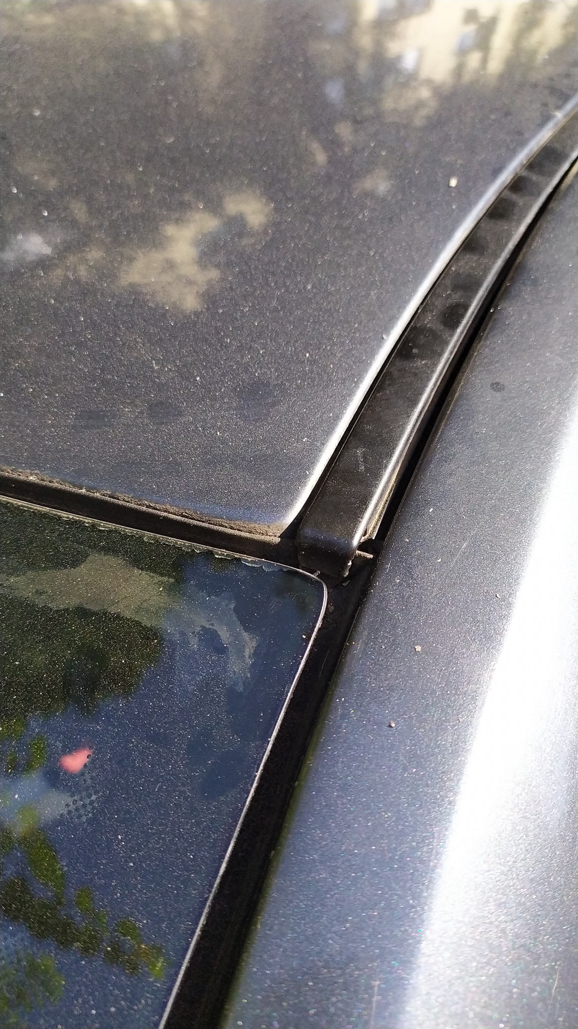

  8. Hi guys, So my front windshield cracked a while back but it's also leaking around the top edges getting the headliner next to the pillars wet so I decided to get it replaced. The issue I'm having is determining if the previous window was the correct model and if it indeed was installed correctly as on some Fabia's I've seen around my neighborhood the glass almost reaches the side exterior pillars but on mine it's not and there is a rubber sealer all around the edges of the windshield that got filled with dirt. Also the top plastic ornaments don't seem to fit really well and I'm really surprised they didn't flew away already. I'm trying to figure out if I need to buy anything before I go to replace the windshield.
