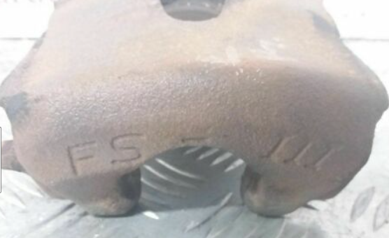

Front discs may be 239mm or 256mm, measure the disc or look for FSIII in big letters on the outside face of the caliper (256mm if you see this)
Parts for 239mm variant here: floating caliper brake; brake caliper housing; bra... - Fabia(FAB) [EUROPA 2007 year] (7zap.com)
Or 256/FSIII here floating caliper brake; brake caliper housing; bra... - Fabia(FAB) [EUROPA 2007 year] (7zap.com)
